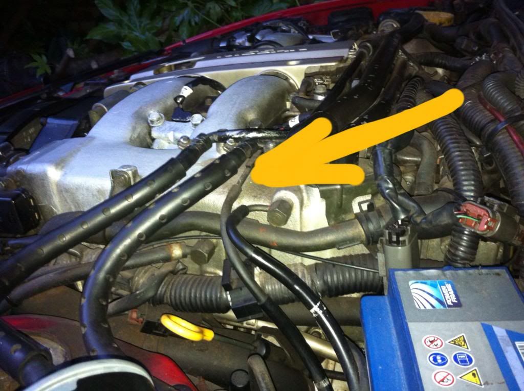

I had a similar issue when I bought mine. It had a cutting out problem that turned out to be a faulty Mass Air Flow meter. During me mauling about under the bonnet, on the passenger side/plenum/battery area I too found a 'mystery pipe' that had come away from something and disappeared into the wheel arch somewhere at the other end. Took me about 2 days to eventually find where it had come off. Have a look at this pic, the orange arrow is pointing to where it fits/came away......hope this might help
Steve J
image_zps4fd0be63.jpg~original

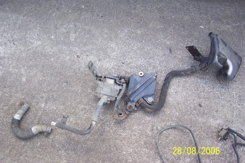

Here is a link to the AIV delete, which will show you what is under the arch liners on both sides.
http://www.300zx.co.uk/forums/showthread.php?99851-Full-AIV-Removal-For-JapSpec-Non-Turbos-by-DJ_Party_Favor

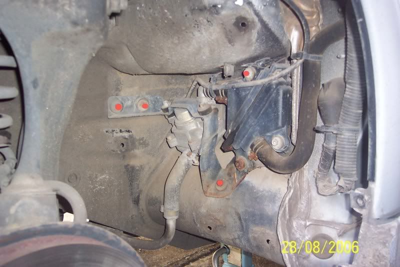

Passenger side AIV
Drivers arch liner removes to see AIV
If you were checking the gearbox level , then you have an autobox, which would have had the oil refilled via the dipstick tube, so if there is a hose off, it could be a vac pipe, possibly from the AIV solenoid.
Would be easier for us to diagnose with pics lol, but hopefully print off some of the pics in the link and it may help your garage.
If the hose is off near the battery it could be the pvr solenoid pipe, located on the plenum bracket, which then runs to the carbon canister under the front bumper, so if the hose is off the plenum as in Steves pic, it will aslo affect the running of the engine due to a vac leak.

Think it's the passenger side AIV as shown in Groover's first photo. Where does the other end of this hose go? Is it connected to anything or is it left open to air? And where should it be routed under normal operation? Thanks a lot :)
Do you still have your cats? if you have no cats, then the Aiv system is not required and often the AIV tubes are left open, although the vac pipe on the AIV solenoid needs capping to prevent unnecessary vac leaks.
Which hose are you talking about, vac hose or the larger metal tube?
Hi Groover - car is exactly as it was built, I've never had anything done to it. The hose it looks like is the big (non ridged) black rubber one in your Passenger Side AIV photo above
