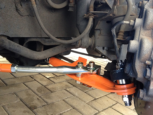

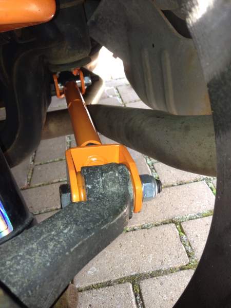

Meister R also sell the front tension rods and adjustable f/r arms, speak to Jerrick.

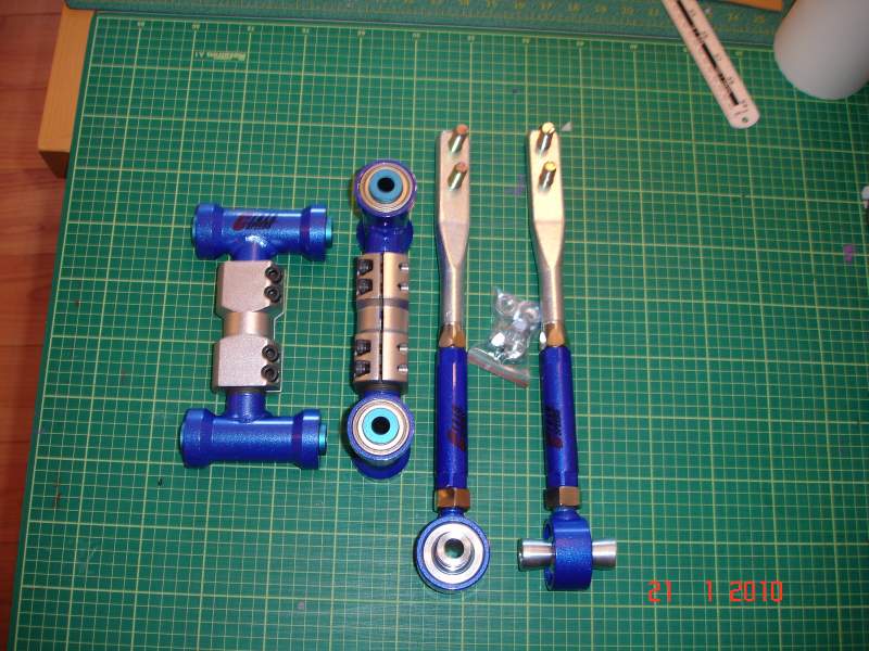

Good to see someone post pics of the full kit, what did you have before? Are you happy with the performance and quality?
It was all stock before and I gradually upgraded bits and bobs but then the rear ball joints leaked
which I then decided to replace the bottom parts with the drift works stuff too.
Its now a great ride and much more responsive than it was stock; of course the Meisters help loads too.
one thing with this setup is everything's adjustable so no need for spaces if you want a better profile look.

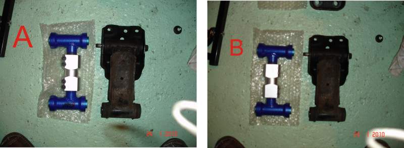

I can vouch for the quality of the Meister-R arms etc. It was one of the first things that I upgrade o my car when I bought it along with the shocks/springs.
Some pictures for you
