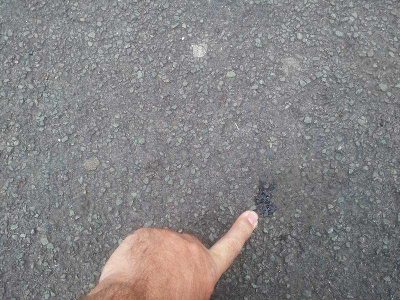

Just moved the car from where it has been standing outside the house since I returned frm the show yesterday
One tiny spot of wet oil on the tarmac, but I couldn't say for definite it cam from my car. If it did come from mine the (having marked a couple sratches on the curb and moved the car again) it's come from somewhere towards the rear of the engine, nearside. Imagine a direct line down to the road within 4-6 inches of where the nearside windscreen wash jet is on the bonnet, if you get the idea

have the car running parked on the one spot for a wee while, see if any oil leaks out

Now I'll go and put a sheet of cardboard underneath and run it for a little while.....

Ran it for five mins on a dry section of road but could not see any evidence of oil leaks, so if there is one it's very small

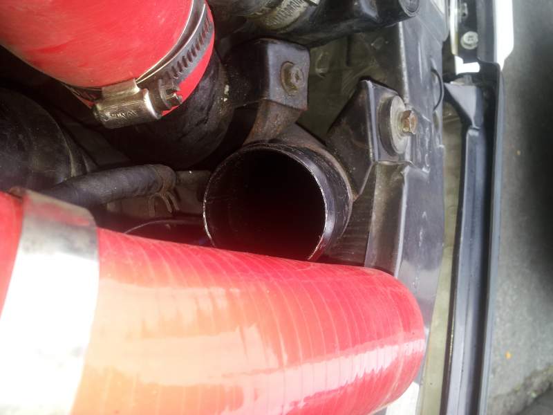

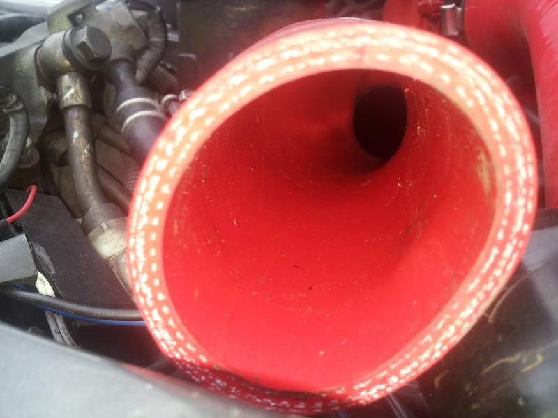

OK some more info and at last something different to report.
Now I did actually know in the back of my mind that the tubs feed the opposite side bank of cylinders so why I originally looked down the wrong ones I don't know.
Having removed the offside intercooler hose there is hardly any difference to the nearside one - OK maybe a touch more black in the photo but nothing to write home about

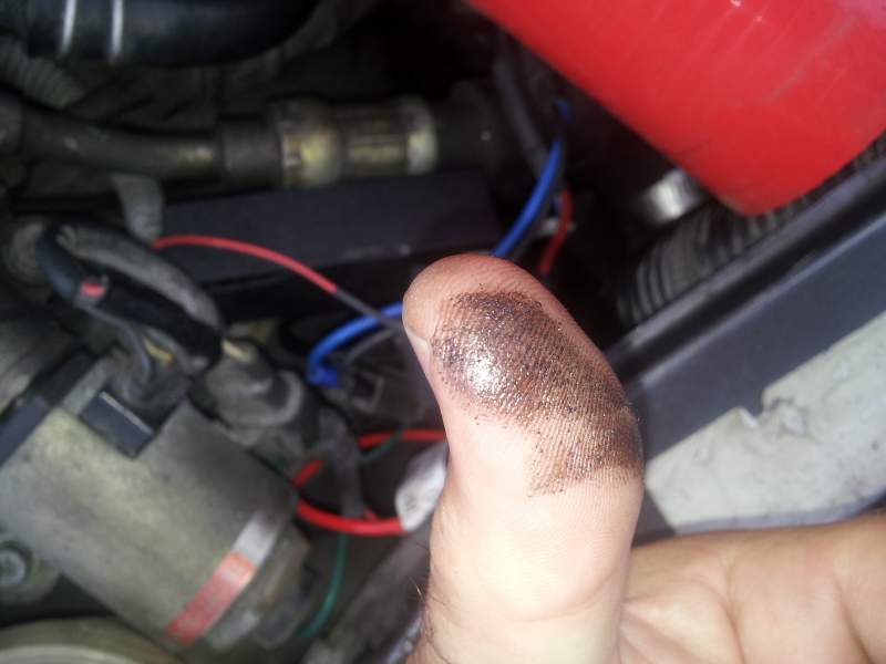

But looking down the metal pipe that feeds from the turbo towards the intercooler I can see it looks blackish and a bit 'shiny'. I took a photo but it is a bit dark to see down there however you can see the 'glistening deposit' I think on the edge, but sticking a thumb down there got me a nice sticky oily feeling brown/black thumb which shows up great in the next pic!
I then went to the same intercooler pipe on the nearside and took that off. Though there is a little bit of deposit rubbed off when putting a thumb down there, that one it feeels dry

thats an average aount of residue mate, if it was ablown turbo, the amount of oil in the pipes would be very noticeable
Damn... and I thought I had found something :blink:
The other side pipe (non smoking bank) is dry though and this is wet, does that say anything?
sorry mate, the turbo may have a slight leak, but its def not blown.
Ive actually had to pour the oil out of an intercooler after running with ablown turbo

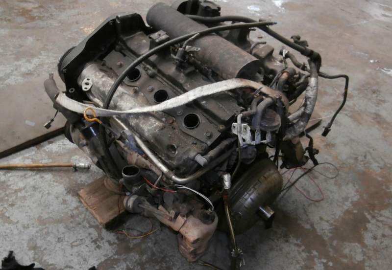

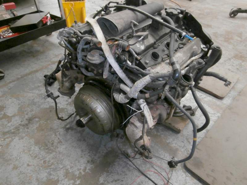

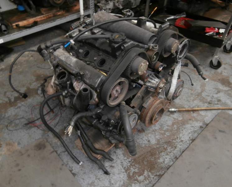

This is the condition the engine arrived at our workshop in:
If nothing was amiss why would it need checking over? as you would warranty it of course.
Jeff TT
What on Earth?
The engine was NEVER in that state when it was removed. Where's the plenum? Why are all the pulleys rusty?
It should have been road-tested once fitted, so why weren't the issues discovered before he got the car back?
Something very odd is going on here.

What on Earth?
That is how the engine arrived at our workshop, the plenum had been removed prior to then to be powder coated, the bottom pulley was so rusty I did not use it.The smoke issue did not show itself whilst we ran it up and set it up on the ConZult, the fast idle and 2.5k rpm emissions tests was fine too, nothing odd just a mechanical mystery.
Jeff
It's also missing the cambelt covers (IIRC), the injector rails, injectors, coil packs etc. I forwarded the CAS on to Rich about a week after he bought the engine in January, so that should have been with it, too.
It was definitely not sold in that condition. The only explanation for the rust is that it has been left outside for some time.
