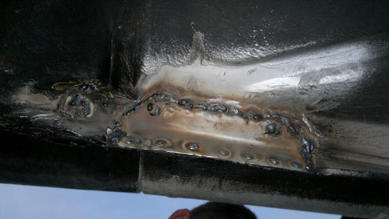

Well I cut out the front jacking point and found it was pretty rusty..... so cut out all I could, treated anything that looked slightly surface rust with Kurust, painted with zinc primer inside the sill.....

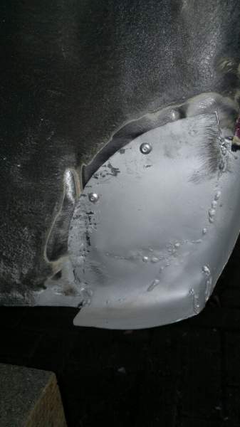

I made a plate and tried to weld it on......... Ran out of gas after a couple of tack welds.... changed gas and still no penetration....crap welds....
I checked gas and nothing coming out of the bottle.... took off the valve, re-fitted the valve and it worked... Then blew holes.... then splattery welds.....
Had cuppa and came back to try again..... 2 seam welds and it was looking good.... then splatter again.... just had a nightmare day..... so gave up....
I am going to clean the welder tonight when kids are in bed, put on new tip and clean up the trigger as it is a bit sticky....
Next thing is to grind the crap welds and redo the bits that aren't good...... I need to clean the metal again and make sure the earth clamp makes a good contact....

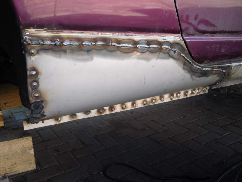

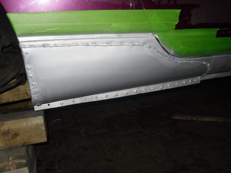

I also pop riveted the sill end panel to get a tight fit before I weld it up.... I left this after today's nightmare as I want it to look presentable.....

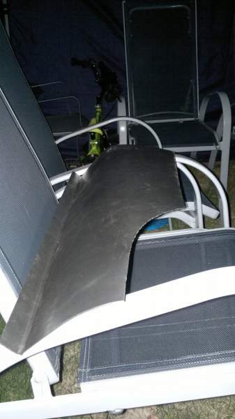

I also made the outer rear quarter panel skin..... but trying to decide whether to use a flange on the original panel so I can tack this in and have it flush when I join up or to overlap or to butt weld???????
I am leaning toward adding a flange for being easier for tacking and welding, If I tack and butt weld then I may blow holes, If I overlap without a flange it will need to be ground right back and loads of filler....
Any advice??

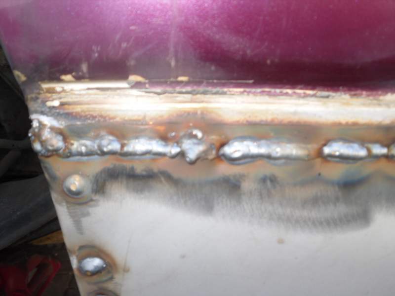

This is the panel.... cut bigger so I can choose what option to use....

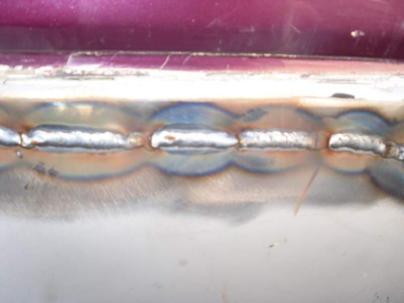

Great work so far mate, very impressive. As for which stile of weld for the rear outer sill, I would personally opt for a butted seam weld.
I would steer away from joggling the original edge as there is a possibility of distorting the line of the car.
I think that if you have a good fitting repair sill and nice and clean metal, so long as you take it one tack at a time you will not blow through.
Also, I would go with a slight gap, say 0,5mm (max) this will help with penetration and leave room for some movement.
I would also look at tidying up the original shape of the outer profile that you have cut out, that way you will find it easier to match the new panel.
Thanks again for the advice Redwine300...... I am going to lay the repair panel on and mark round it to get the size and how much to remove to get the right shape...
If I could et the edge of the original panel flanged wouldn't that give the join more strength and make it easier to get a flush finish?

I know what you mean about the overlapped joint mate. I guess it comes down to personal preference really.
Which ever you decide, just be sure that the panel is sitting in the best position and as natural and free of tension as possible.
If going with the overlapped joint, maybe you could use small self tapping screws to pull the joint together.
That way you can see how it will all line up prior to tackling the plug welds.
Yes it will leave some small holes to deal with, but as you have said, your welding skills have come on in leaps and bounds and will be easily filled.
Looking forward to the next instalment.
Would pop rivets be okay to pull panels together?

I guess pop rivets would work.
It's just they are awkward to remove and replace easily, and from experience, there will be a lot of trial fits before your are ready to weld.
Also, the holes left behind will be a lot smaller from the self tapping screws and therefore easier to fill.
I will check out my joggler in the morning and see if it can access the existing panel.
If it is any good to you, I can always post it to you on loan mate. (no rush to get it back)
Thanks for that, I shall stick to self tappers then.... Your right about test fitting.... I brought my tools to the car after a few panels and now do everything sitting next to her.... I was getting moaned at for keep walking through the house into the garden as well...lol

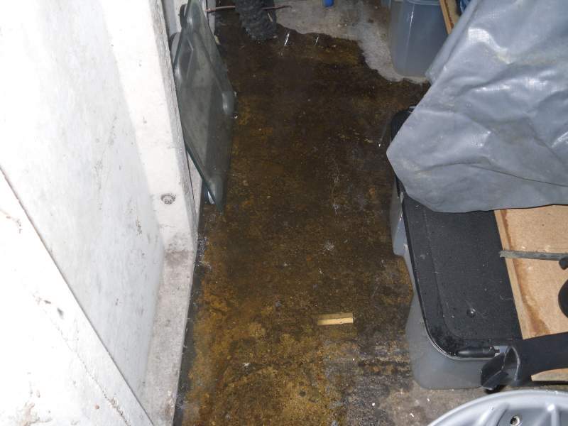

Well the flooding in my garage is now subsiding a bit..... looks like the seats might be okay..... drying out nicely....
only small puddles left.....
Well cleaning garage and tarpaulin the leaky roof took longer than thought..... I only managed to remove the headlining, rear interior panels and clean, rub down and primer the panel to close the hole in the side of the car.........

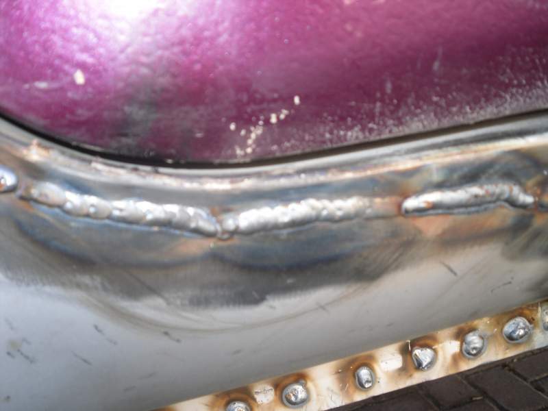

Well welding nearly done... couple of bits to tidy up and lots of grinding tomorrow, then zinc primer painted over the welds, then a bit of filler and finally painting sill, underbody and wheel arch..... YAY!!!!!
here is what I have been up to....
http://s208.photobucket.com/user/veilside01702/slideshow/27th%20August%202013%20-%20welding
this is what it looks like till I grind it down today and fold over the bottom edge to match the original panel......
Looking Good buddy, fettled and painted your hardly gonna know its been repaired, nice work and I bet you feel good coz you did it yourself too ehh

now that`s an improvement..well done that man!
cheers Santa..... Bit of a difference since you visited.....
Thats looking great, and I know exactly what you mean about being a bit sad that the weldings all done. I was the same when I did my sills and back quarters.
Feel proud thats another one saved!
Thanks for that Ossian.....
