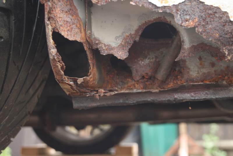

Well I went to check drivers rear sill that is hiding behind the veilside side skirts and......... it started as a small scab and grew to NO REAR SILL LEFT.....
Yep the dreaded metal worm has eaten the rear sill.... couldn't see it behind skirting....
So I now need to remove the skirt that is bonded and painted to the rest of the car........ any idea's to do this as cleanly as possible?
I was thinking stanley knife through the paint along edge of skirt and use sharp wide chisel to try to lift the skirt from the body?
I now feel sick.... thought the N/S was the worst rust, but that outer sill has been replaced before..... the O/S one hadn't....

Is it the entire rear sill, or just the outer sill? Can you post pics?
I too was tying to think of a way of removing the effected areas, with minimal damage, as mine were also blended into the bodywork and painted. In the end I just has to cut them off with an angel grinder, and worried about the atheistics later... Sadly the more I delved the more rot I found. Not what you want to hear I know!
If you're able to check the sills all the way along, underneath and from the interior, without removing the skirts, then I'd do that. Give them a damn good poking. It could just be the rear sections, they seem to be a common problem (probably because of the drains), I know many have had to do work in this area.
It sounds like you've caught early what could have turned into a nightmare, so look on the bright side.
So far, from what you've said, it sounds repairable, so I wouldn't freak out yet.

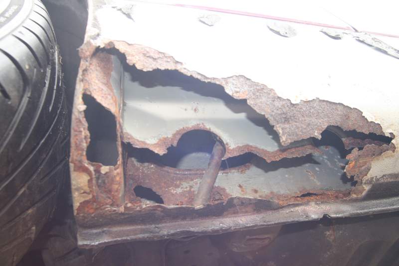

Hi, It is rusted through outer, both inner panels with holes in and the inner sill is caked in rust.... but looks bad.... the rear mounts seem very solid.... I am going to clean up tomorrow to see how bad it is with wire brush on drill....
I have some pics....lol
The hardest part was removing the bonded on skirt..... that was hard, a few small cracks occurred, but all repairable with some fibreglass and resin....
These were before I took the angle grinder to it this afternoon....lol
I marked a few lines up the outer sill and cut till I was on all good metal... About 1 inch below the swage line on the rear qtr panel.....
The pillar is rust free....
The front of the rust is where the rear quarter is welded to the front sill section....
The inner 2 panels are gone about half way up the preformed holes......
The inner sill / box section is full of rust from everywhere else, so needs some work to see just how bad it really is.....

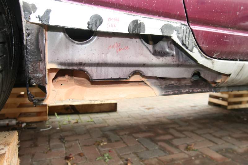

Well rain has stopped play for the moment.... But got a picture of what I have got left and the rust treatment that I have put on to try to cover up while the weather is a bit damp......
I have treated all surface rust to a wire brush down and then coated in Hammerite Kurust... I let that soak in and dry then a spray coat of Hammerite No1 rust beater....
I was thinking of using a Zinc coating as far as I could get into the sill sections that are left?
What's the best high zinc content weld through spray to use for the bits I can't get to?

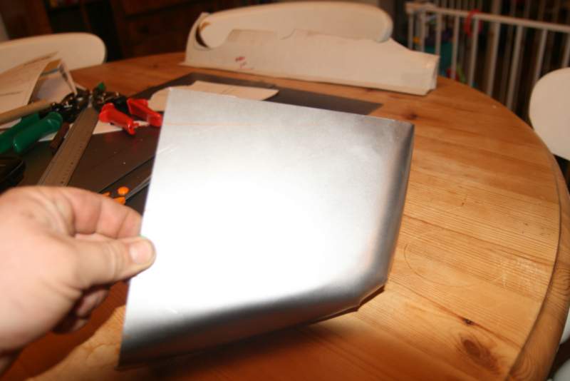

Going to have a go at fabricating first panel today.... Going to do the inner sill closing panel, flat one first....

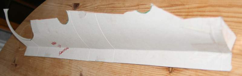

I have made a cardboard template of piece I need using redwine300's pictures to show the rough shapes I want for the hole as the big one has only top section left....
Then weather permitting grind down the last of the rust metal from bottom of inner sill where the spot welds were and clean up.....
One panel at a time so I get them right.....

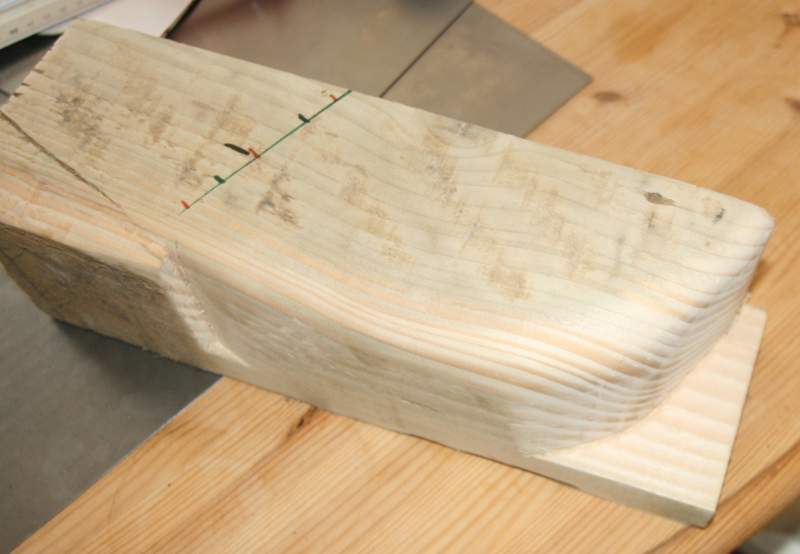

I just need a panel beaters leather sandbag now and i am going to try to fabricate the sill end piece in the wheel arch first.... that is going to be the hardest part getting the curve right.... hence the sandbag.....lol
I need one for tomorrow, so maybe making one tonight as nowhere can get me one till tuesday next week......
off to get a bag of sand in a moment.....lol

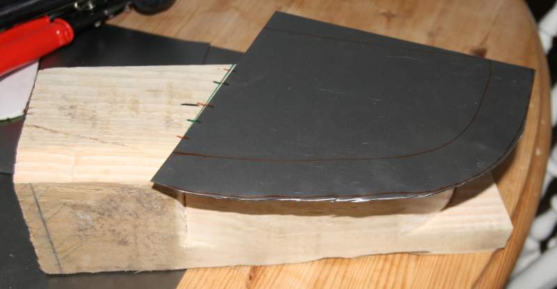

Well here is my masterpiece to make the inner bottom part of the wheel arch and sill end piece......
I looked at a sand bag to make a shaped panel the old school way, forming and cutting one and welding up the cuts, Then I finally decided to make a mould to form the sheet around out of a wooden block.....
It may work........and then again more than likely won't......lol
But here it is......
And then I made the centre panel replacement section in lovely 3D.......lol

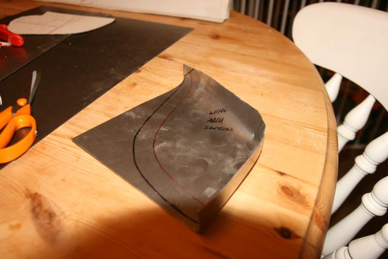

well had a go at the wheel arch piece and came up with this after about 20 minutes work.....
very nice job on the panel, but if you want really good lines you should buy a shrinker/stretcher.
