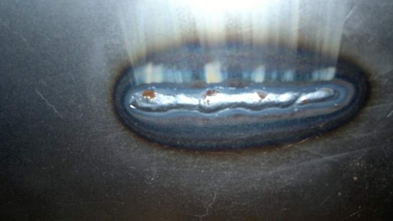

Well had a few issues with welder, namely finding out the regulator is leaking badly..... Replaced it with clarke one temporarily.... but has no flow gauge...
This is my first attempt setting up power and wire speed.....2013-06-27-201.jpg

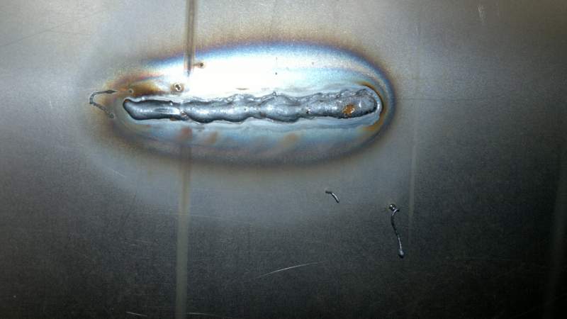

This is my 2nd attempt that seems okay.... but going to have another practice tonight....2013-06-27-202.jpg
Second picture is not bad at all for a first attempt.
Mind you, I would need to see the opposite side so as to see the level of penetration.
Ideally, the back should look the same as the front.
How thick is the plate? The reason I ask is that it would be worth using a 1.5mm to 2.0mm thickness just to get the hang of things.
That way you will not have to worry about blowing through so often. Once you have then developed your technique, you can the look at thinner material.

This is 0.9mm.....

Those vapour trails are from impurities, nothing to owrry about too much really for what your doing. it also look like your holding the torch at 90 degrees to the surface your welding, angle it over to 45 and you will find it easier to see what your doing and the gas will cover the weld better. definite improvements though.
turn the power down a smidge and move a tad faster would have things looking alot better

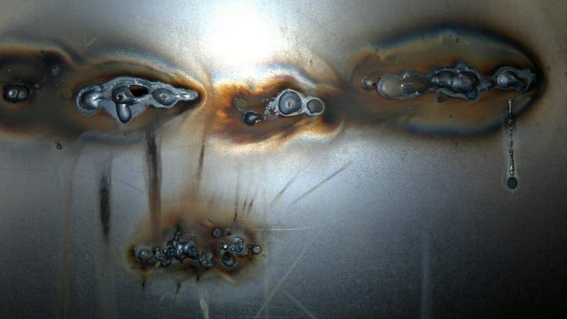

I have tried different settings tonight and blew holes a lot......lol
There is a switch for high or low power setting only..... So tried high and that is when the piece turned to swiss cheese....lol
Put it back to low setting and wire feed at about 1/2 to 2/3 seems useable for me.....
I tried the 45 degree angle and it worked nicely.....
I am going to put some stickers on settings so I don't forget and can mark what works..... thanks for the tip....

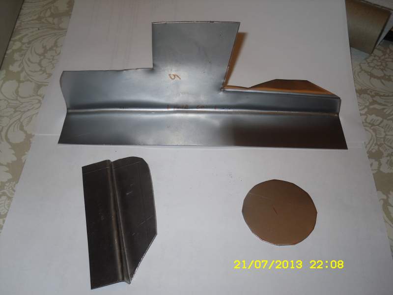

I wish there had been.... I have made a small section to replace the front floor corner and will post a pic in the next few days....

Well got the front corner for the floorpan repair made, the patch to replace the floor bung and the front sill section roughly made, but can't finish till I grind the jacking point out and see what is left
