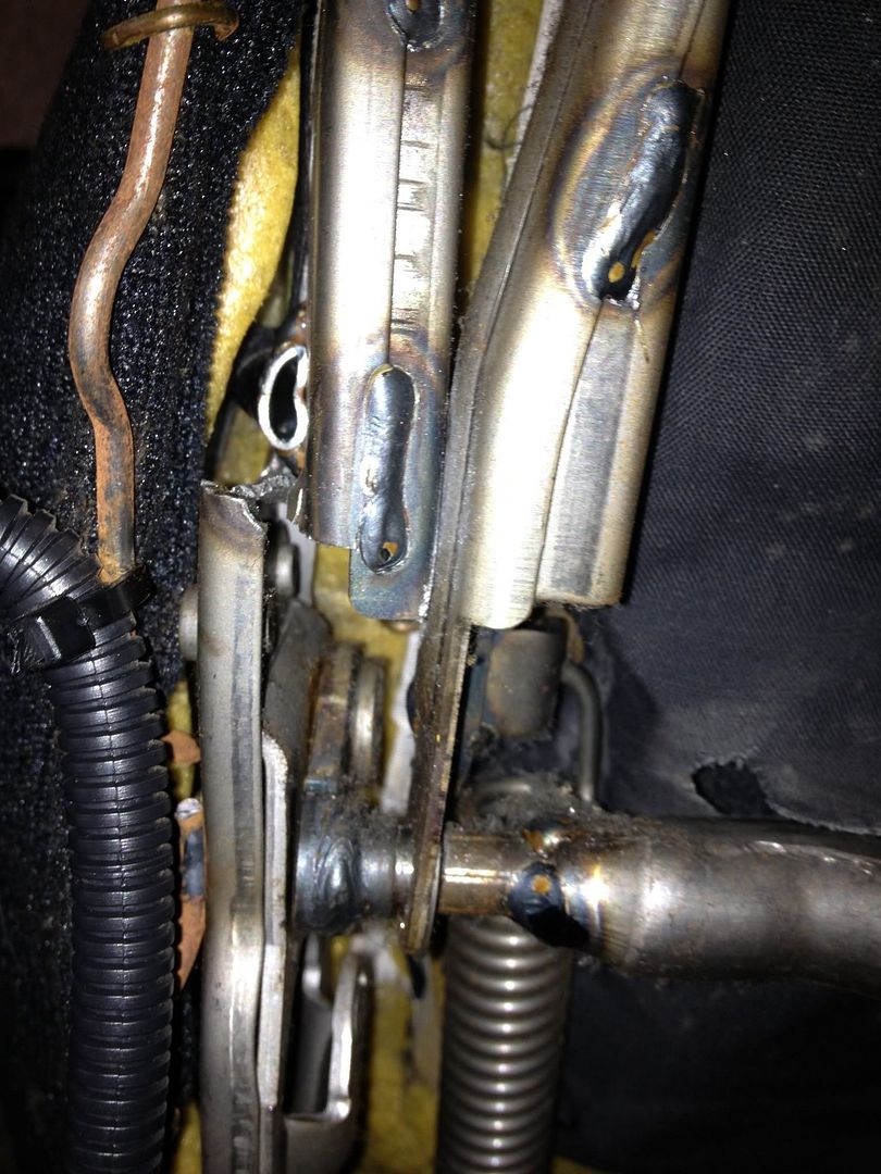

How is the floor? Check the subframe bolting positions for corrosion, it's quite easy to take the back off of the base, to see if anything has failed, sometimes also the mounting bracket for the subframe can snap near the bolts and cause the subframe to drop, I had that problem on one of my subframes.
I had the same thing with a UK cloth drivers seat, swapped it out in the end, but i noticed today on mine when it was having a hoover that the bolt on the side left of the seat was loose, there is a bolt each side actually on the bottom of the upper part of the seat. The inner frame of the back part may be weak or cracked causing it to move. I will take a closer look tommorrow and see if i can take some pics too.
Its scrap mate, there is no way id ever get that completely straight again
I think this sort of thing happens over time, considering how awkward it can be getting out of the zed, a lot of people me included use the backs to push them selves out of the car.
