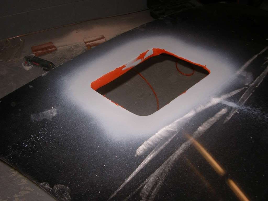

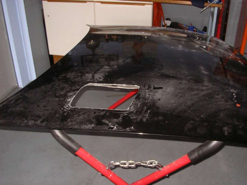

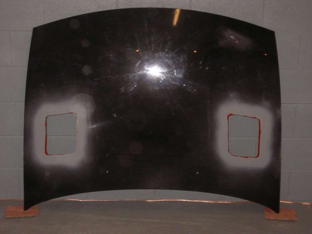

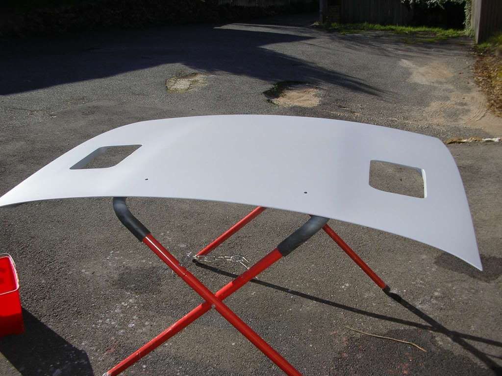

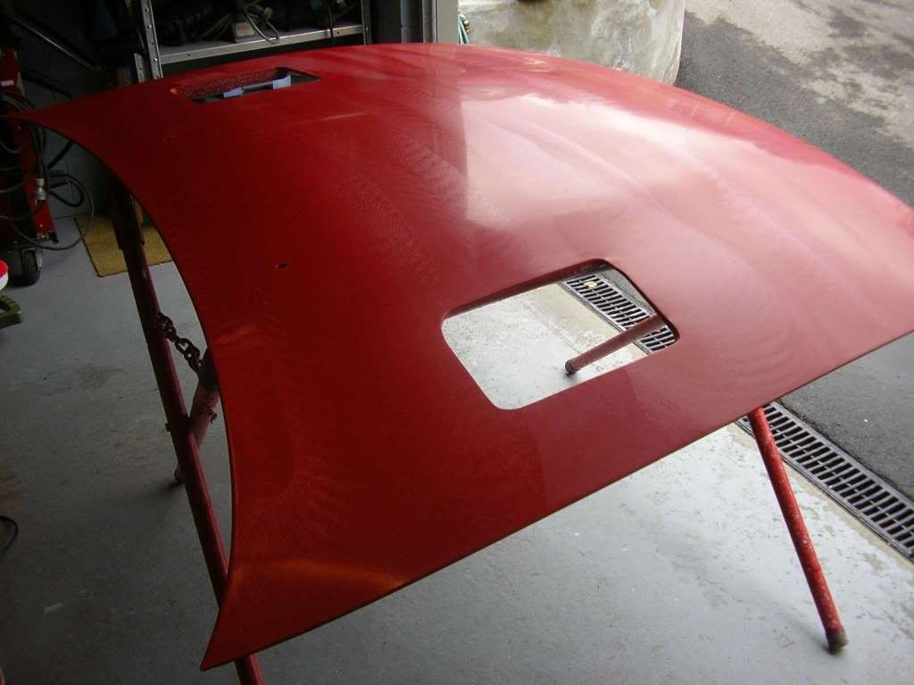

Gday welder Sparx!! I did mine! And it works fine and lets the heat out! And have had no problems driving in the rain!! Mind you I do put covers over them when I was the Z !!
gday kiff
thanks that what I was thinking of doing and saves £500 on a new bonnet,cools the engine quicker!!! great bay by the way mate:biggrin:
Yep form over function...no problems in OZ with Rain most of the year, in the Uk the standing water's going to drip on to the battery looking at those vents!, all said top job and finish.
