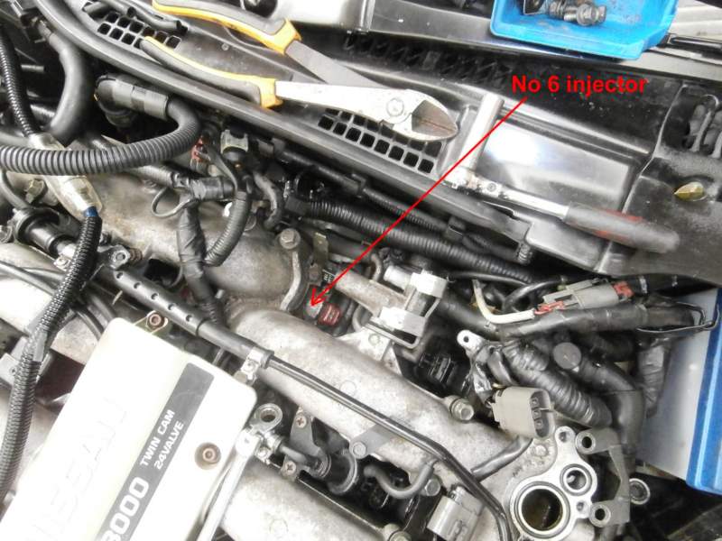

Have seen a few topics cropping up again about injectors failing and the quicker method of dremeling the plenum to gain access to the fixing screws. Many of the guys reading this may not have a clue what it means and had the opportunity today whilst changing a single injector ( number 6) on a non turbo but the same method applies to the twin turbo.
So starting off with the balancer bar removed and loom pulled back.

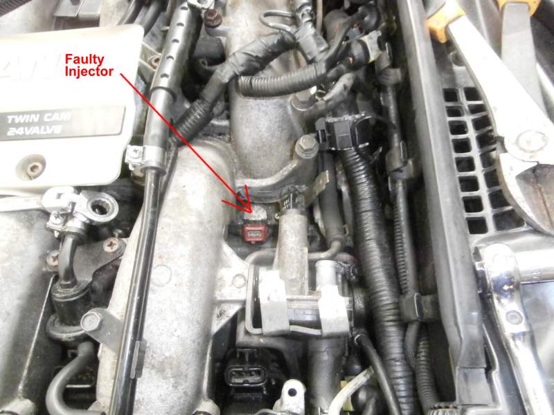

The faulty injector can be seen a little better now

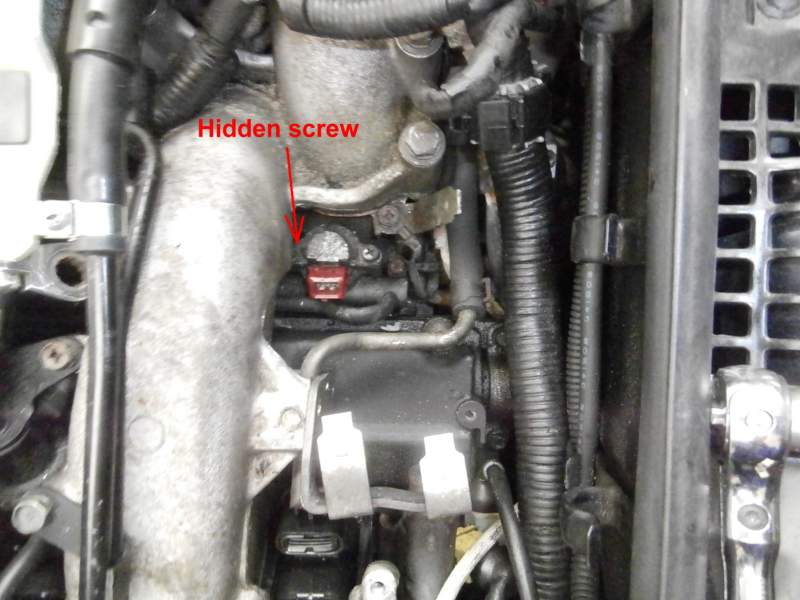

The cold run part of the idle control valve removed for even more access.

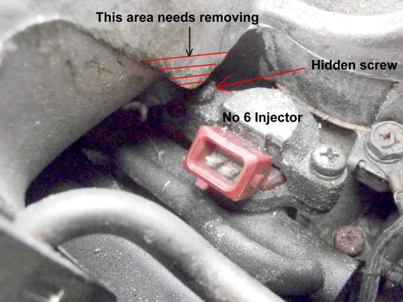

Close up it is now clear how one of the injector cap fixing screws cannot be undone due to the plenum casting in the way.
So now you need a dremel or something similar, my chosen weapon is an air burr remover, has a bit more kick than an electric version.

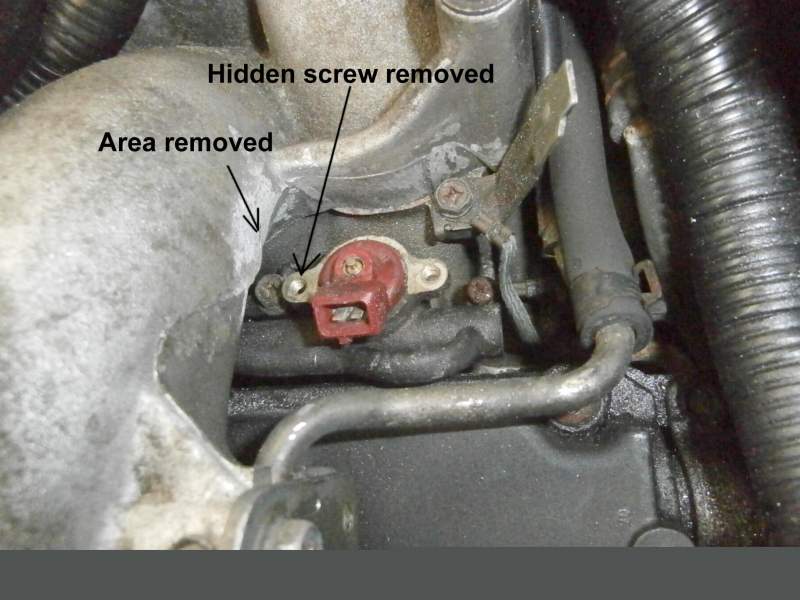

So now the excess casting has been removed the screws were able to be removed easily, one tip get a real good fitting screw driver and use a small hammer to tap the screw driver when undoing the screws.

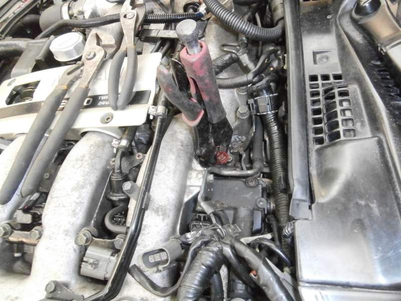

Now its not nice but with next to nothing to grab hold of, a pair of mole grips are locked onto the plastic top to pull it off.

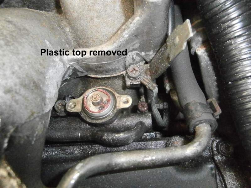

Now with the plastic removed it reveals a steel centre section that the mole grips can be locked on to now.
So with the mole grips locked on a series of twists and pulls and it will come out, its only the rubber seals holding it in but boy are they tight.

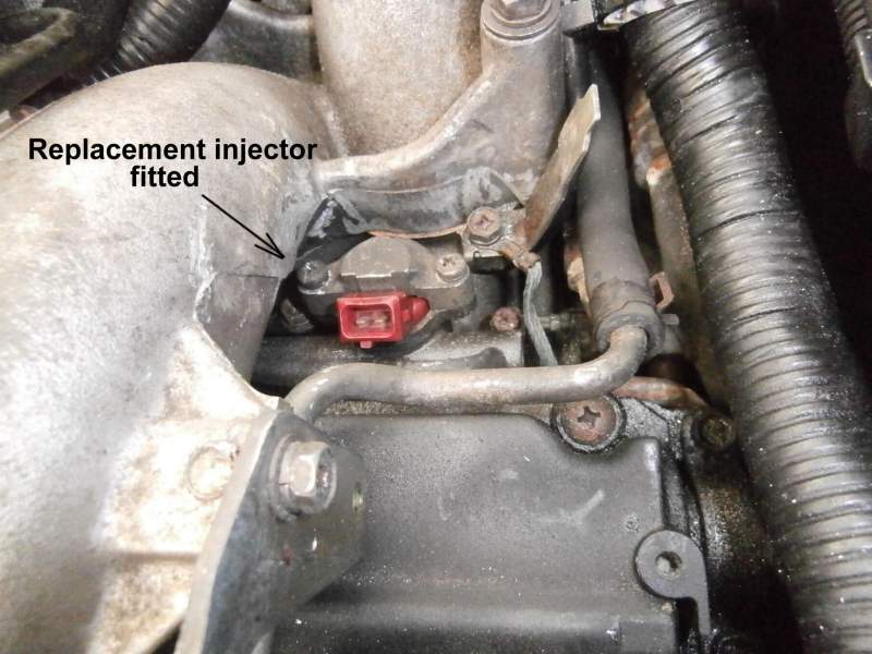

Fitting the replacement injector needs lots of WD 40 and a firm press down, all fitted its a case of putting the rest back together.
A good check around once running to make sure there are no fuel leaks and its good to go, oh and its worth getting new screws and bridge with the replacement injector as they can get damaged by the dremel action.

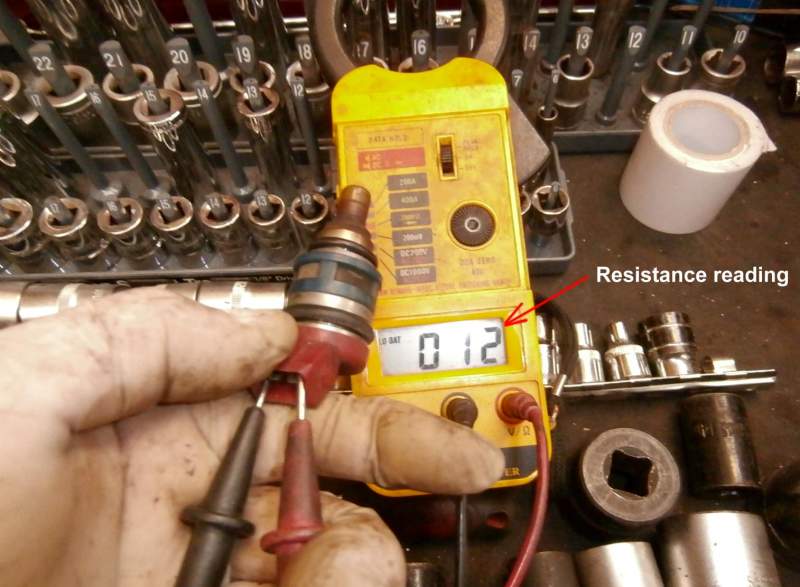

If you want to check the injector electrically you need a meter that can read low ohms level, a working injector should read somewhere around 12 to 14 ohm anYthing else and its toast.

This is so good Jeff, As you know I'm in the process now of changing no4 injector, this is so much help a great thread. On mine i check all 6 and found that 5 were 11.8/9 Ohms & no4 Open circuit. I just hope its nothing else.
