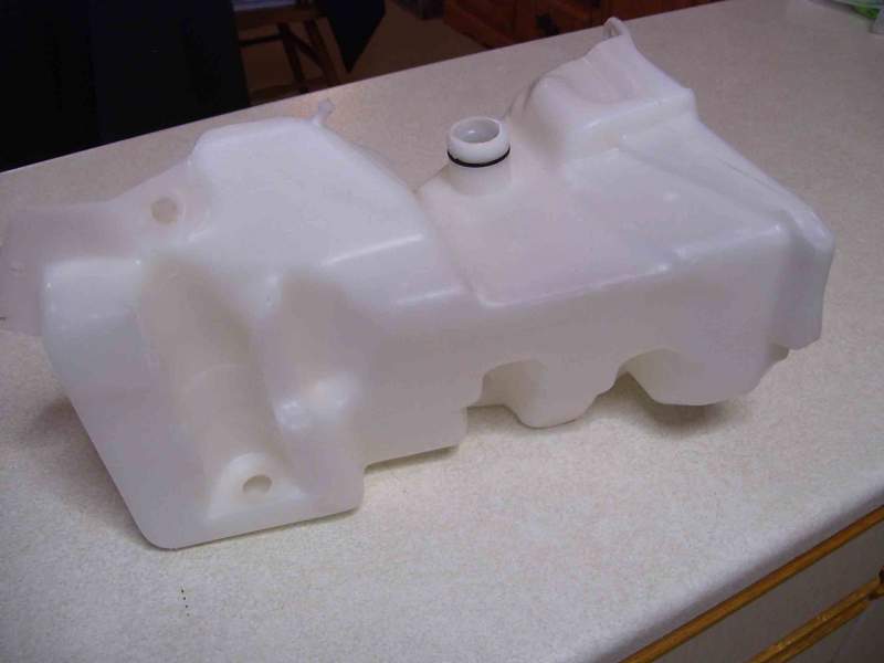

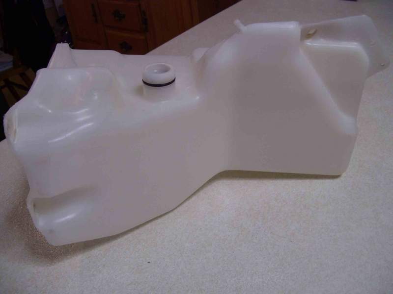

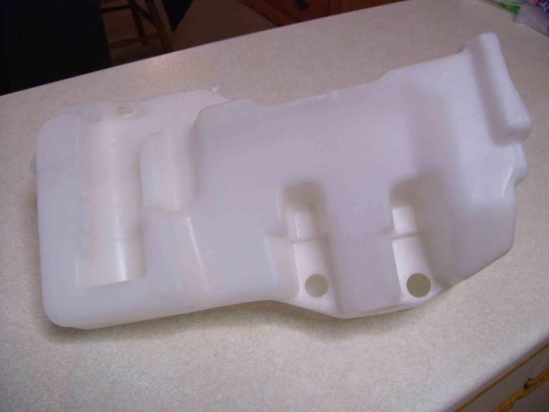

Posted the before pictures a little while back.
Filthy or what?
Finally got the washer bottle clean inside and out.
Ta Dah!
Wow bud, and what did you use to clean it again? i cant be arsed to look back through all the threads lol
First I soaked it in Janitol plus in hot water to soften everything.
For the outside I used a kitchen scoured.
The real magic happens for the inside. Once it has been in soak for several hours, I then drain it and put 2 crumbled dishwasher tablets and 2 cup fulls of dishwasher salt inside. I add about half a pint of warm water to this and then shake vigorously until all of the crap is removed. You will have to work the solution around and work each area at a time. Don't forget to block of all of the holes mind.
Cheers :thumbup: i probably wont go to the extent of the whole washer and overflow bottles but definitely the filler tops that you can see :thumbup1:

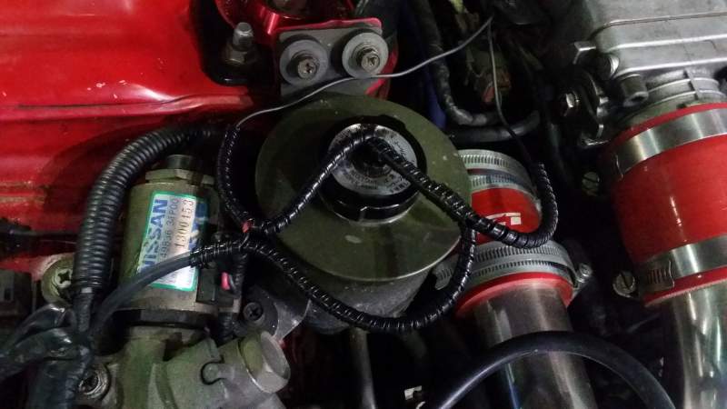

Re wired my bi-cas it was twisted and taped to check ot would work and ill be honest, it worked and I left it. Now it's much neater, solder heat shrink and spiral wrap.
Filthy or what?
Ta Dah!
I cleaned mine during the rebuild....but THAT is clean!!!
Mind doing my Brake Reservoir? :wub:

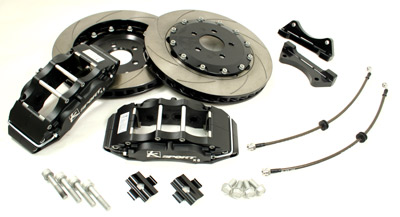

I drove it and had to stop hard in traffic, unimpressed, wide eyed and a bit annoyed I bought these minutes later,
And for the back
Not wanting to drive it in 3 weeks able to stop but not go I then bought
For the small sum of :hurl:
