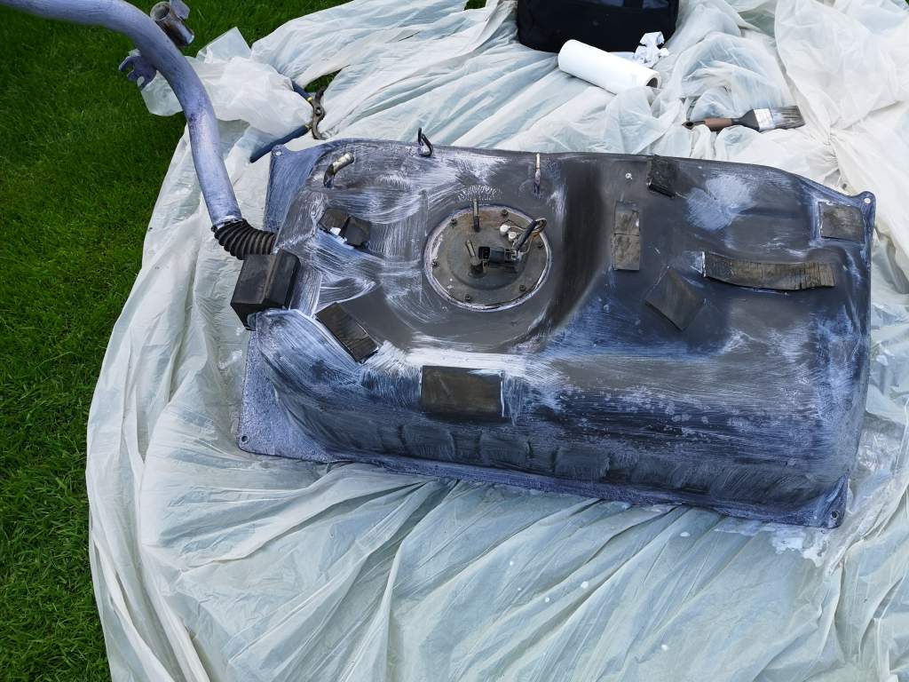

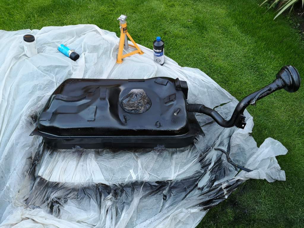

So, I picked up a new petrol tank up from Gray on Saturday. Thanks again for that Graham!
Spent tonight, cleaning it up, treating the top for surface rust and a couple of coats of Hycote underseal.
Tomorrow night, I'll do the same to the underside!
Good work Dave, make sure you give the underside of the car body some tlc too when the old tank is out of the way. A fine opportunity to clean it up, treat anywhere as required and get some fresh underseal up there!
I definitely will. I've got some thicker brush on hammerite for up there. I'll also coat the underside of the tank in the same once I've fitted it. It stays quite tacky so didn't want to use that before fitting as I'd end up covered in the stuff!

Underside of the tank painted today, no pics though.

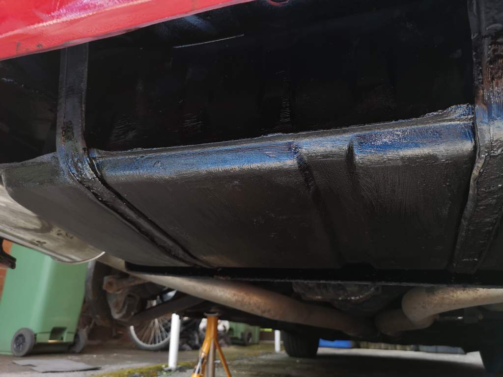

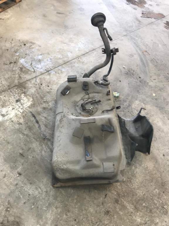

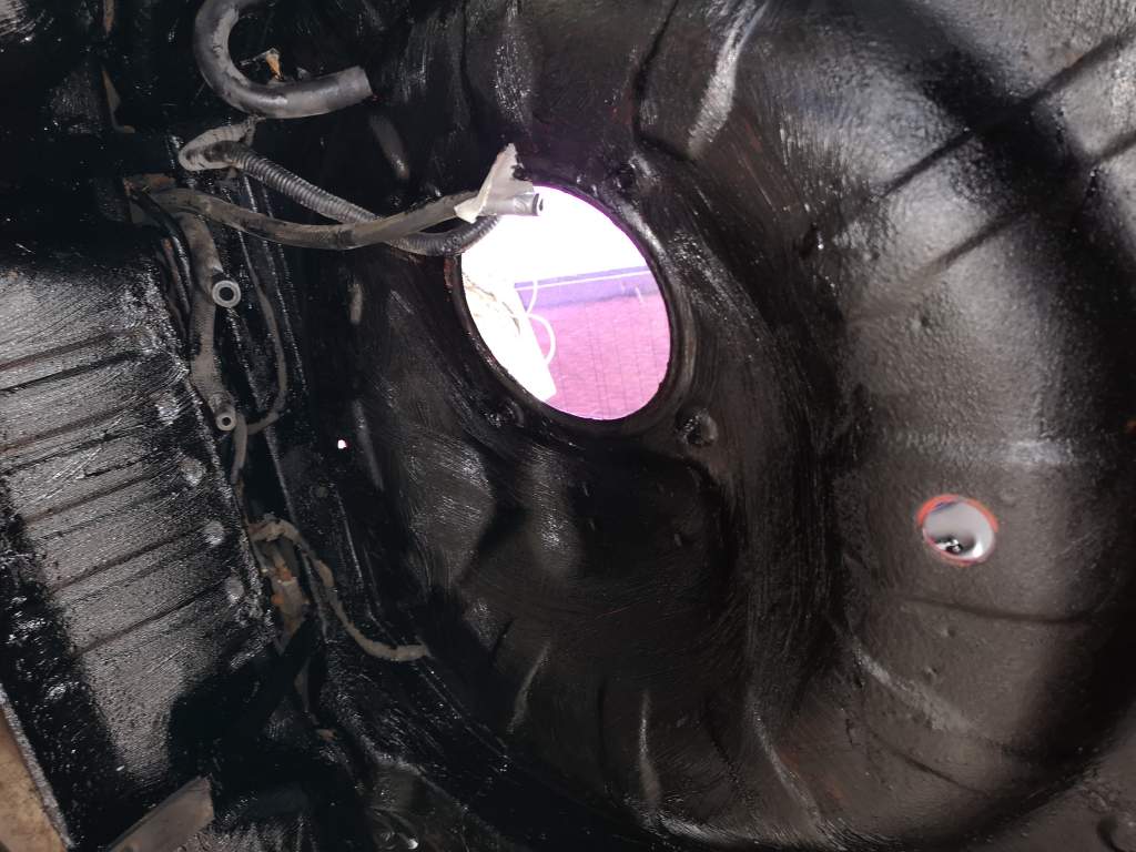

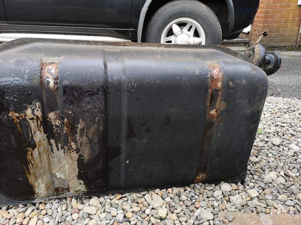

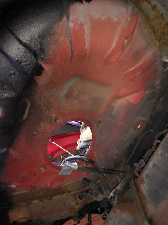

Managed to get a half day off work today finish off my tank. I managed to swap it over and whilst it was off, treated the underneath of the car for surface rust and then undersealed it.
Old one off
Before:
After
New tank fitted:
Washed and waxed:
Cheeky test drive:)
Should be all good to make the lakeland drive!
