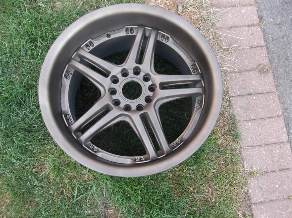

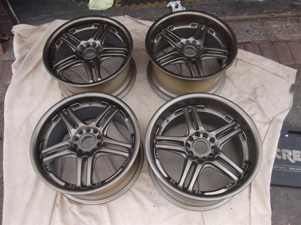

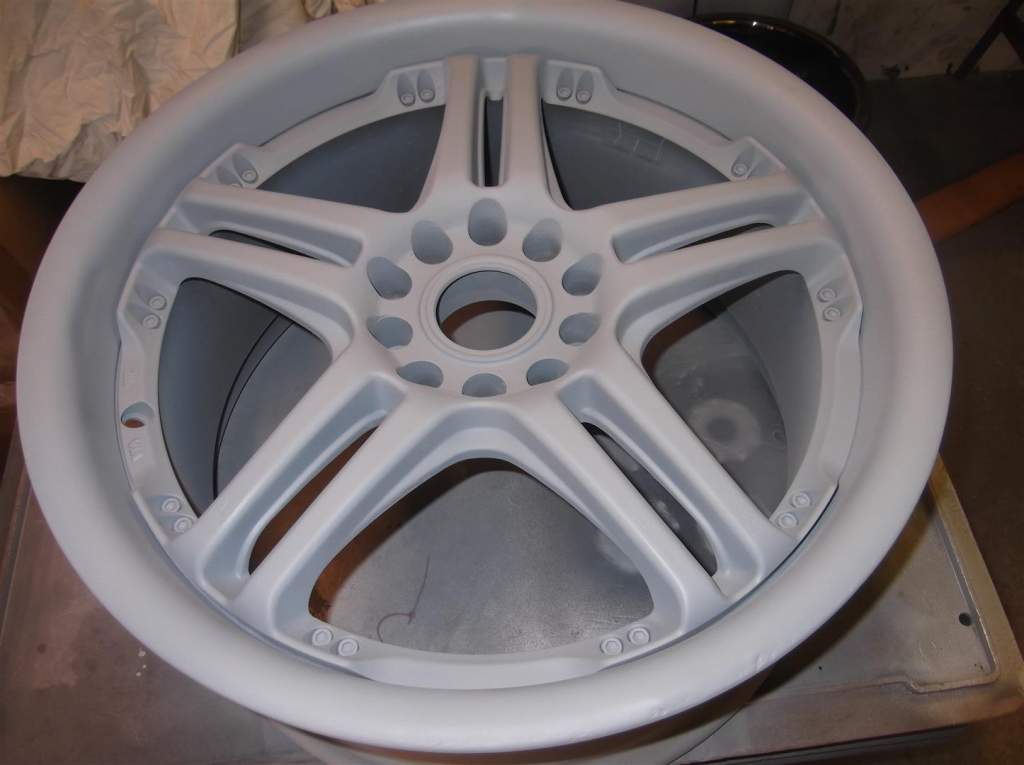

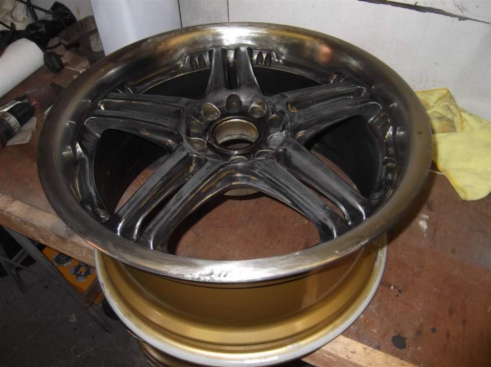

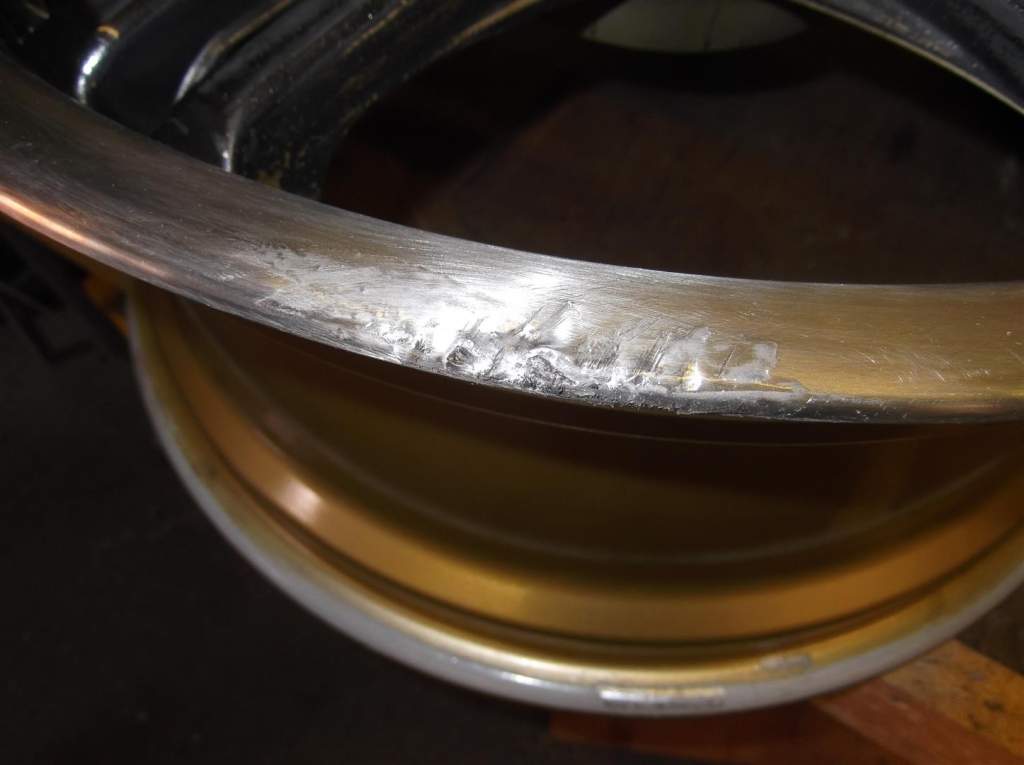

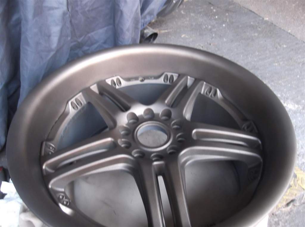

Today I finished off a "quick" reurb on my Ultalight wheels. Now I have the set of Volk SE37 for track use I decided to keep the Ultralights and put some normal road tyres on them.
This might make the car a bit more road friendly in wet weather.
I'm bored of the shiny wheels look that these have. In addition the stainless trims have some damage due to over aggressive/excessive trackday "incidents"
I have gone for a colour similar to the Volk SE37 wheels, but in a matt finish.
Im sure that wont be to any/many peoples taste but it will fit in with the overall look of the car IMHO.:yes:
It wasnt that quick a job either...:whistling:
flat down existing paint.
Satinise the stainless trims.
Degrease.
Prime in 2K grey primer.
Single silver base coat.
Bronze colour and added gold overtones.
Finish in 2K matt lacquer..
Pics..............................
I agree, looks like a great colour. Very impressed with the finish to and has made me think that I might DIY refurb my winter storage wheels. :thumbup:
Thanks for the kind words guys.
Although the Ultralights are just run of the mill Taiwan tat they do have some redeeming features..
They are just about the perfect size at 8.5 and 9.5
The offset at +35 is OK. Just a 10mm spacer on the front to get them to +25.
They are very close to the weight of the Volk SE37.
They have proved themselves to be strong enough to withstand some off circuit kerb hopping!.

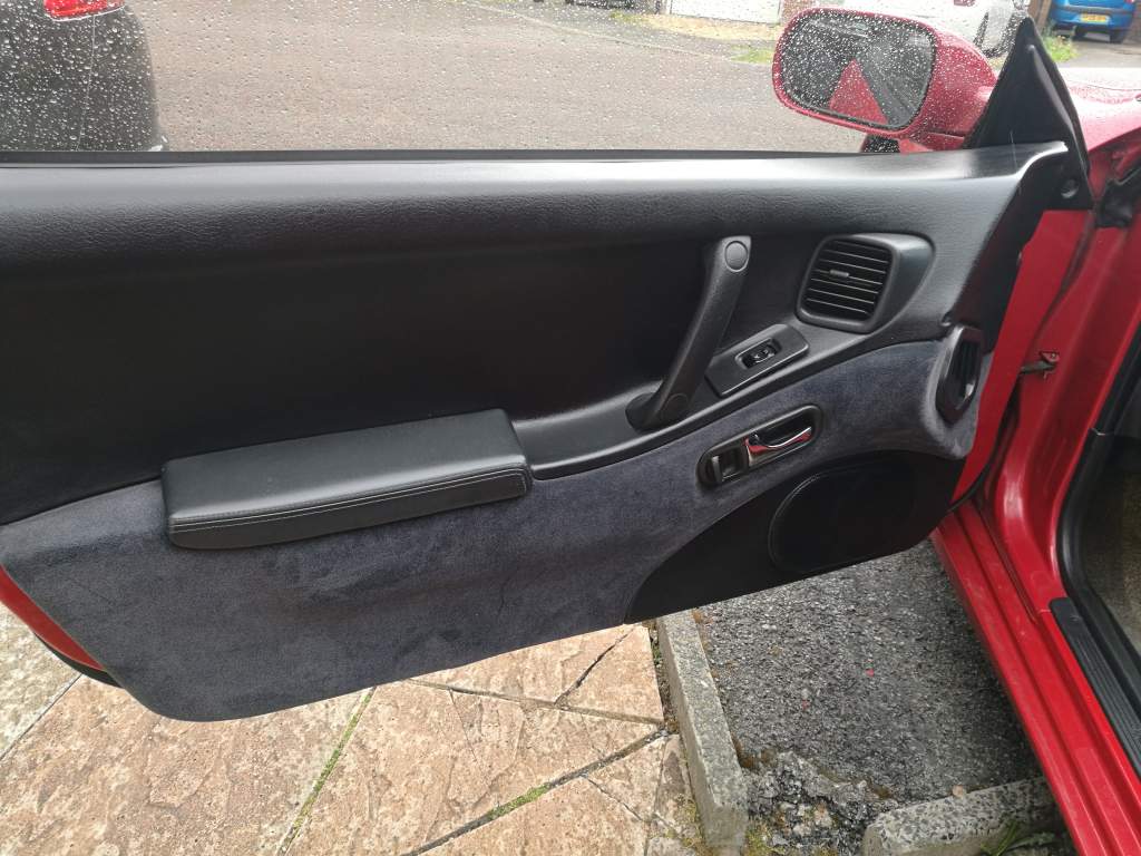

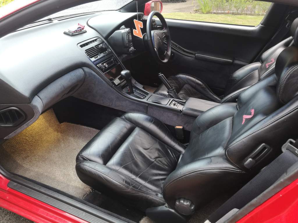

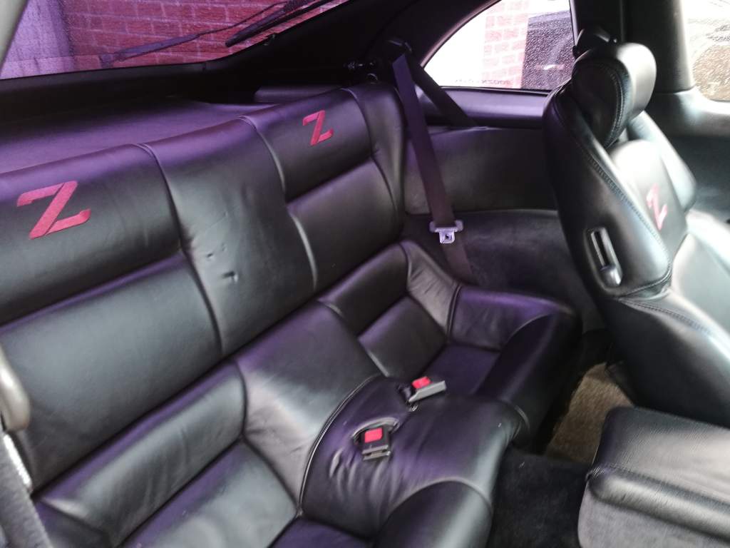

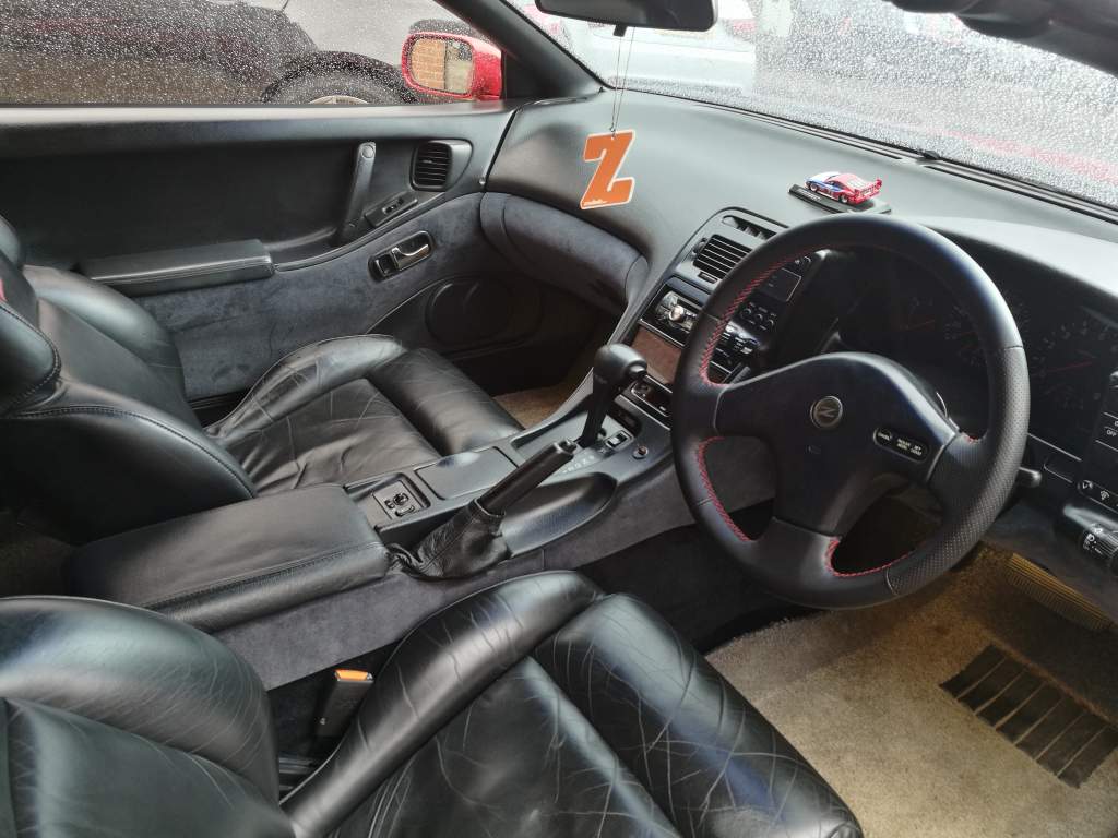

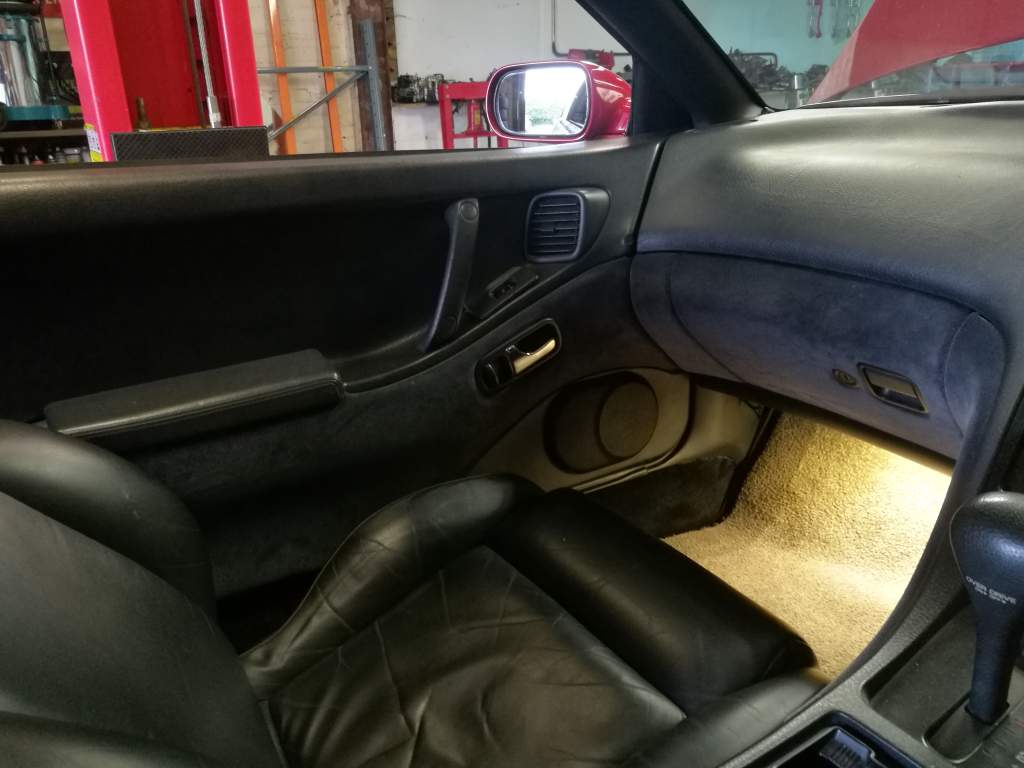

Had my seat belts relocated yesterday to accommodate the series 2 interior I got from Ian Greenfield. Also fitted the chrome handles I got from ebay and the arm rests courtesy of Tom. Looks so much nicer, cleaner and more modern without the tweed.
I also changed the red foot well lighting I had to some warm white earlier in the week... Thanks Phutumsch for supplying the bulbs. I must be growing up!
I also got my passenger side front caliper refurbed with new seals and pistons. I did my drivers side one a few weeks back but hadn't had the time to do the other one so got it done whilst in the garage. We then fully flushed out all the previous brake fluid and replaced that too. Felt a lot better on the way home!
Very sumptuous!
I'm getting the darker shag pile mats also which I think they will match nicer
