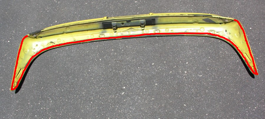

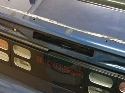

It is very important to prevent water ingress between the spoiler and the tailgate. Nissan used
adhesive strips to provide seals which over time fail to remain watertight and allow water ingress which
damages the spoiler with corrosion to the metal parts and subsequent rot to the foam.
To provide a permanent water tight seal, at a minimum bond the spoiler (Sikaflex or similar) to the tailgate
along the inside of the leading edge (where the adhesive strips would have gone) and along the bottom
edge of the "wings" as in the red line below.
[ATTACH=CONFIG]111936[/ATTACH]
Thanks will advise the body shop. [emoji106]

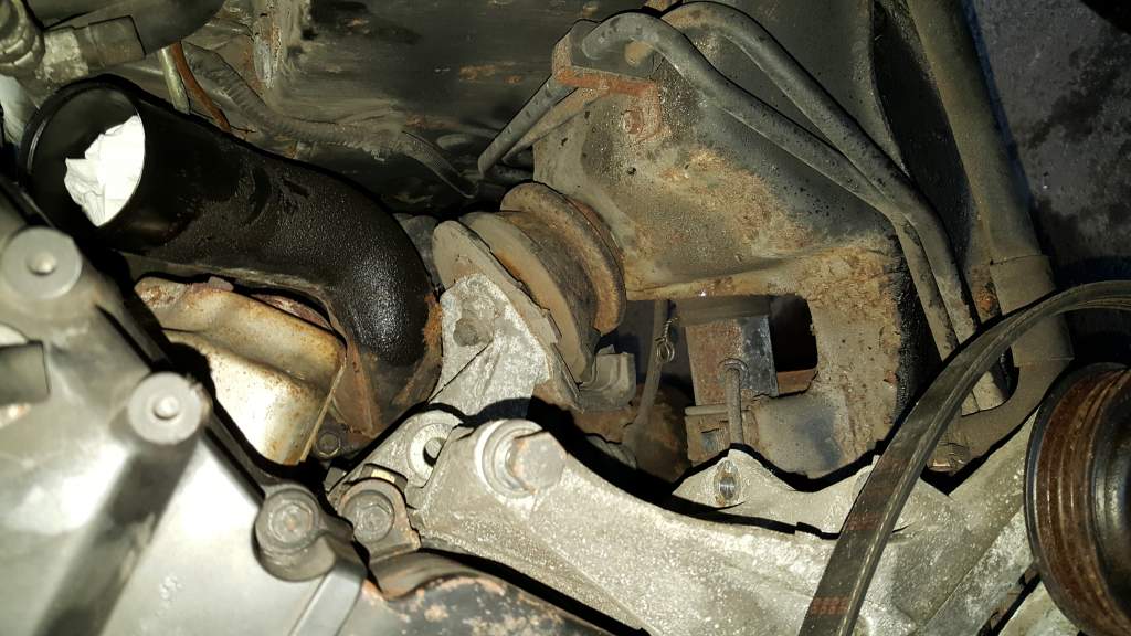

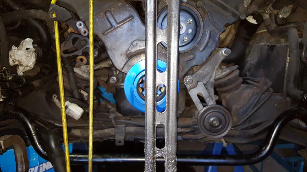

Victory finaly got the compressor of, the rear bolt was a nightmare
And Double victory alternator and power steering pump of on the other side

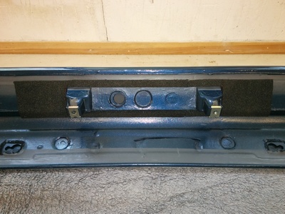

Oh and you will be missing the closed cell foam gasket which goes around the third brake light area which
you will need to seal the area. You can buy the stuff in self adheasive 6mm sheets and cut to shape.
[ATTACH=CONFIG]111937[/ATTACH]
[ATTACH=CONFIG]111938[/ATTACH]
