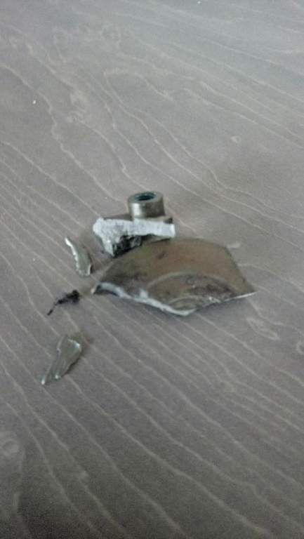

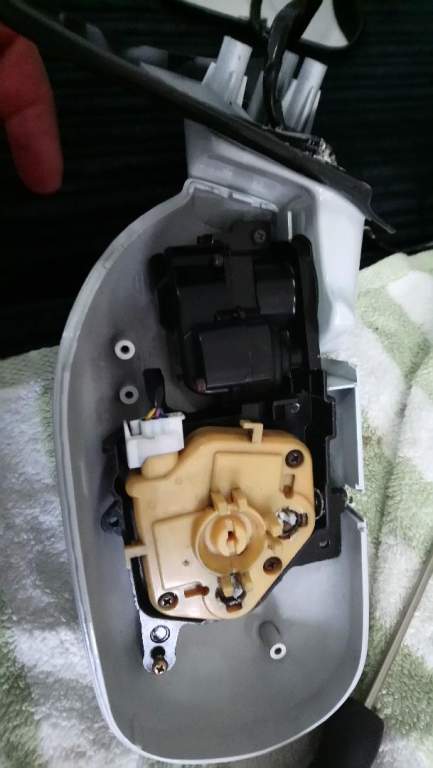

Something that's been annoying me for rather a long time is a wobbly passenger side mirror. The base bracket which is made out of cast aluminium fractured after hitting an old Spanish woman about 5 years ago who thought it would be a great idea to walk out between two parked vans, looking the wrong way and straight into my Z. Fortunately I saw her in time and was able to avoid a direct hit, but the mirror chassis took a battering. She was ok apart from a few nasty bruises. I managed to fix the bracket with some chemical metal, however it started to wobble again during the Euro road trip that Andrew and I went on last year. Managed to find a good passenger side mirror from coopd which was from a later model with heated glass. Stripped that down, removed the black wires which were for the heated glass and swapped everything over.
Not a very interesting post but might help those who are wanting to disassembled for paint or similar damage.

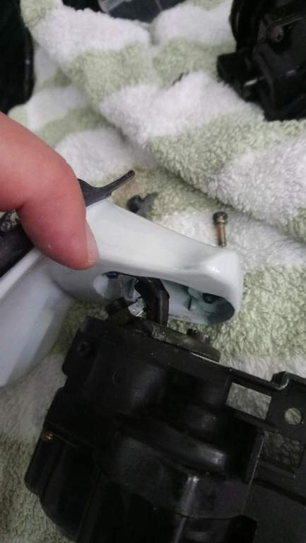

As I disassembled, you can see that the bracket has completely failed:
Like....completely. It had broken into far more pieces than originally.
New chassis all fitted.
Covers all secured:

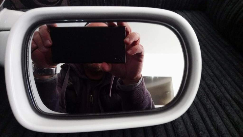

Glass in

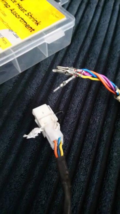

Connector depinned and repined. They're differed as they newer style mirrors contain the two black wires for the heating elements.
