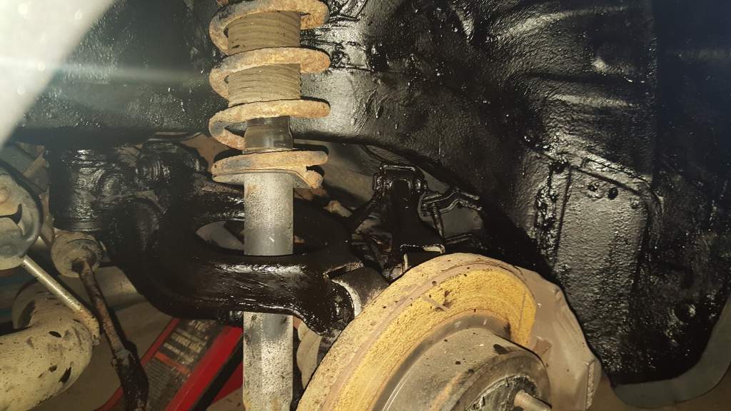

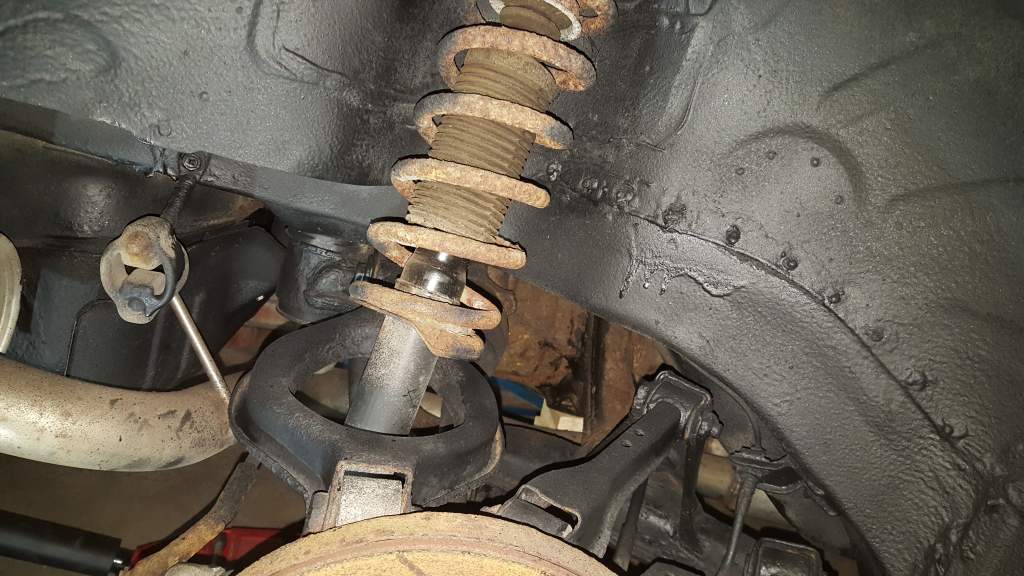

Well onto the last wheel arch at last weather has been crap last 2 weeks so got virtually nothing done, finished the stone chipping now just a bit of waxoyl and hope the weather stays nice and itll get done :helpsmilie:
Well weather was good i'm now coverd in waxoyl but got the final wheel arch done, so onto the surface rust next week i can finaly see the end of the tunnel

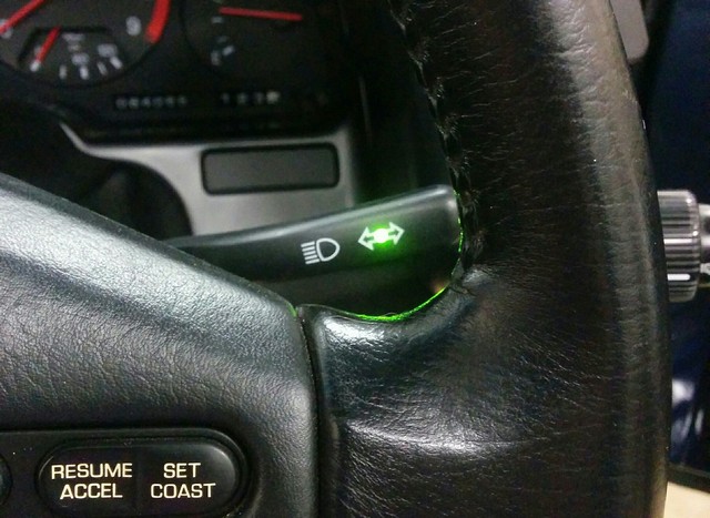

Installed the correct indicator stalk for my UK spec (with headlight flasher symbol) fitted with
extra turn indicator warning lamp (the why is described below).
https://www.300zx.co.uk/forums/showthread.php?173537
[ATTACH=CONFIG]107345[/ATTACH]
Great modification Andrew.....!!
