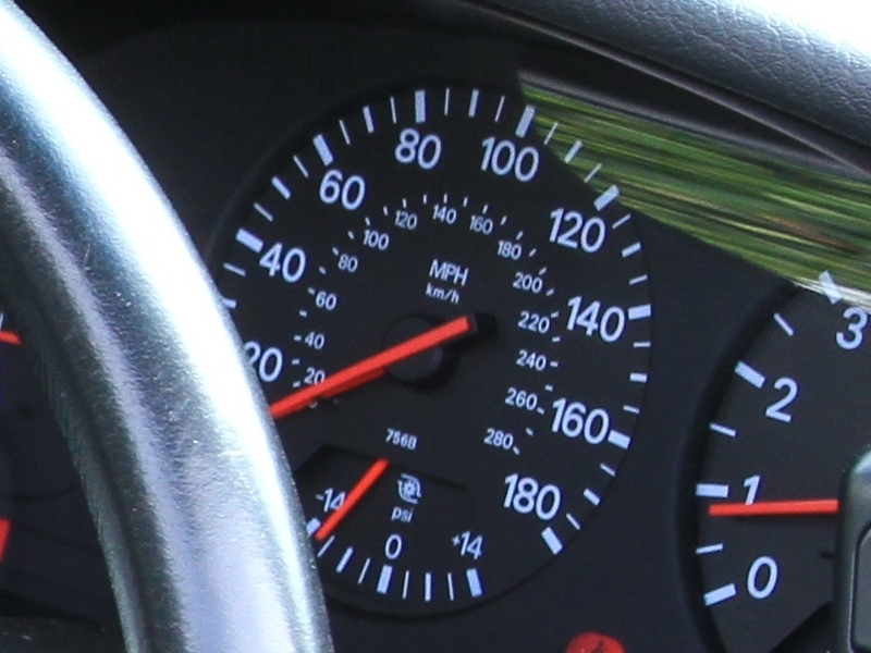

Just back from MOT Center and it a pass :punk: Just one thing he noticed my clocks are in mph only and they should be mph and km so I need to change that for next mot. Not allowed to take pics but did a sneaky video.
This proves there must be some differences between the uk mot system and the one used in NI. We don't have any requirements for MPH Or KM. We don't check speedo function either.
Yes Chris it must be a N.I. thing as we have a land border with the south of Ireland who uses KM per hour. Apart from that it should be the same.

I believe all UK factory cars read in both now its only cars being imported that dont. If I'm wrong let me know:)
I didn't mean Z specifically. Many cheap and old cars only display MPH.
