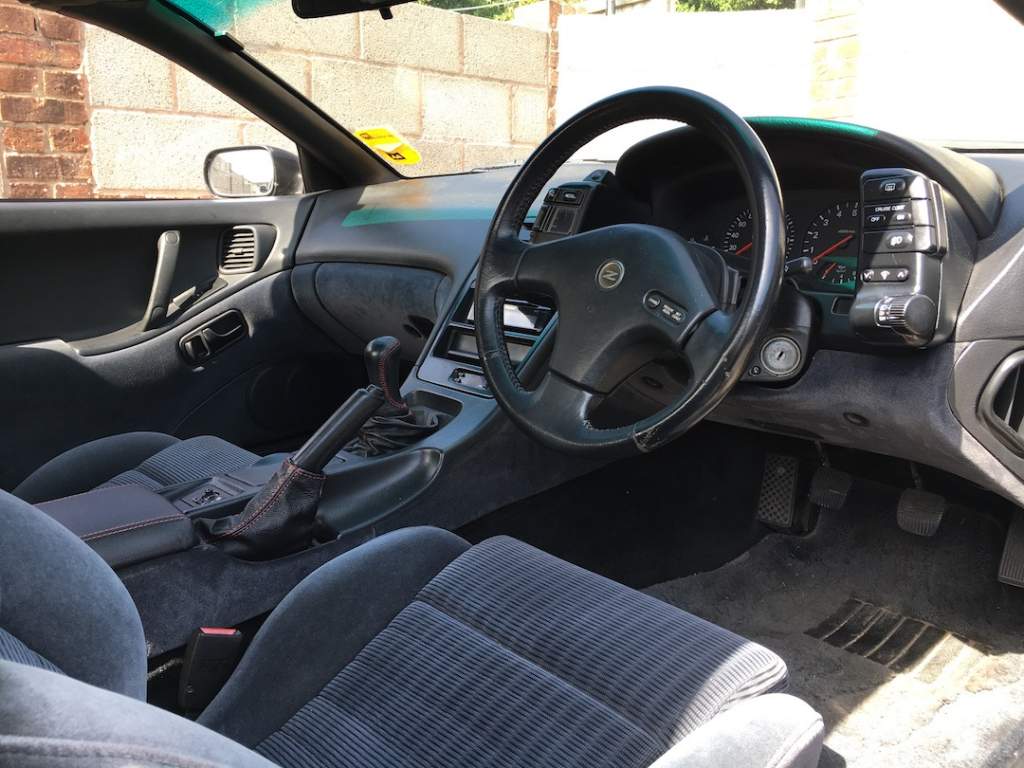

Had a little play with the Z today, cleaned the interior and gave it a hoover.. Gotta get the sponges out and wash her again..

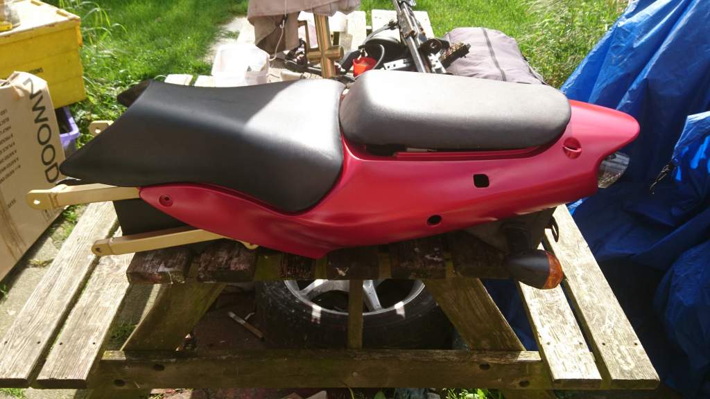

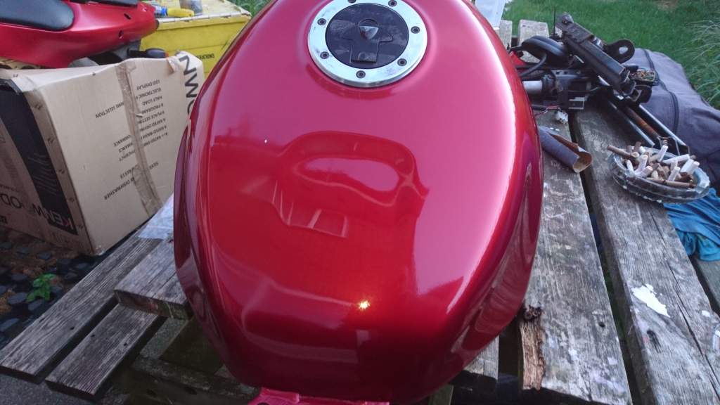

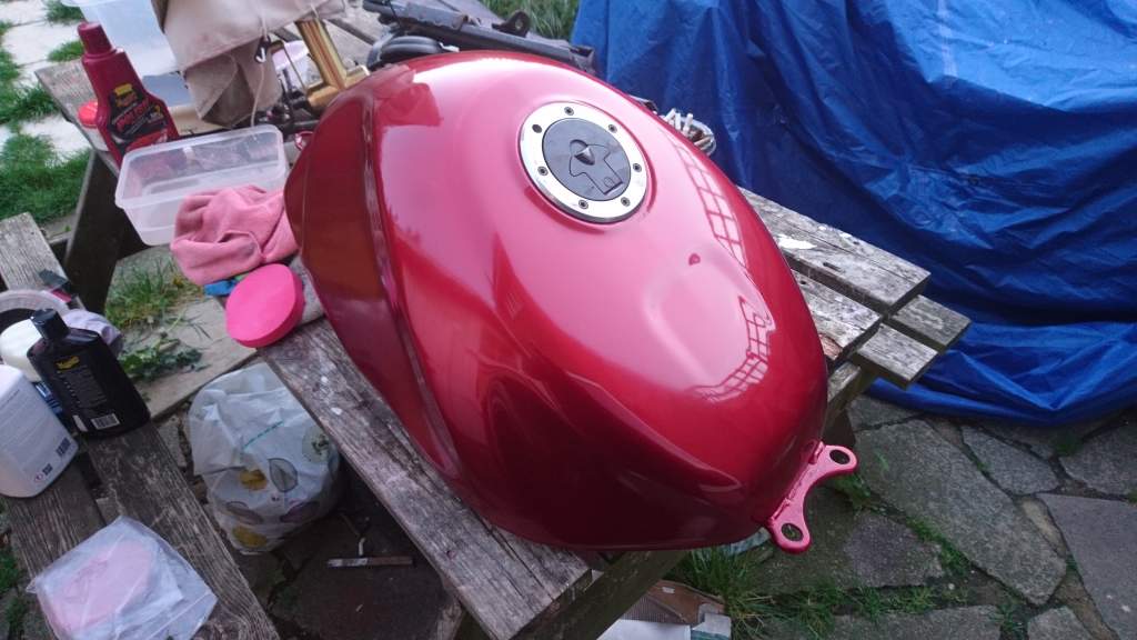

Finally finished the fuel tank off. During the week I've refurbished the rear subframe and a second hand set of rear plastics.
Both now repainted. The plastics in the same red as the tank and the subframe in gold.
I test fitted the rear end together and it's starting to come together nicely..

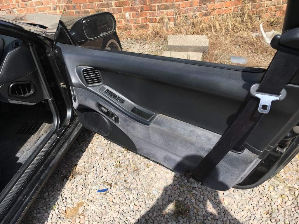

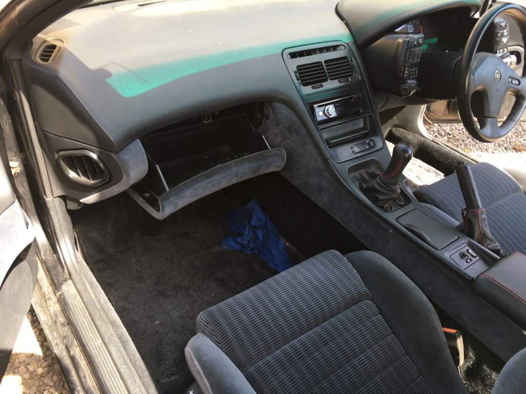

well over the last few days i did an interior swap, the worst bit was converting the door cards to series 1 to accommodate the seat belts but all went ok, i have even reclaimed my glove box and concealed the boost controller under the ecu cover. now it just needs a good clean ready to take out over the weekend

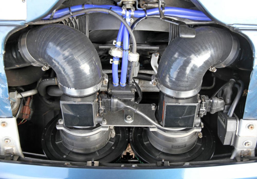

....I guess no one's noticed the dual elbows either. ;)
I did notice them, but assumed they were an existing feature.
So are we looking at a dual MAF and breathing type modification?
If your going to breathe you need feed. Too long have his turbos been on casual mode.
Yes, treated the Z to a Selin dual MAF intake kit, Tomei 740cc injectors with a JWT adaptor kit and a Wiring Specialties new style injector harness. They'll be going on with a new fuel pressure regulator/damper and an EBC set to 16psi.
It will hopefully make a bit of a change from the current 9psi!
Edited by Joely P
There's no hopefully about Mr P. Be careful.

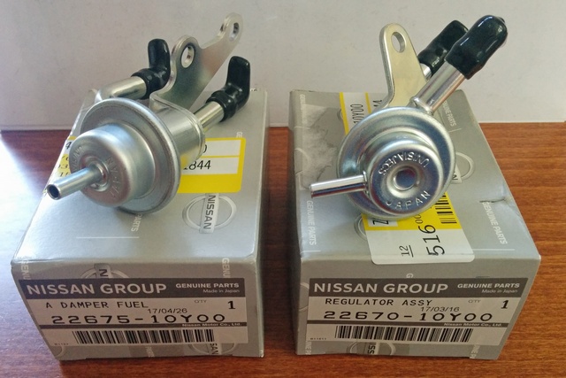

These turned up today and will be fitted along with new OEM rubber fuel lines and spring clips. The rational
behind replacing them is explained here:
http://www.twinturbo.net/nissan/300zx/forums/general/view/2610744/Here-is-how-it-works.html

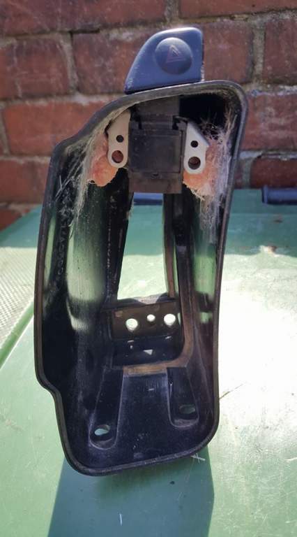

Well needed a break from the tin rot so decided to tackle the air con pod, bit of fibre glass resin and its good as new
