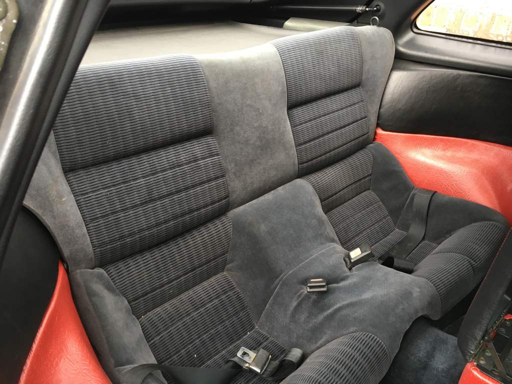

been quite productive today, had my centre console out and removed the old jdm cd player harness, should of done it years ago, fitted my aux/usb socket in there for my new head unit. finally finished removing my carputer build and fitted a nice pioneer dab single head unit, and started to swap my seats over bye bye leather hello series 2 cloth.
just need to find the right colour suede now to cover my panels or get some panels, i think i have found something that's a close match i'll see what happens when the samples arrive.
yes it's not to bad it's the drivers seat that was letting the car down, got to be honest i picked up the series 2 cloth seats for a very reasonable price
[ATTACH=CONFIG]105905[/ATTACH]

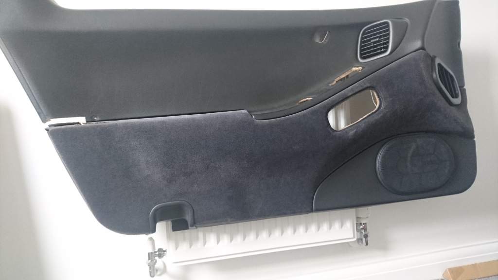

Not suede, it's velour, I keep telling you! :lol:
Going from leather to velour was the best decision I ever made on the interior of my Z. It's much more comfortable, much quieter and much more subtle. The trick is to find the best condition parts you can and that's not always that easy. I've replaced a lot of the interior plastics with brand new ones in mine and a passenger seat donor gave up its guts for my driver seat and it all looks nearly-new now!
Also have a look at getting some series 2+ seat belt buckles; they tend to weather a little better than the faded ones in earlier cars.
Best thing you can do is to try and buy 2 sets of front seats and use the passenger seat parts as a donor for the drivers side. I had the bolster swapped and all the foam to my drivers seat. Looks and feels fantastic.

You ought to just buy the door panels and rear quarters from Jimmer. It'll match that way. I have some spare material you can use to cap the tiny cutouts on the rear quarter panels. You can then modify the door panels to fit using your old door cards as donors. I did mine and they look factory.
i'm off to see jimmer in a few weeks for an oil change etc, so i'm going to see if he has a full set of panels in, then i'll prob be after some advice on covering the door cards
Don't bother recovering them, just buy the velour ones he has. It'll all match that way.
