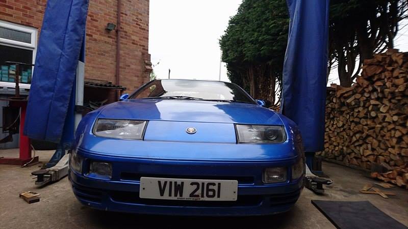

Trip to Lee Dent yesterday to get a few jobs done so a replacement low mileage uk manual box fitted, new disks and pads up front and an oil change.
Also lee replaced a knackered ac belt tensioner pulley that was squealing.
Totally unplanned was lee ripping out my cats an replacing the std downpipes with japspeed divorced items and decat pipes and 2 new O2 sensors.
Car now purrs like a kitten again so have to thank lee for his stirling work once again and Coopd for the convoy down and nice to see Chris bedzedman picking his shortie up like a giddy kid. Great day great banter top mechanic.
Made it shiny!
Might go for a short hoon later...I really don't drive it enough anymore.

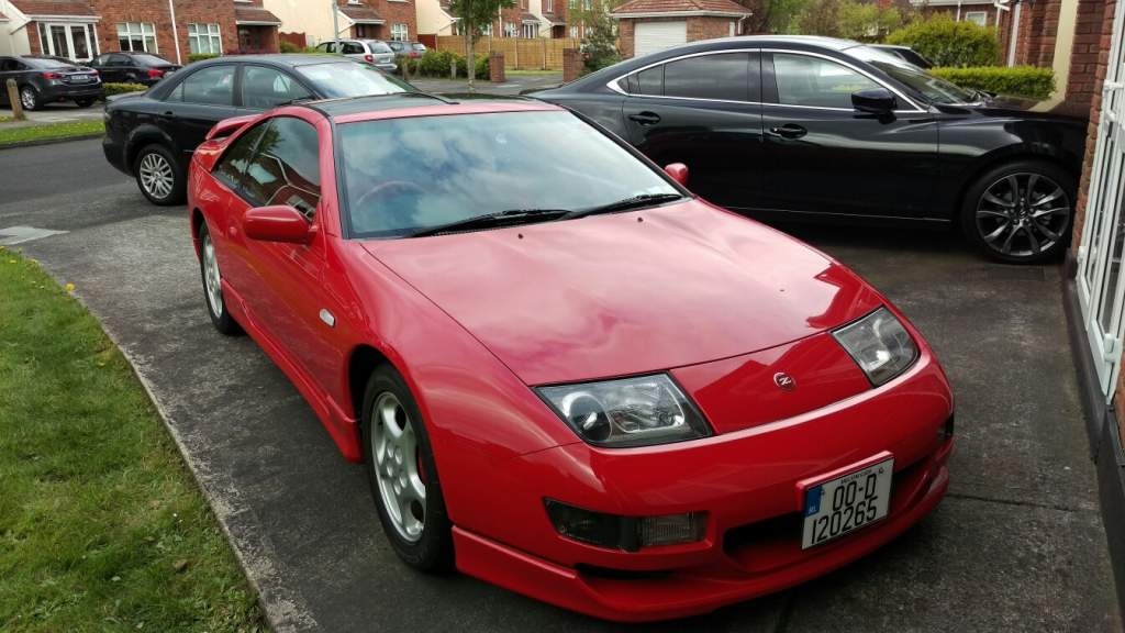

Also changed the air filter and cabin filter on the new daily; the 2007 Mazda 6 S pictured behind the Z. Top spec (bar MPS) with about 150PS and we're the second owners :thumbup: Fun story - the missus was scared to drive it, being larger and more powerful than an Almera, so I took the chance to pick her up from work the other day. Parked right out front in full view, jumped in the passenger seat and cracked open a beer. She was pissed but it worked :lol:

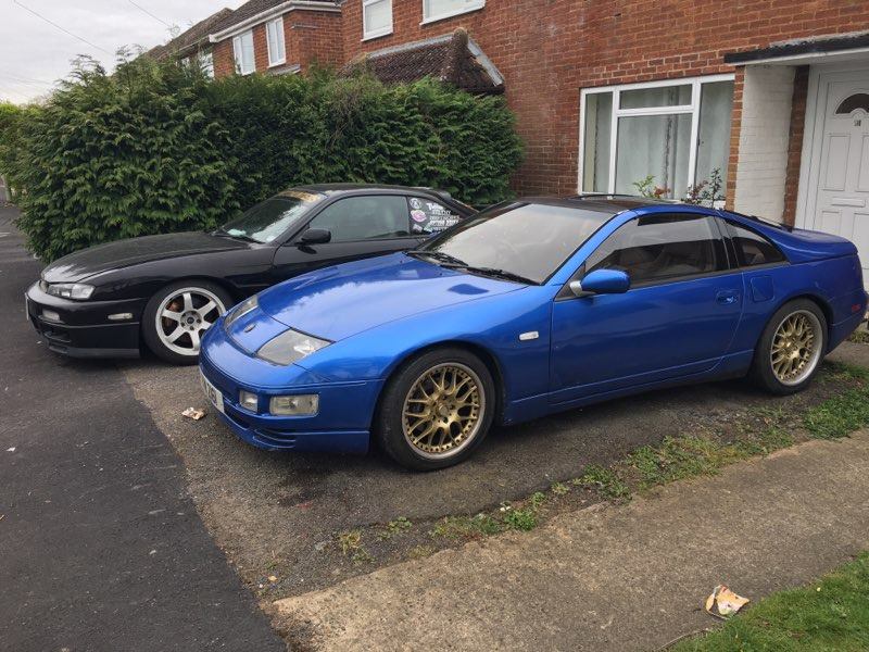

What did I do today? LOTS!
Received my new 17mm AF wheel nuts in the post, and immediately woke my mate up so I could go and collect the wheels I bought last week. (the wheel hole is too small for the socket for the 21mm nuts I had before)
[ATTACH=CONFIG]105785[/ATTACH]
They're not perfect, but the money helped a mate out and they're infinitely better than the unbalanced and very white Momo 5 spokes that it came with.
Plus the Bridgestones on the front wheels are a massive improvement on the mismatched Chinesium Ditchfinder Pro's on the old wheels!

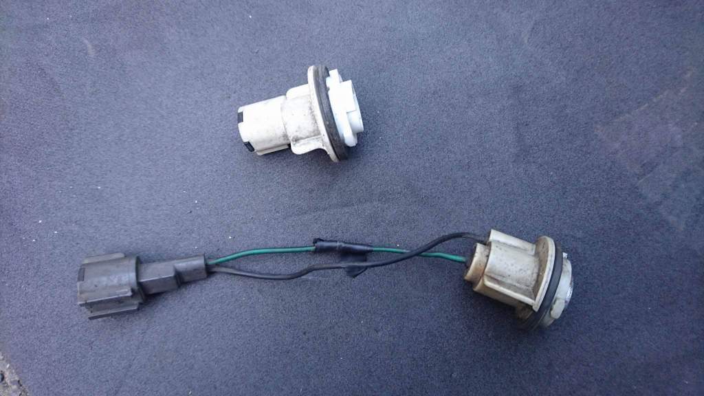

Then, over to my local scrappers after a quick bite of lunch to see if I could scrounge some wiring to repair the right hand indicator bulb holder which had ceased to transmit electrons. Ended up discovering that facelift K11 Micra indicator bulb holders have the same connector and the same bayonet design, and although they don't have the wire tail of the original, the chassis loom stretches to connect, so flashing recommenced!

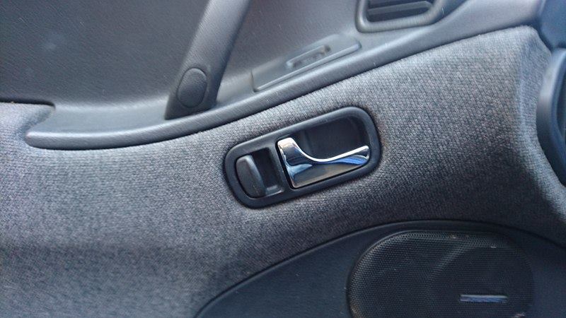

Also fitted my snazzy chrome interior door handles because why not? Easy to do, and I've got two more knocking about.

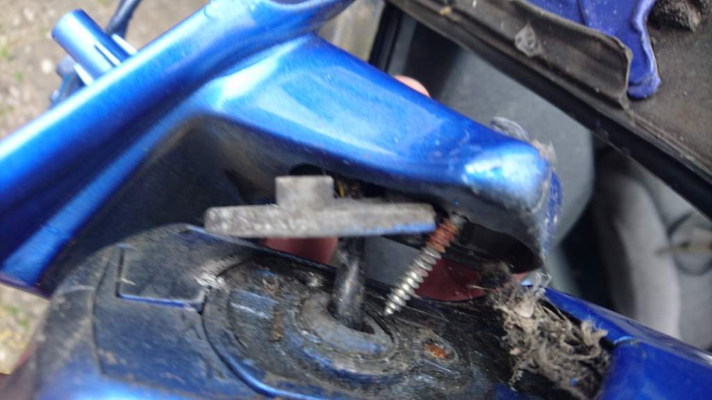

That little lot, combined with the door mirror I swapped out, is making it really start coming together.
The old mirror was held together with wood screws!
[ATTACH=CONFIG]105789[/ATTACH]
New one has power fold... Decadent.
