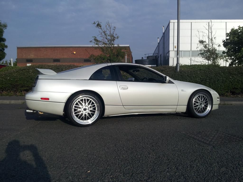

    Today nothing, but I did take the Zed out for a little drive the other day - and stopped for a couple of pics. Any excuse 😉

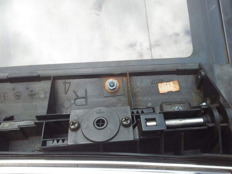

Finally found where my targa was leaking from, having stripped it apart, appears i need to replace either the plastic part that houses the closing mech, or use excessive amounts of silicone sealant around that bolt between the targa and its mounting point on the out side of the glass, its one of the main bolts that connect the plastic part to the glass.

That bolt should sit in a rubber cup within the glass. You can only do them up so tight so sealant is a must. Easy peasy. Hope that ends it for you.

Yep, the little plastic bit on the other end isnt sealing against the glass for some reason, so need to get some black silicone sealant.
