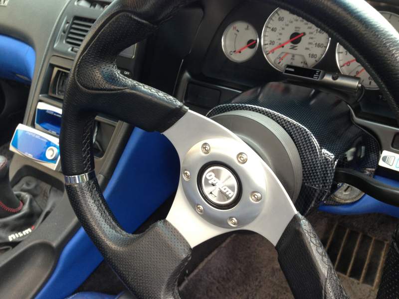

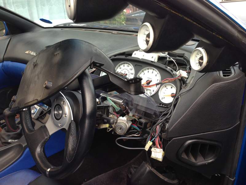

I did a few jobs around the dash area this morning. One of the chrome dial surround rings had fallen off, presumably due to the heat we've been having, so I had to dig all the way down to the cluster to reseat it (I managed to almost screw it in without using glue and surprisingly it's stuck in pretty solidly now). I also noticed that the stock temp gauge wouldn't rise past half way due to the heel of the needle brushing against its chrome surround so after a bit of very careful filing down (with a screwdriver) it now only just passes freely - although having said this I never use the stock gauge; I always refer to my aftermarket gauge. I swapped over the left-hand pod with a brand new one from ZCentre, because the two locating lugs which fix the hazard switch in place had broken in my old one and the hazard switch was a little loose and often wouldn't engage or disengage the hazards correctly. And finally I swapped in a carbon-fibre-look steering column surround.

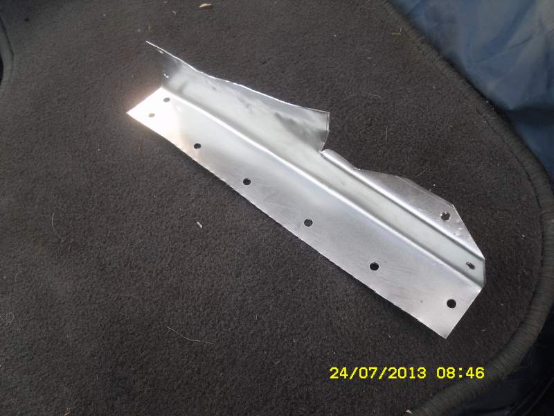

Well I have made a replacement section of N/S front Inner sill to replace the rusty piece...... All I need to do now is to weld it on......carefully!

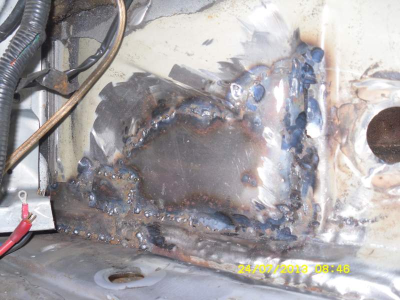

Oh and I tried to weld up the other piece of floorpan, Solid but looks a mess, a bit of tidying up to do before I am finished.....
