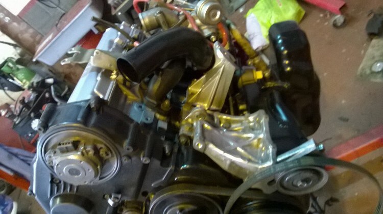

Fitted tt modified pas pump and 56mm alloy rad
Left na pump right modified tt pump

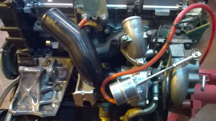

Well most of the engines back together,lees done a great job can't wait now,picking my swb up next week after lees got it all road worthy again:drool:

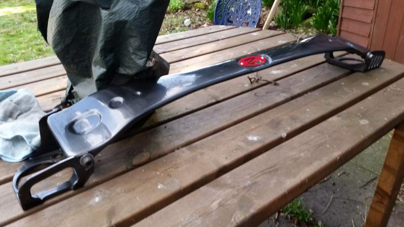

Decided at last since its a nice day to take the Tokyo auto strut brace off in preparation for chroming. Time to get the cleaning gear out and refresh the engine bay too.

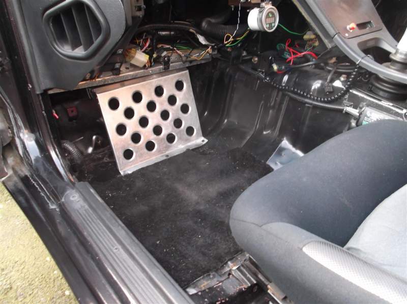

I fitted a passenger footrest as I have the Cobra Monaco seat mounted well back out of my line of sight.

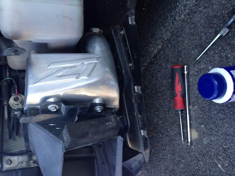

Ever since i fitted the old style Z1 throttle bodies the tickover has been too high.
The quality and operation is pretty poor and on investigation there is play on one linkage. It might be a worn/weak return spring as my external return spring bodge seems to have improved matters!!!:scared:
I also found two bolts on the rhs front tension rod not fully tight which was causing a slight click/clunk on sharp braking.
A quick trip down the bypass late afternoon showed all to be much better than before.
