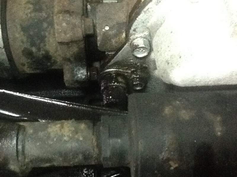

Took them out to adjust baz as they were far to low and I was hitting speed bumps and to low for mot stations round here,but the dam front left was leaking so that's a fail for so I just put the tein in that I had bought nearly 2yrs ago so got a better ride height now.

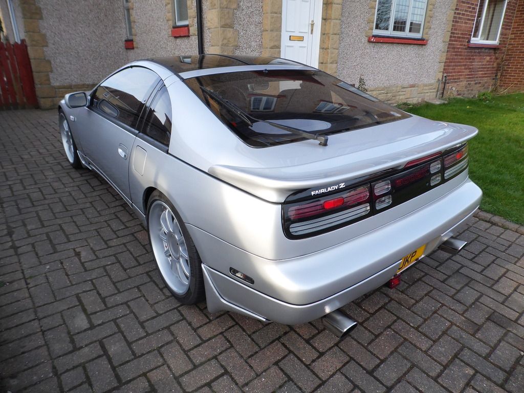

I've done a few things today :)
Cleaned all the roof inners and door shuts as they were absolutely filthy! She should look much more respectable now when the roof's off.
Had a bit of a clean up under the bonnet in readiness for Lee Dent's on Tuesday. Again, pretty filthy originally but somewhat prettier now.

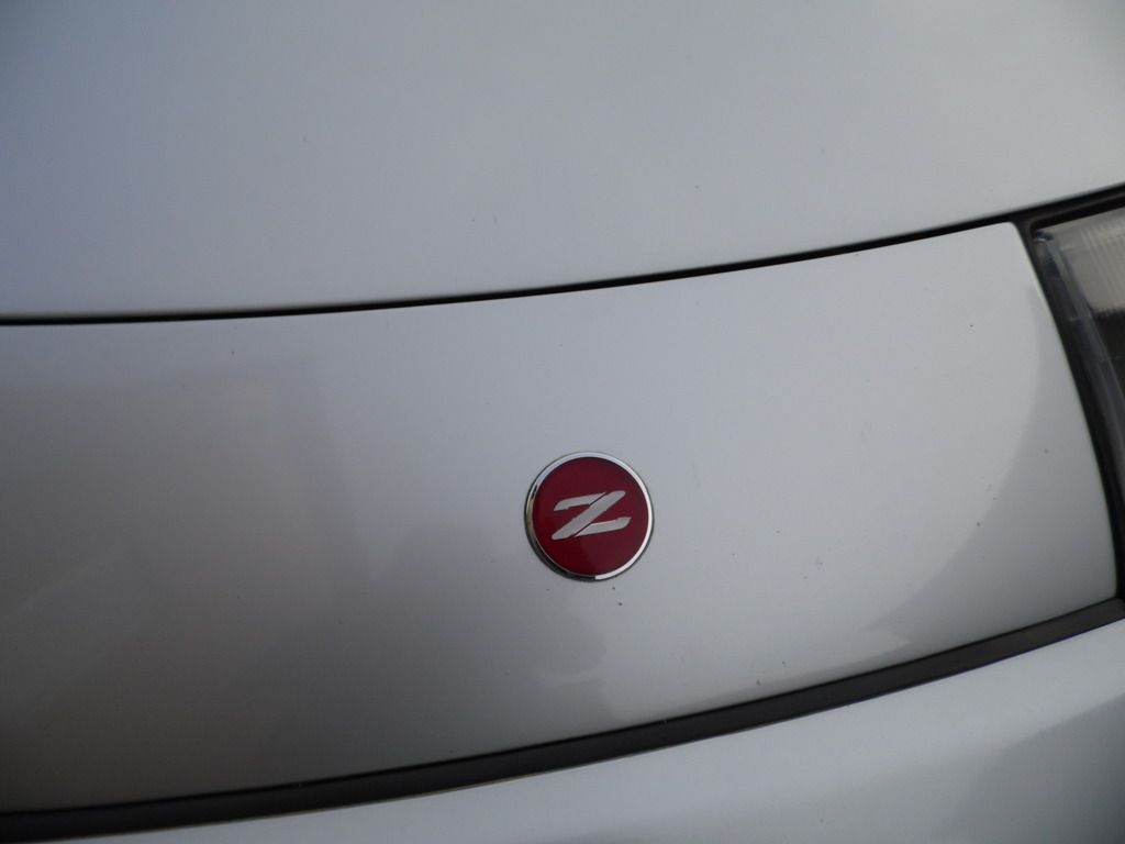

Changed my nose badge to the nice red one I bought recently :)

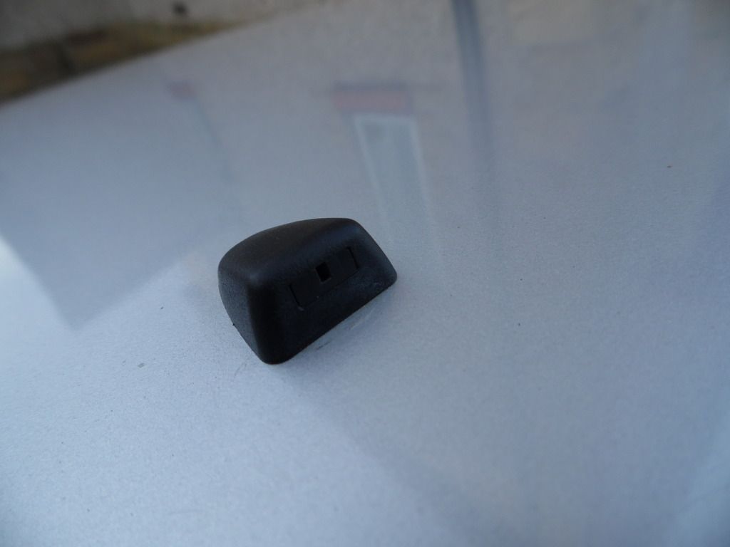

And the best thing I did today, by a country mile, is to change the washer jets!! I replaced them with a pair off a Volvo which give a "fan" pattern over the whole screen, rather than the two poxy "jets" off each original washer. Makes a world of difference to clearing the screen!
I'd highly recommend anyone to make the same change!
And finally, I gave her a damn good wash as I couldn't really turn up at Lee's in a spectacularly filthy Zed, could I...??!

^^^ Can we have some more information on your Volvo washer jet modification!
Which Volvo model are they from and do they fit perfectly?
Volvo part number is 30655605 - I think they're off a V70.
You have to put them in sideways as the locking tabs on the Nissan ones are front and back of the washer underside, whereas the Volvo ones are on the sides. Once they're located in the bonnet apertures, you just turn them to the position you want them to be in.
Best. Mod. Ever...? :D
I absolutely refuse to take a picture or a video of my washer jets in "action"....!! :lol:
Take my word for it... they put the OEM ones to complete shame... :thumbup:

These I assume?
http://www.ebay.co.uk/itm/VOLVO-WINDSCREEN-WASHER-JETS-NOZZLES-S40-V40-S80-/291409443323?pt=LH_DefaultDomain_3&fits=Car+Make%3AVolvo&hash=item43d95b39fb

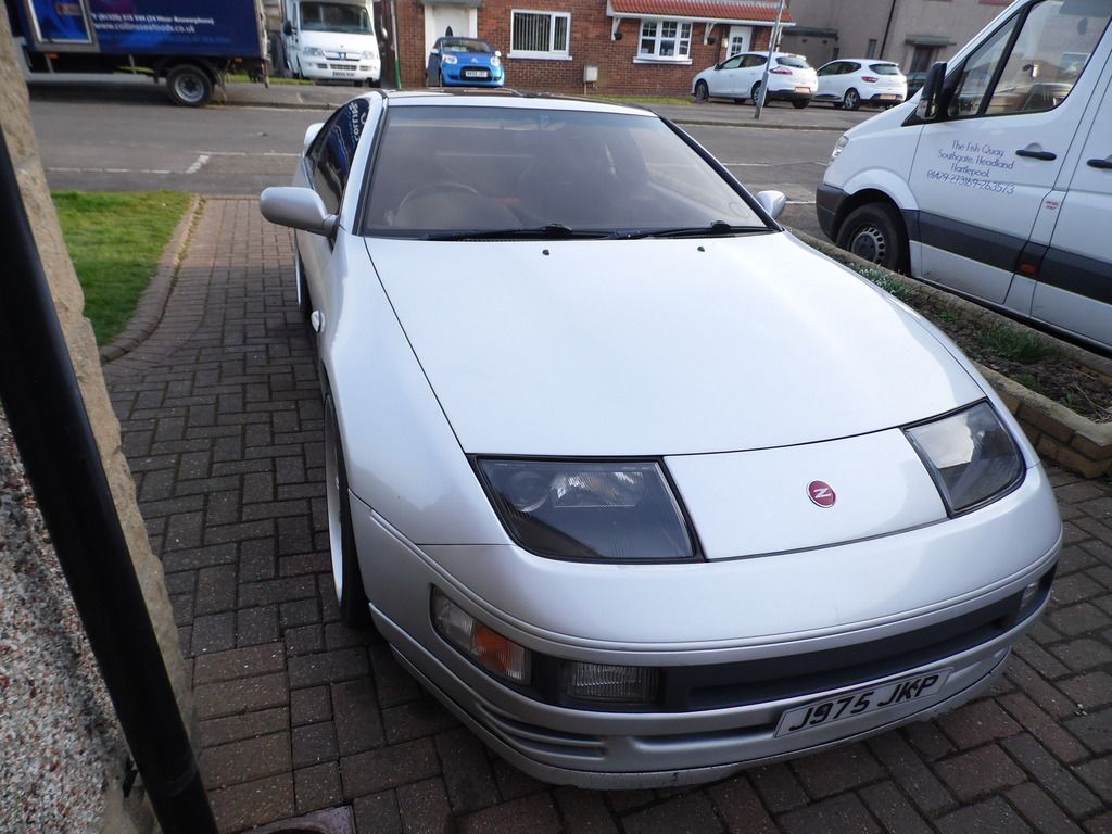

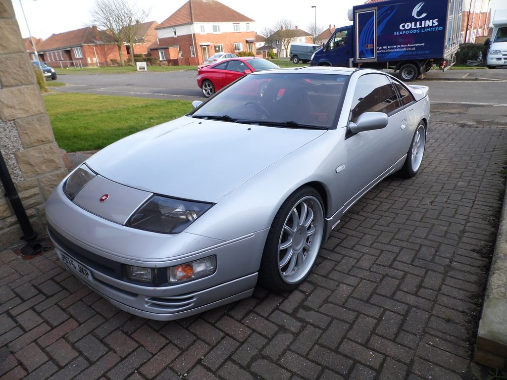

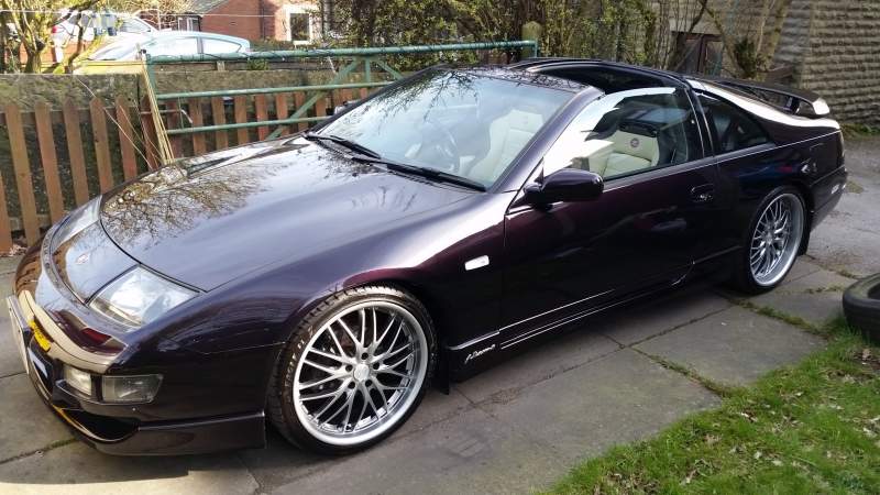

Gave zebedee a 1st pass clean before he attends Mandys funeral on Wednesday. Just some trim black to apply now and if I can get under the back bumper ill give the Veilside evo back boxes a good polish too.20150322_151529.jpg

Red snout badge :)
And a not so great pic of a washer jet! :lol:
Gave zebedee a 1st pass clean before he attends Mandys funeral on Wednesday. Just some trim black to apply now and if I can get under the back bumper ill give the Veilside evo back boxes a good polish too.[ATTACH=CONFIG]86209[/ATTACH]
What a lovely looking car.
Have you tried then when the car is moving at speed (motorway for example)?
Can't say I have. But the OEM ones were fairly poor, or mine were at least, so I'm expecting these to be better even at speed :)
You have done Mandy proud mate.

Do you get that nice little fan pattern?
Good stuff. I might go raid the scrap yard lol. Seems they were fitted to a succession of volvos.

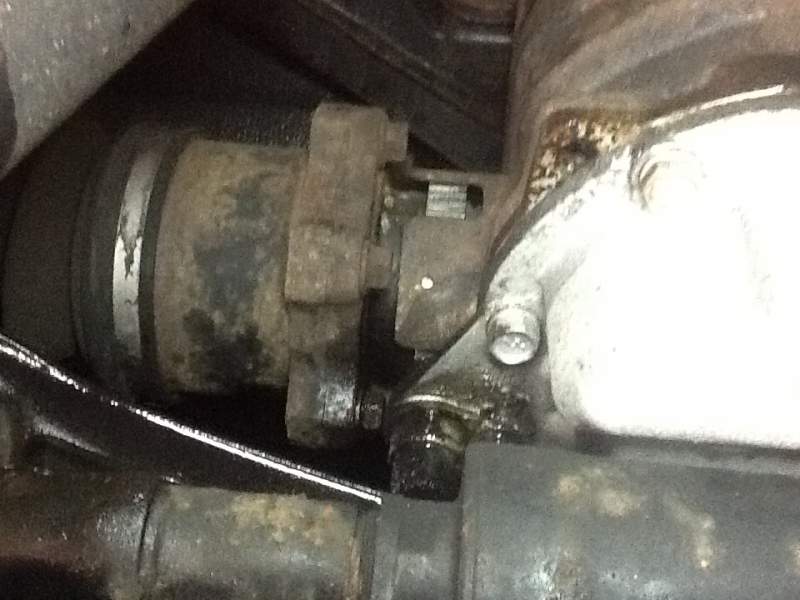

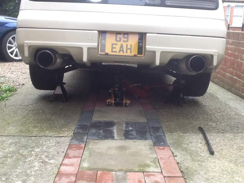

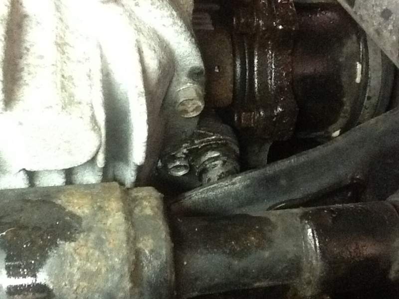

Nothing exciting today! Jacked up the Z to take a look at Dif & drive shafts as I heard
strange sounds in reverse on Saturday!
Think it could be a wheel bearing? But on running nothing heard with wheels off the ground!

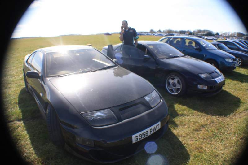

Went to Santa Pod, bumped into a good pal with a Zed!
£50 in the tank, 110 miles done, just under half a tank left. Not bad for nearly 600bhp!
