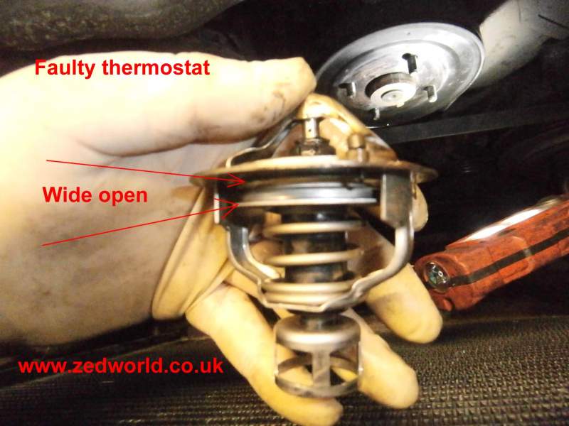

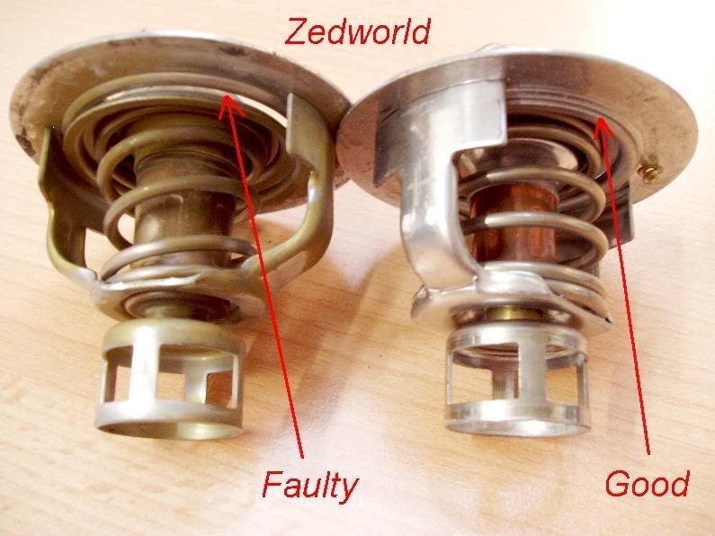

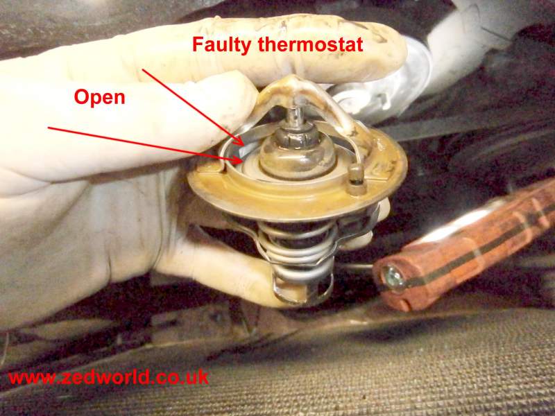

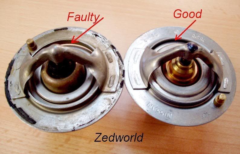

Now take a look at the two stats below, a used and faulty one to the left of the pic`s and a new Nissan item to the right of the pic`s.
Clearly the faulty one is open and as it is at room temperature it should be closed like the new one, and what effect would this have on a zed engine?
Surprisingly a LOT!

Now typically a stat jammed open will have the effect of reducing the engine running temp by 15 to 20 deg c which clearly will mean the engine never gets out of the cold running restriction, add to this the ecu will be fuelling accordingly to the lower temperature which is not good for mpg!
Sometimes a stat although jammed will be only slightly open this then means the engine will actually hover around 70deg c, so full boost is available, until you give it some beans and the extra cooling air and water volume increase reduces the temp by a small amount that is below the full boost temperature, this can end up been a cycle of good boost ...bad boost....good boost ...bad boost.....
The non turbo will of course be less effected, however an engine not running at full temperature is not running efficiently and will suffer accordingly too.
So what's to do? simple change the thermostat, an easy and quick job and full stat “modulation” and engine temperature “regulating” returns and so does the happy engine performance we all crave.

I took the Zed down to Zedworld today where Jeff changed the thermostat - it was indeed stuck wide open!
I haven't driven the car far enough yet to comment on fuel economy, but one thing is certain. I told Jeff that I had not noticed any difference in the car performance when the stat was faulty - but I think it must have been broken for some time and I forgot how the car ran before. It's certainly running better now, it feels more responsive. And it's nice and warm inside!!
So cheers Jeff and all who advised, I'm well happy
Rich
Glad you found the heater warmer and the engine running better, not often to see thermostats to fails open so much as yours to be fair.
