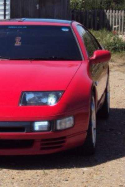

If you want a low wattage H3 bulb I would recommend something like these
http://www.ebay.co.uk/itm/2x-White-Vehicle-SMD-9-LED-H3-Light-Headlight-Fog-Bulb-/271032991219?pt=UK_CarsParts_Vehicles_CarParts_SM&hash=item3f1ad33df3
I have some in on my sig pic and they do look nice and white, however they do not give off much of a beam so sound like ideal for what you're looking for...a sidelight H3 :thumbup1:
............If you want a low wattage H3 bulb I would recommend something like these
That is what I would do personally - pop in the H3 LEDs but instead of them being lower wattage headlight supplements, they would be more like daytime running lights!
Richard:thumbup1:
