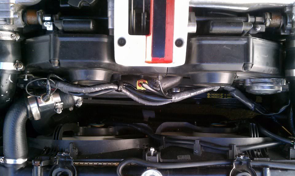

a few of the lads on the US site, removed the fan and added a twin electric from another car onto the rad, looked awesome, he said even in temps of 104F he was getting temps of 88 to 90.
fan is from a 92 maxima (us car) Z1 hose adaptor and a Derale thermo switch
Not sure if you can get these parts imported, but seems to be a big mod in the US.
