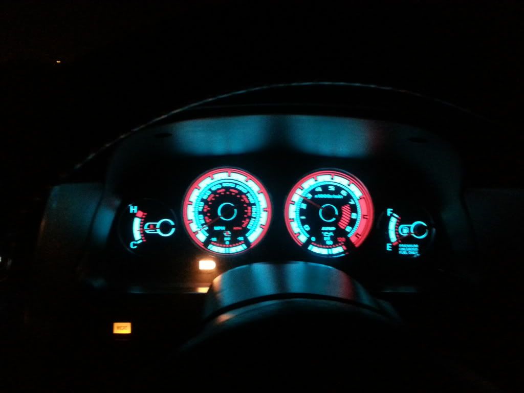

I noticed this tonight though.... hicas light is on and no speed on my dash needle.
its speed sensor related then.
HICAS/PAS uses speed sensor to give variable 'weight' to the steering, proportional to speed.
check connectors on the sensor off the gearbox, and or replace sensor if needed.
More likely the speedo head itself..is the mileage reader moving?
Well, I started this thread some time ago and have just sorted this problem. I was lubricating the steering coupler (called it a UJ previously but the guy who works on my car says there's two such joints (possibly higher up column). Anyway, it's been lubricated and all's well.
possibly the 'speedo head', but that wouldnt explain the HICAS light.
more diagnosis required to be certain.
Hicas is dictated by speed, no speedo creates a fault in its system so it flashes up hicas fault. As the hicas cannot operate propery.
The light comes on after a period of no signal and a speed of over 15mph..trust me i`ve been there twice. The speedo unit converts the pulse generated by the sensor on the gearbox and sends it to all the relevant units including the hicas..so the head is a good bet, usually cured by total resoldering of the board. If your mileage is still counting it narrows down the culprit.
yup, lots to check. I cant see how the HICAS unit can tell if there is both no speed signal AND know when its over 15mph at the same time. That would would require more than one set of pulses surely? or both a speed signal and a logic 'yes im over 15mph' signal from the speedo amp, which i dont see. im curious myself about how this works.
