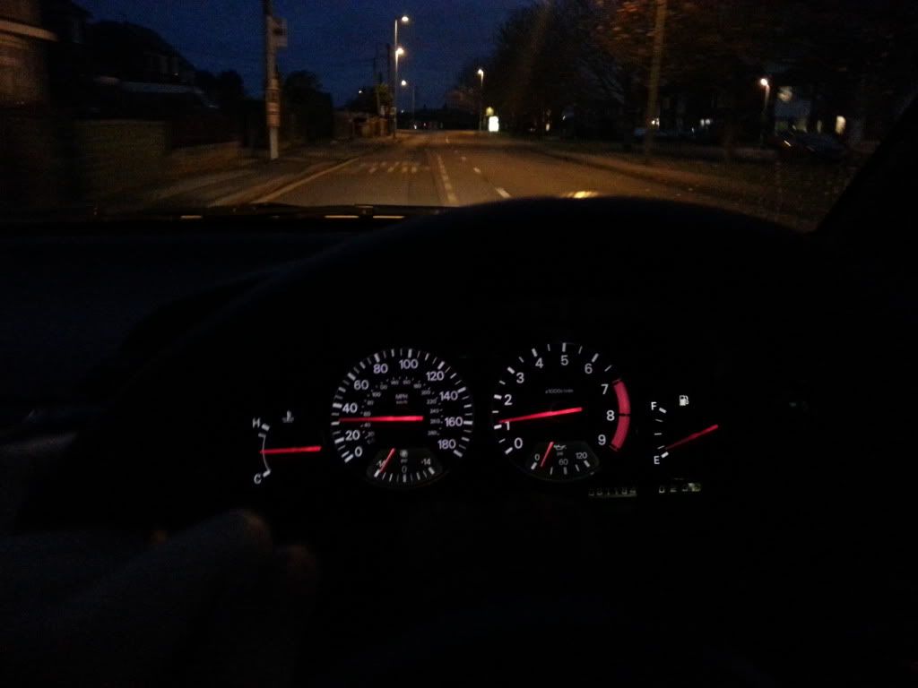

(Re-posted from my other thread)
Good news.
Finally got round to putting in an unmodified/non-transplanted/un-molested looool set of series 2 UK clocks into my series 2 JDM zed and the result is.
Massive respect to all the guys who helped too.
Cheers.
