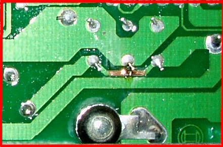

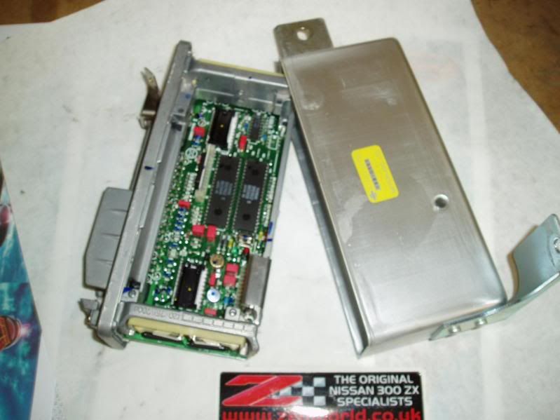

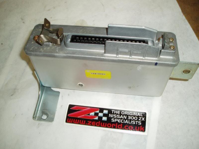

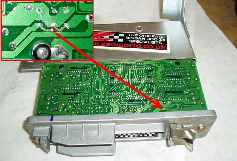

However the abs light was still glowing strong, the abs diagnostic was again done this time the low volt fault was gone but the missing earth to pin 32 was still there. I checked through the wring diagram and identified pin 32 on the connector and made a temporary connection to earth rather than spend time looking through the loom, however the fault still was present, knowing there was no missing earth it left only one possible fault and that was the ecu, you can see what we found in the pictures below, there is a blown copper track that although not directly connected to pin 32 it was part of a circuit fed from it, a repair to the track could of been made but with some overheat marks elsewhere it seemed better to raid our stores for a good used item, surfice to say a new unit cleared the fault and the abs light.
