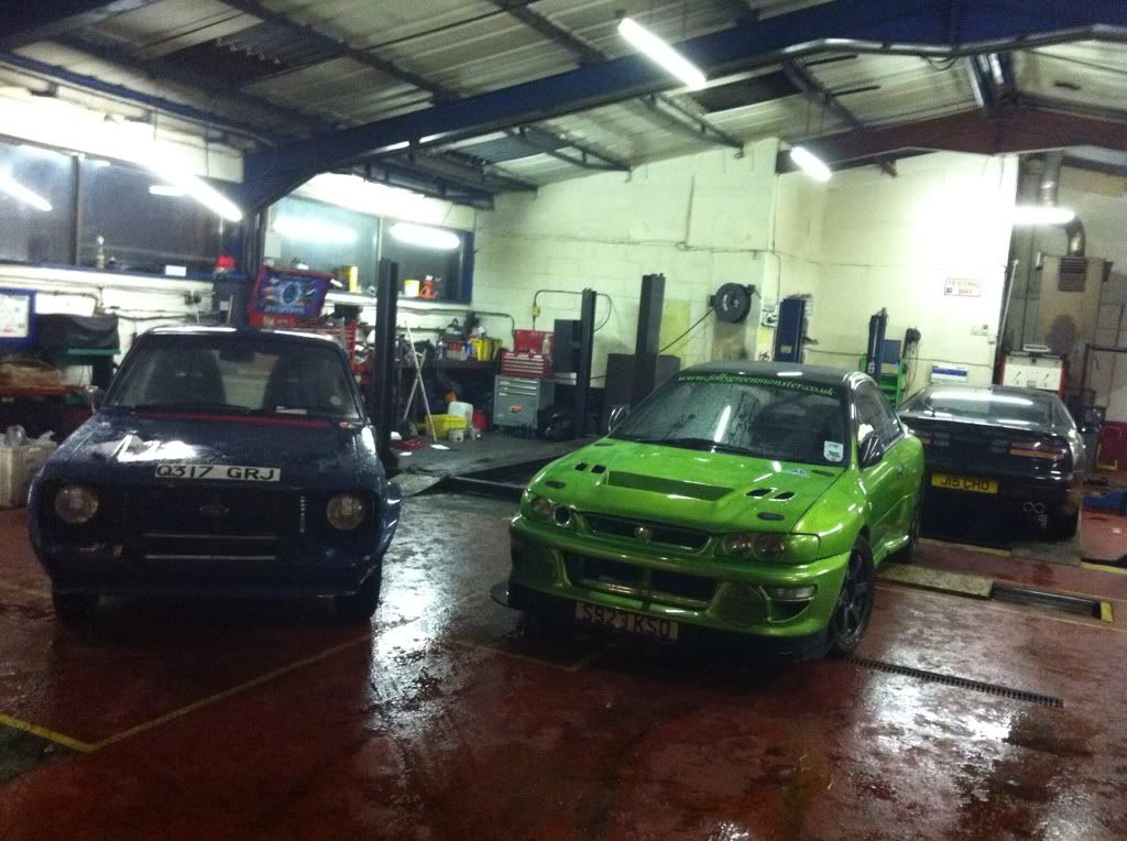

Bob the Subaru is awaiting the engine to go back in and Rob who owns it became a dad this morning when his wife gave birth to there daughter!!!:clap:
Don’t think we can finish it this week now!! LOL

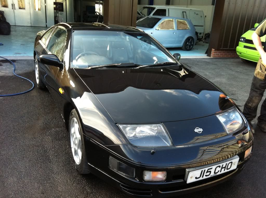

Well she’s in the body shop now and hope to have the car back for March and enjoy so I will let you know where I'm up to as and when.
  • 3 months later...
looking great mate. cant believe it was laid up for 11 years!
very nice daz :yes: good work mate!
Thanks, really happy with the job they have done and can’t wait to get it back to the work shop and do the last few jobs and drive it.
As with all projects you have a plan and add at least 6 months!!!
Guy at the body shop said the shell was really solid and he was amazed at the condition of the car.
Just need to fit the rear spoiler and then go through the brakes again, new windscreen and paint the wiper arms and replace the wipers, go through some plastics and then game on, do the rest of the list while I enjoy using the car.
