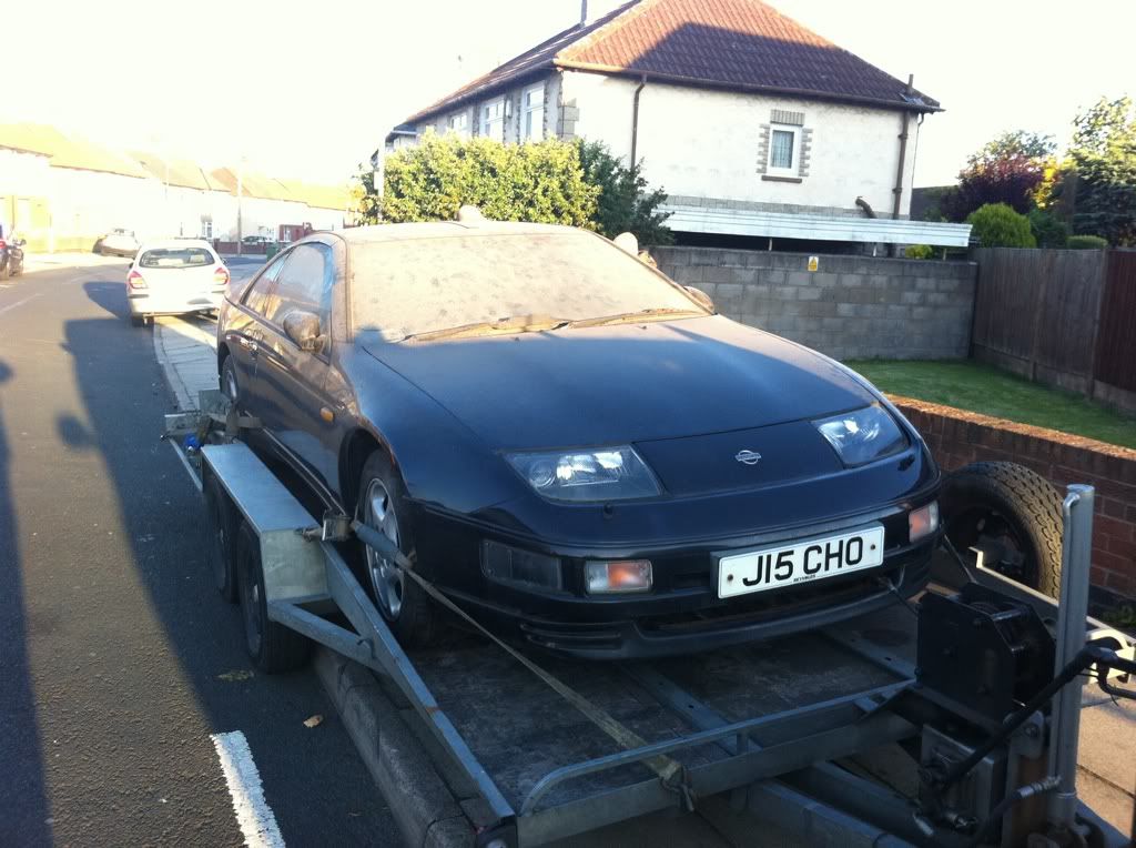

Cheers guys I have pictures but there not up yet, will get some up over the weekend, as I said it's a barn find and requires some work, worst bit being a sill repair and some paint.
The car had sat under a car port for 11 years on ramps, now it my turn to bring it back to its original condition and performance so keep your eyes open in wanted and for sale!!! LOL

Welcome to the club buddy, get some pictures up, its the law lol

Welcome to the club mate, congrats on the find. Sounds like it could be a really good motor. Like everyone else said, pics! oh and get subscribed, it's well worth it.
looks good that does matey, get it a good clean though lol :D

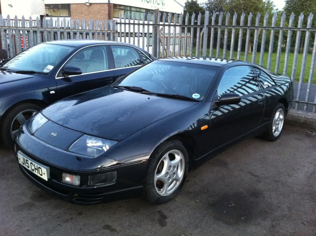

EDIT, damn it, you posted a after picture as i was replying.
Looks a lot better now its clean

Bit to do yet but I hope to be on the road in about 3 weeks then it's bodywork time the bit I hate!!!!!! :-(
Welcome to the club Daz, i have to say, considering it was sat for so long, it looks to be in good condition, ive seen worse for sale thats not been stood for 11 years lol

strange to see the rear spoiler missing ? ...looks straight and clean ..a good find ther Daz and welcome to the club matey...see you at ten of the best if you go :)
