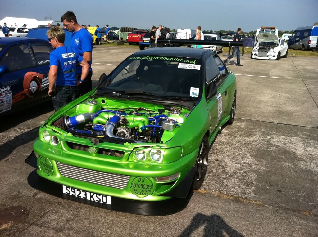

Some of my current projects I work on......
