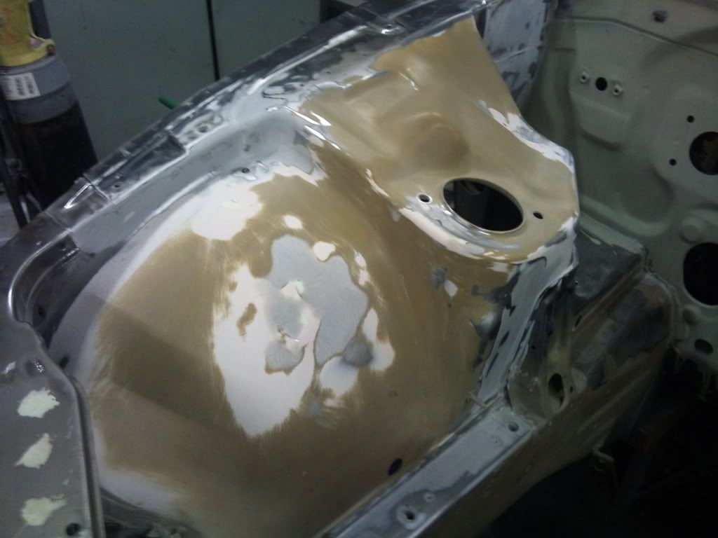

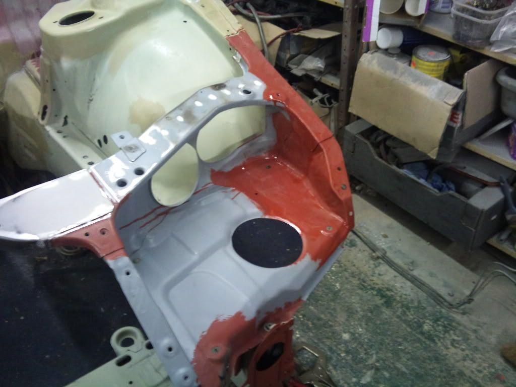

for anyone who is interested here are a few snaps of where im up to on my restoration/customisation. ive mainly focused on the engine bay as that is what im doing at the moment
engine bay was taken back to bare metal, this is just about the last of it

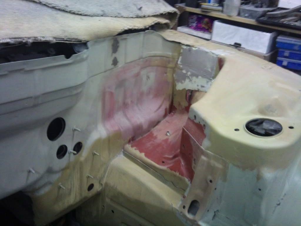

pas pot has been moved to here

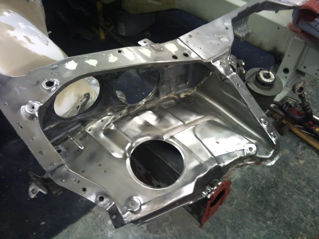

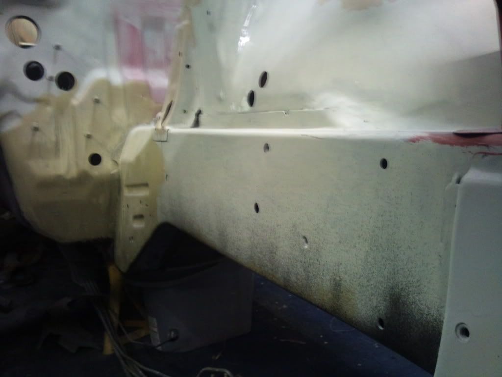

to here, hicas has been removed, inner wing deseamed/smoothed. all holes have been welded up (except a few that i still need)
same goes for this area too, there will be nothing here except the brake servo/clutch master cylinder
Alot of work has gone on in this area, the battery tray has been removed which revealed a few holes where the battery had leaked, the upper suspension mounting had also had a bit of a bash at some time and had distorted the reinforced panel. i cut out the whole panel in this area and replaced it with one cut out of my breaker. all spot welds drilled out etc and welded back to look factory-also checked to correct chassis dims. you can see which panel i mean as its red (weld through etch primer)
same goes for the passanger side, i have replaced the headlamp pod aswell, it had been repaired to a good standard but i was not happy, it would appear my breaker had a bad bump (bent the chassis rail) but they had replaced the headlamp pod with a new nissan item so this was grafted onto my car aswell. all looks perfect now. the fusebox will go under the nose panel on the inside of the chassis leg opposite the pas pot
both chassis rails have been given the smooth treatment too

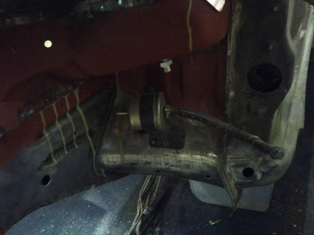

fuel filter has been moved down here where all the aiv stuff used to live, the stock fuel lines have been tweaked to pop up under the chassis rail where you can just see the little notch. the fuel lines will then go up through the panel above (where battery used to be). ill use a jic bulkhead fitting here so in the engine bay i will have aeroquip type braided hoses with propper connectors in stealth black onto an adapted fuel pipe.

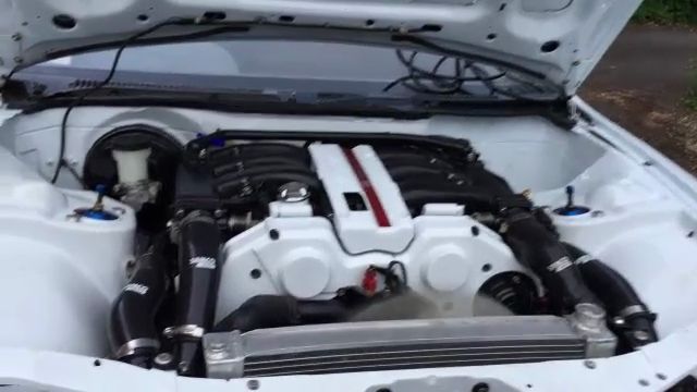

tomorrow i will spray the bay in a final coat of etch, then seam seal a few bits. might even get on to giving it a coat of 2k high build. Colour will be pure gloss black. im going for a very stripped out look in the bay, no wires showing and nothing but the engine to see. colour scheme will be stricktly black and silver/chrome/pollished aluminium.

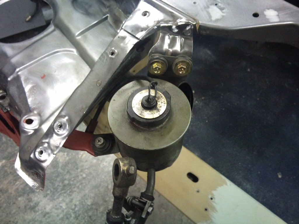

A little update here for what I did with the power steering
Obviously with the engine bay shave look, the standard reservoir had to be moved.
Although the car is a series 1tt I have deleted the hicks altogether. First stop was to get hold of an n/a setup which is very easy.
I decided to located the reservoir under the nose panel as its easy to get to and above the pump still.
I actually reused the bracket from the engine bay.

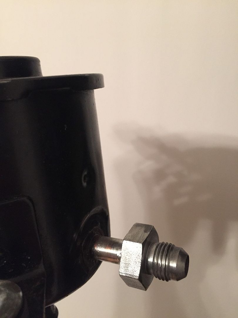

Moving it is easy, getting the plumbing right is harder.
To get the return back I rerouted the standard hard line with a new rigid line. The piping is goodridge 10mm alloy hardline with a gloss black coating. Here it is next to a cut down stock line
And here is the AN-6 fitting on the end, fitted with a flair nut
The pipe follows the standard route using the stock clamps (replayed of course) then heads under the nose panel. I left a bit of float towards the end of the line as I am running rigid line all the way to the reservoir.
To attack the pipe I machined down an adaptor to fit over the 10mm inlet, like this
And then braised it on
Easy, now there is a simple neat connection.

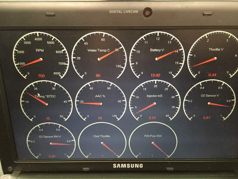

It runs- with a misfire and belt noise. But it runs!!!
Well done! Always a good feeling that first fire up. Niggles are always to be expected, mine did the same. Caused me a few hours of testing and head scratching but it was a simple one in the end.
