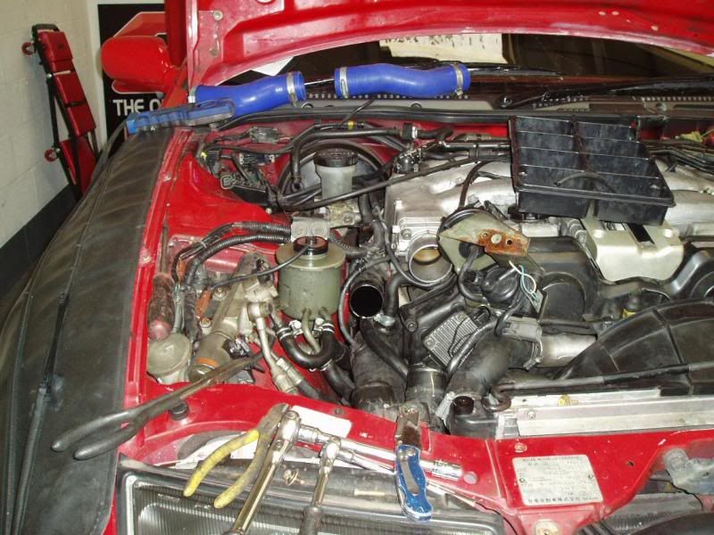

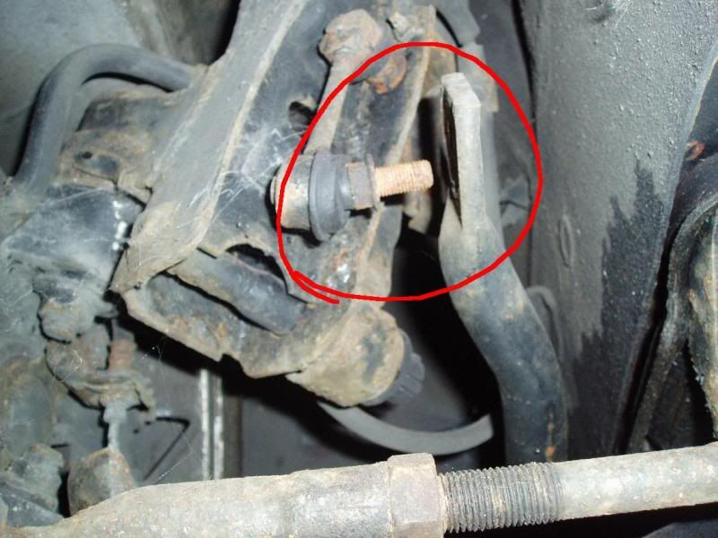

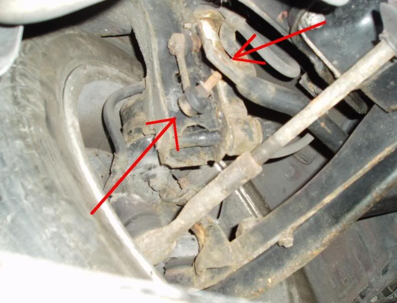

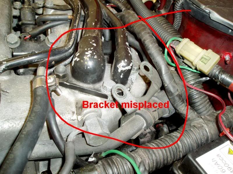

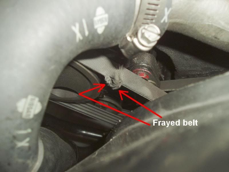

The photo`t below are just a sample of what we have found and have to correct, but added together tell a sad story.
With missing gearbox bolts, missing engine to bell housing brackets, missing oil pipes, missing pipe brackets, wrongly fitted vacuum pipes, blanked pipes, timing issue, wrong dipstick fitted, overfilled, damaged ancillary belts the list goes on and on, but the front anti roll bar drop link been disconnected beggars belief.
So a few days of correcting the issue should see what actually seems to be a fairly good engine that was just fitted poorly running correctly as it should have been in the first place...oh and the real pi?? take was the cost??? over
