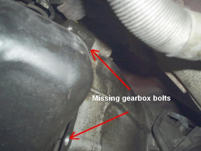

Paying with hard earned cash for lazy work is insulting to the person paying but some garages seem to consistently get away with it.

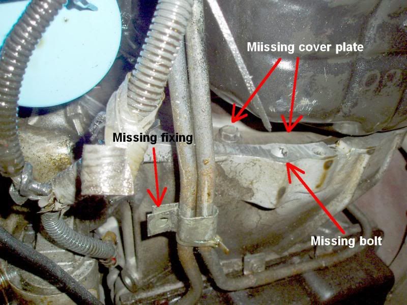

Case in point, a zed in at the moment having had a replacement engine recently at a garage that advertises on ebay.
Following the fitting and collection the car broke down ( over heated ) on the return journey and so went back for more work.
The car was collected again and ran but in the loosest of terms, as the car was used more it got worse, the owner had another garage look at it and they found many air and boost leaks, correcting as many as they could find the engine ran much better.
But oil and steering leaks made the owner take another look and he discovered the engine supplier / fitters had not connected the oil cooler supply pipes to the engine at all (linked out) having used the engine oil cooler for the autobox...very clean eh?
So he added a separate cooler to sort that out, the engine supplier was again contacted and their reply was it was an import engine and they did not have the facility for the oil cooler ????????????
So with further running issues and the engine supplier not playing ball we were contacted and so sent the recovery truck to go get it.
The photo`t below are just a sample of what we have found and have to correct, but added together tell a sad story.

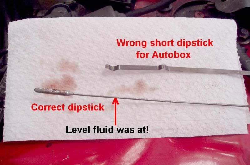

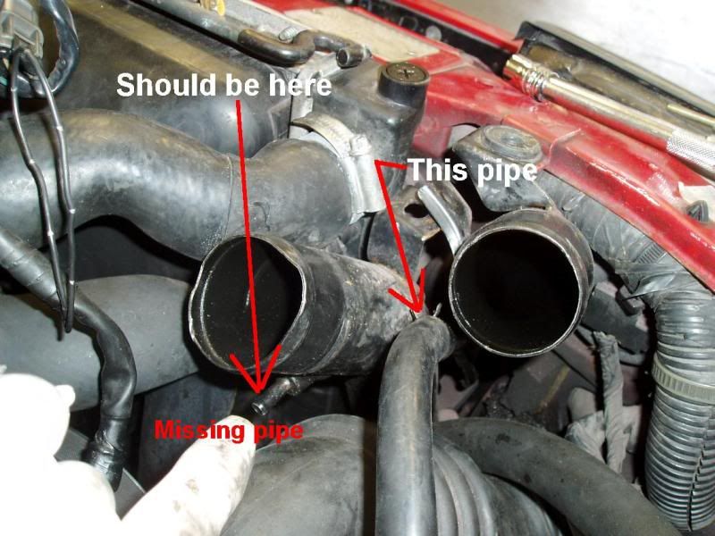

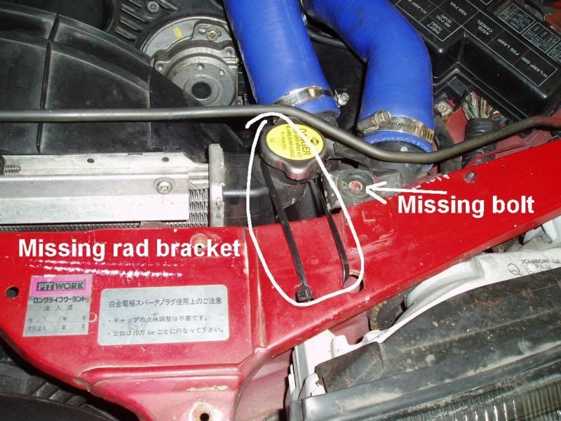

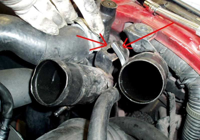

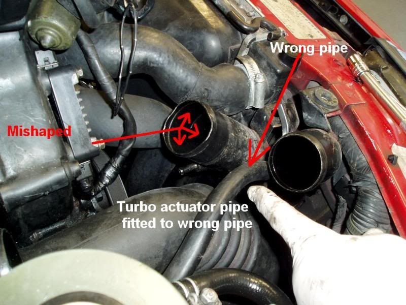

With missing gearbox bolts, missing engine to bell housing brackets, missing oil pipes, missing pipe brackets, wrongly fitted vacuum pipes, blanked pipes, timing issue, wrong dipstick fitted, overfilled, damaged ancillary belts the list goes on and on, but the front anti roll bar drop link been disconnected beggars belief.
So a few days of correcting the issue should see what actually seems to be a fairly good engine that was just fitted poorly running correctly as it should have been in the first place...oh and the real pi?? take was the cost??? over
2K!!! jeeezzzzzz!
Be careful out there.

Thats shocking,the cas position is awful,probaly 30 degrees btdc,car must have detted to hell like that.
Yes well noticed, given the o/s turbo actuator pipe was wrongly installed the turbo was unrestricted.... a recipe for disaster, lucky the massive boost leaks prevented that happening.
