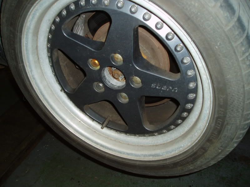

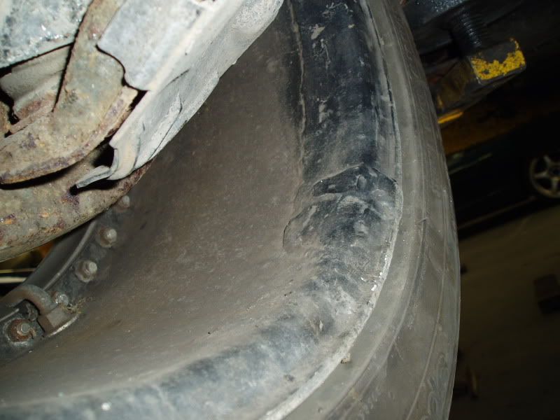

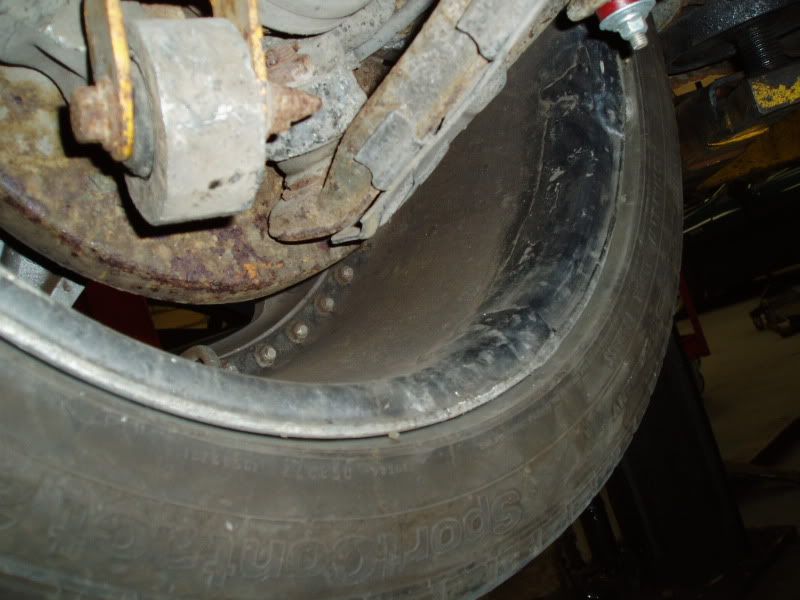

No surprises that alloy wheels can be repaired but how far do you go, check out the first pic of an innocent looking wheel, but the following two show a repair to the rear of the rim which is eye wateringly large, spoke to the owner who had become aware of the repaired wheel only after purchasing the zed.
We discussed the ins and outs of the repair and came up with the view although messy looking it was had been some time ago and was very securely done and all balanced up..... but new wheels soon as really.

No not good, did he report any issues poss vibration etc, hence why he brought it in?
Woah! That's shocking! That must have had some serious damage to it to have had to have had a new lip grafted on! Christ on a bike!
No, I found it during a new owner assessment, and no vibration, the rim weld looked very thick so you would expect it to need a truck load of balance weights the opposite but no.....very odd.
Jeff TT
Jeff TT
first thing i thought!, is the owner now deciding on new wheels then?
it does look heavy duty but not forgetting theres not really a lot of weight there if its aluminuim welding and it might be ballanced by ally welding inside the rim under the tire on other side
Yes good points.

That's my wheel! Lol. There is some vibration about 40mph but I thought it was the prop support bearing on its way out. I do love the wheels and was hoping to get them refurbed but will have to find a way of getting this repair checked out first. On another note - Jeff informed me that my tension rod bushes need renewing - whats the recommended replacement? Poly bushes?
