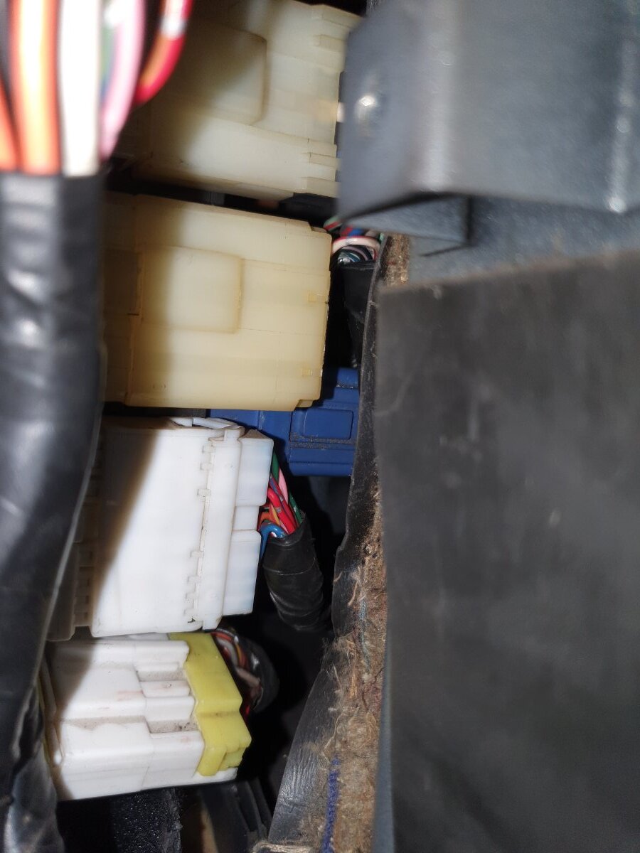

Every thing on my aircon pod, apart from my hazard light is dead? It's only that pod everything else works as intended? Iv checked all the fuses an none are blown is there a relay for the side pods I've missed somewhere? Was hoping to put the car infor it's Mot next week, but there is no point until I get my wipers working again.
Is there something I've missed? I've checked the fuses in the drivers foot well and under the bonnet but can't see anything else.

    Proud to say that this definitely works, it took me 4 days, and all new relays, and we had to crack the fuse box open and blast all the metal prices in it. These guys from 15yrs ago are a complete lif
Proud to say that this definitely works, it took me 4 days, and all new relays, and we had to crack the fuse box open and blast all the metal prices in it. These guys from 15yrs ago are a complete life saver. The tips i have from people doing this is take your time, and when you go to crack the fuse box open you have to drill out 2 rivets holding it in. Also take a picture of everything, and when you take the 3rd layer off make sure you take a picture of the fuses on the back before hand. Use dyeletric grease when you putt it back together. Also the small blue relay with the LC writing on the fuse box, you cant find it anywhere its a discontinued item. All the other relays i got iff amazon and they work great. I ordered a new pod for 300$ and then tracked it to this issue, dont make the same mistake lol.
