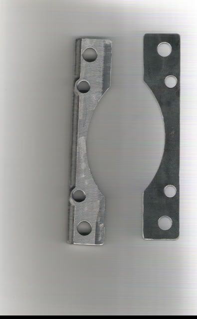

Change that lol, I actually scanned the brackets before fitting them, I will stick them on photobucket tonight

Hi Quavey, Funny you wrote this as i have just done mine today!! heres some pics to help you along if you were unsure of anything, I have used Evo Brembos and 350z discs for the fronts.
There are a few things you need to chop off the hub and you will need an angle grinder with a thin blade, but quite easy once you ve done one.
Chop the guard off, one cut with the grinder and twist it off

chop the top lug off
Bracket needed

No Phil, the drawing is for the evo brembos and 350z discs, I know this as I purchased the lot from Madmax who purchased the car from krsmayo who originally posted the drawing. if that makes sence!! :wacko:

Cheers guys! Thank you for the responses, I did find that diagram Legrath but it does say on the post with it that one of the dimensions is wrong. I need this to be a bolt on job so it all has to fit on the day I go for it...

If no-one comes up with the correct dimentions, i will take some measurements from mine and i could get some made if need be :wink:

Now you mention it I seem to recall 2nd diagram being posted....with corrected info.....cant find it though :-/
mine are nothing like those lol
scan.jpg, these are using the evo disks not sure if the 350 and evo disks have the same offset ??
