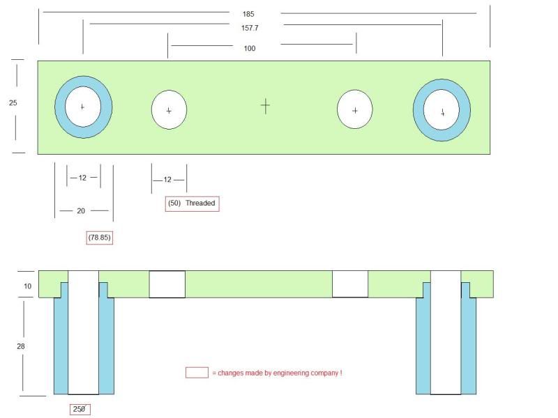

Also want to do the Evo Brembo upgrade, spoke to a couple of people about this and basically I'm looking to have some brackets made to suit a 350z disc. There are a couple of drawings floating about does anyone have a definate drawling. Or even fancy getting some made up :D Im sure there will be a few people who would like some too... Group buy anyone?!

I did find this diagram:
Is this the later one?

To be honest I wouldn't like that stopping power hanging off those extended tube's
That's what I thought so machined mine out of a single piece of high tensile plate
That would do it :thumbup:
Its not. Because they are bolted straight through to the main support, all those extensions really do is act as spacers. If they were to actually sheer away from the main plate itself it would'nt make any difference.
You cant ignore the fact they are out on a spacer, if you took it to an extreme and moved them a foot away the twisting force would be huge, its never going to be as good as a single block but hey if folks are happy with them
Hi Guy`s, This new diagram posted below is the exact dimentions on the bracket I have fitted and works fine, you will notice I have altered it slightly and labeled in red
you will also notice I have now put my calipers on the right way round:cool3:

Dazvert i would get some stronger bolts than 8.8s for that job, i used 12.9 just to extra safe.

WOW300, am I being totally thick... when you sat 12.9 vs 8.8 bolts what does that mean? Could you tell me what bolts you used?
Also who fancies getting some of these made? Or shall i just take the drawing to an engineering firm? LOL

Thanks mate, I did get stronger bolts
I forgot to mention that! The old bolts that come off the stock calipers are now too short as they are going through the new bracket, AND the thread is different on the Brembo`s, I just took my calipers into my local bolt shop and told them the length i needed and asked for high tensile ones, If i remembered the sizes i would say but i forgot :wacko:

8.8 and 12.9 refers to the tensile strength of the bolt. 12.9 being stronger of course

Tensile strength and permanent stretch percentage.
