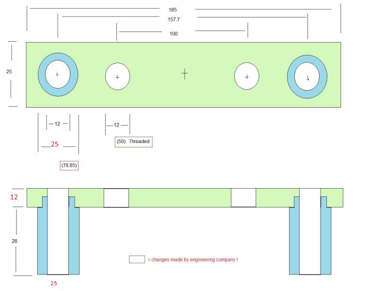

Also want to do the Evo Brembo upgrade, spoke to a couple of people about this and basically I'm looking to have some brackets made to suit a 350z disc. There are a couple of drawings floating about does anyone have a definate drawling. Or even fancy getting some made up :D Im sure there will be a few people who would like some too... Group buy anyone?!
