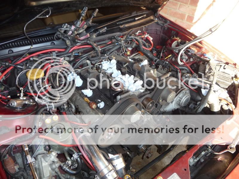

Andy - was it a case of threading the cables up through whilst re-fitting the plenum - or just poking them in and fishing them out with a bit of bent wire [afterwards] kinda process? I would like to keep as much 'out of the way' as possible whilst fitting the upper plenum as there is a HIGH RISK of trapping a wire or something and then - decending into hellish diagnostics, leaks, blah blah - plenum off etc... :punk:
Hi Andy,
The best way to do it is as follows:-
While the plenum is off mark each one of the old connecters 1-6 as per there position on the engine.
Mark up the new ones 1-6
Strip back all the electrcal tape which makes up the loom as far back as the back of the block near the bulk head.
Carefully note which wires go where into each connector and solder the new connectors onto the old wires.
You should now have all the old connectore (numbered appropriately)replaced with new connectors and much more legnth on each wire.
Now lay the new wires on top of the rocker cover where the bootom of the plenum will fit (if that makes sense) and connect the connectors in their appropriate locations.
By now you should be starting to see everything come together. You may want to do this as you go along as I think i seem to remember trimming back one of the wires at the back near the battery.
Now you need to insulate the wires using self amalgamating tape and electrical tape and you will now have your own custom made loom!
I then taped the coil pack wire in place to the parts of the rocker covers that stick up leaving a tab to remove later when plenum is fitted. I might have some photos of this at home.
It is a pain in the arse and it takes some patience but IMHO is well worth the end results.
If you ned a hand just give me a buzz 07843 425220
Andy
