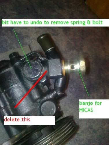

actually just read it,
the black bolt you have to undo to remove the piston & spring, you just put that back in all the way,
they have removed this part already & missed it out of the pic.
(bit pointed to in red)

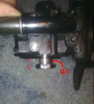

right ive opened up my new TT pump.
i cant see a spring come out? nor a piston in there?
this is what it looks like in there
has it already been removed? or is that the piston right at the back (doesnt seem to spring back tho?)
secondly, they say to put the existing black bolt back in, but it wont go all the way back in? its not threaded to the end, and fluid will leak through it as its a banjo bolt!?

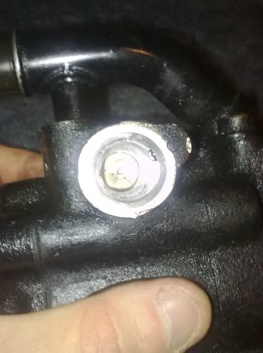

In the 2nd picture - I believe that maybe the top of the piston in question - you need to 'pop' it out - just to be sure if you poke a screwdriver in there - it should move up and down! I guess it could be seized!! I had to drill a hole in mine and screw a self tapper in to pull it out - not reccomending same but... :batman:
Who said the banjo fixing bolt would fit after removing the banjo?? Never seen that anywhere? :ohmy:
ive pressed it quite hard with a screw driver, doenst budge. asume its seized then? will try force it out now.

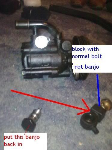

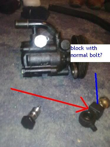

after you remove the banjo bolt & remove the spring, what do you put in there then, just a normal bolt isit?
or do you have to put this thing back, and block at that end?
Slow down, check the new pump against your old pump (if you have one) compare then act. Can't tell from the pic's what the status is so take care.
I don't know what others have done but if you look at my original post - I have replaced with AN fittings and just capped it yes.

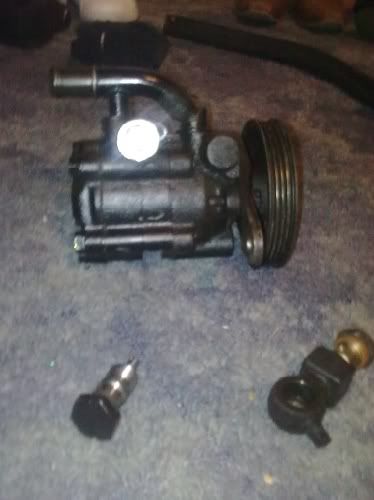

the pdf is a little unclear on re-assembling.
you need to put this back on and use the origonal banjo which is by the piston/spring,
then put an end cap or a normal bolt at the point where the hicas pipes connect.
PS my piston is in there :)

My interpretation of the pdf was that the user was looping the HICAS line - not blocking it off with a bolt or any other way. As per Jimmy's post or the Z1 write up here:
http://www.z1motorsports.com/imageGa...mName=album248
Or Stellaz effort here:
http://www.300zx.co.uk/forums/showthread.php?t=117337&highlight=hicas+removal
Hope that helps matey. Happy New Year.
yea will try and do the same then, dont want to just drill the piston out completly or metal shavings will get all in the pump.
yea the pdf just seems to loop it all back to the pump,
i perfer the minimalistic aproach & get rid of everything un-necessary :)
