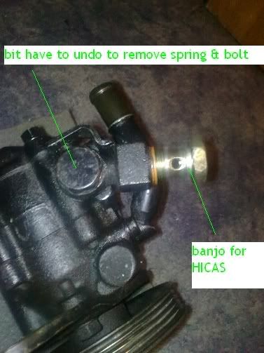

im going to be fitting my new TT pump next week,
ive got rid of the HICAS.
the pump itself has 3 take offs, 1 for the HICAS, 1 for the steering rack & one for the resivour.
1) is the HICAS take-off high pressure? i need to block it off, wana make sure it seals & doesnt leak.
when the garage did it for me before think they put a banjo init, but shortly after the pump died (leak elsewhere)
2) how do you undo the banjo bolt on the high pressure take-off?
3) do i have to seal them when re-fitting the banjos?

1) The Chamber you want to block off is the one furthest away from the pulley.
2) IIRC, you need a 24mm spanner and some way of holding the pump.
3) Im in the middle of looking into this. The thread on the banjo bolt is m18 x 1.5mm pitch (18mm Metric Fine). I've found a die so im going to make up something to replace the banjo bolt.
You'll need to remove the rotating element and knifes from the HICAS side aswell. If you dont and block off the pipe, the pump will pressure lock.

My understanding is that
A - goes to the steering rack
B - inlet from the PAS Pot
C - outlet port to the hicas
Shrek - it's M16 not M18 - or at least it was on mine. :innocent: :clap:
Having devaned the pump as above - I have capped 'C' with an -8 end cap terminator.

my car is NA, so it doesnt have the HICAS solenoid/pressure pipe.
i have a TT engine & pump tho, in the NA car.
so C is the take-off for the HICAS, i just block that off.
why do you have to remove the piston & spring then? i didnt do this on the old pump, is this why i have broken mine?
says in the pdf that the pas fluid can back up pressure if you don't. Haven't done it myself so don't know.
Yeah the pump will lock up if you don't de-vane sir. (According to sites in the USA)

Remember to use the PTFE hose on the high pressure side. It runs at ~80bar so the normal 200series stuff is marginal.
was thinking this,
on that PDF, they have kept the banjo bolt, and Hicas pipe which connects there, and just ran another feed to the resivour?
can i just stick another bolt that goes all the way in will do? (the existing banjo bolt will onjly go in half way)
