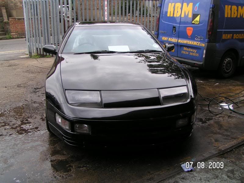

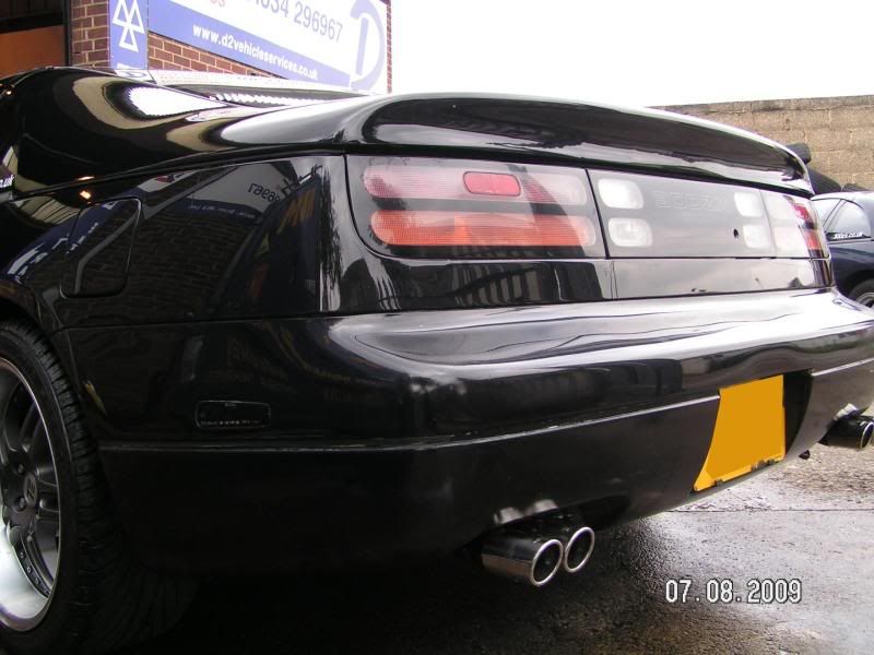

Heres a couple of dodgy quick pics to show ya..... but Darren has taken more pics of the process stage by stage...
once i get a copy of these i'l post some up if anyones interested
Also had a tailgate skin fitted and blended and my rear wiper removed and smoothed.....
looks loads better imo... just gota finish smoothing my rockguard and get my new wheels on then im all set for JAE :nana2:

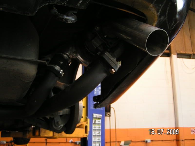

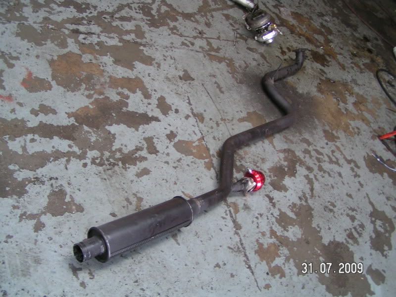

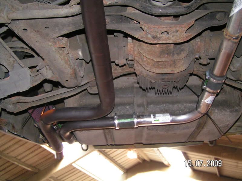

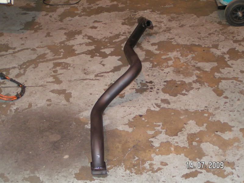

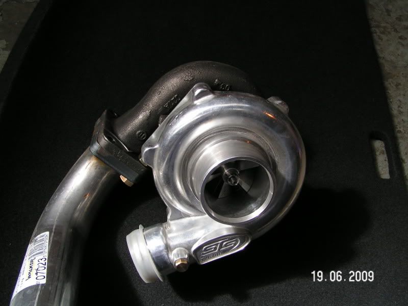

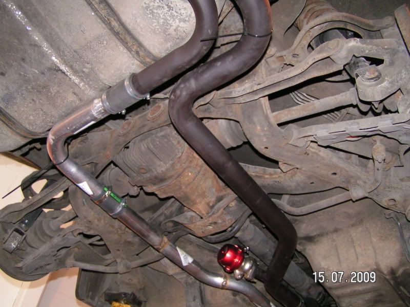

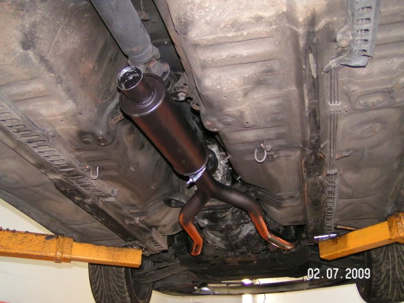

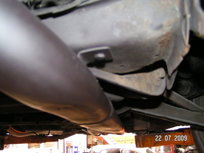

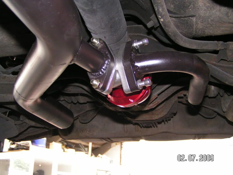

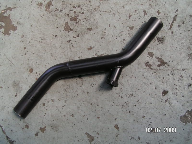

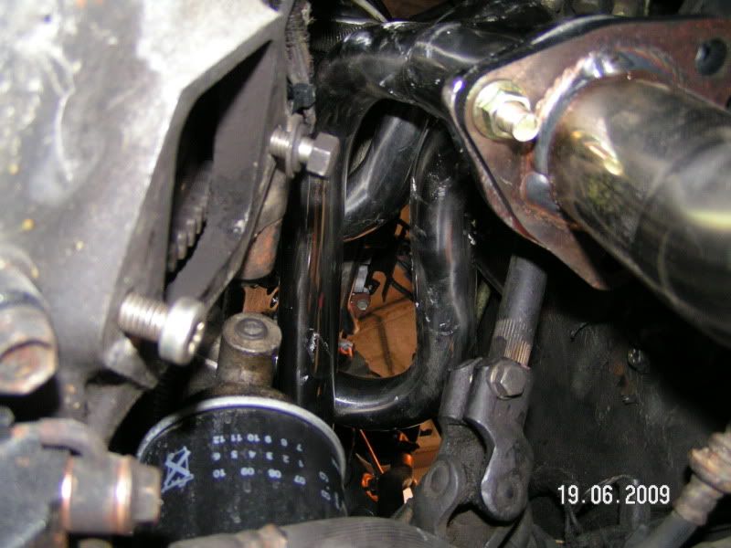

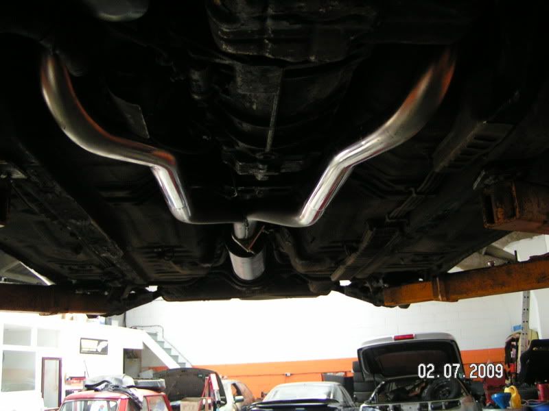

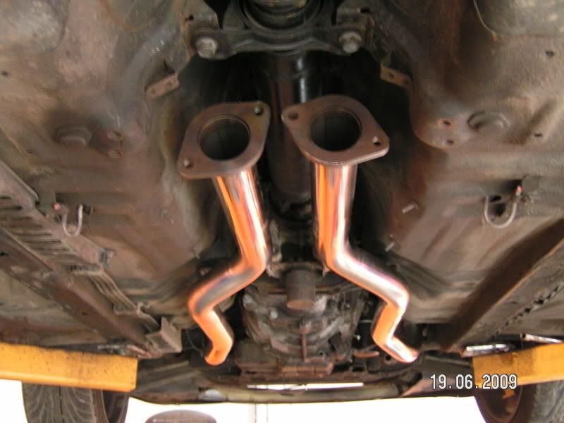

Here we go........
and more
Not a trace....
Edited by 300zxy

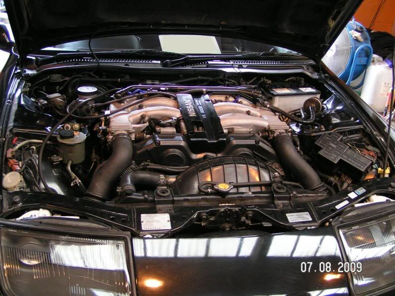

That's a really neat install! How does the MAF figure in the equasion though? is it suck through or blown through?
You got me thinking now...... How about adding a big turbo to a stock turbo'ed Z, stock turbos for 2,500~5,500 rpm and the bigger rear turbo for 5,500++rpm!
Damn... this might just cost money LMAO
The maf is blown through. You could fit this whole setup to a tt without changing anything under the hood. Already thinking also about a tri turbo setup lol.

That's ART that is...(pipe work) is that designed on a CAD system them made to order or just made 'on the car' so to speak? Beautiful stuff either way.
