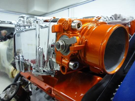

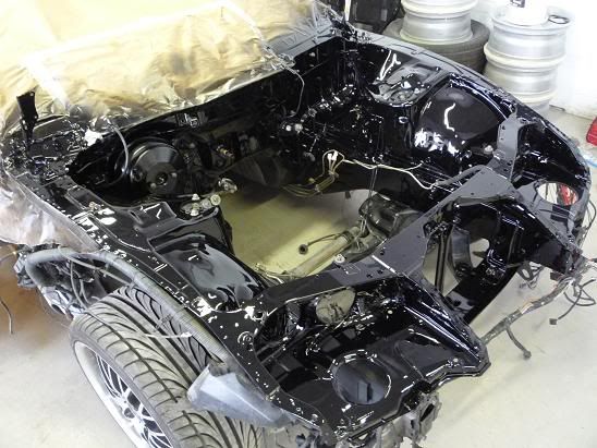

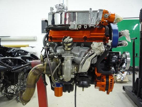

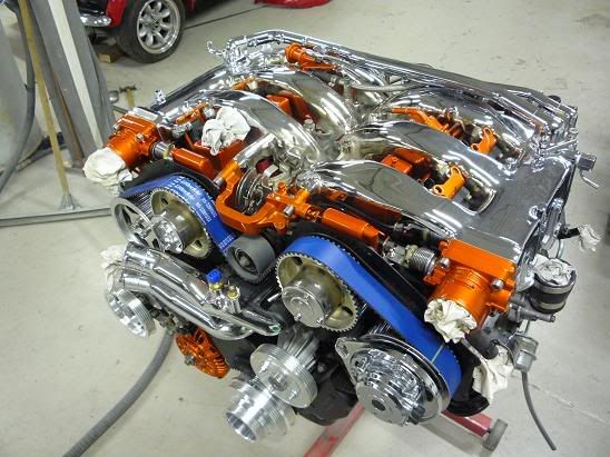

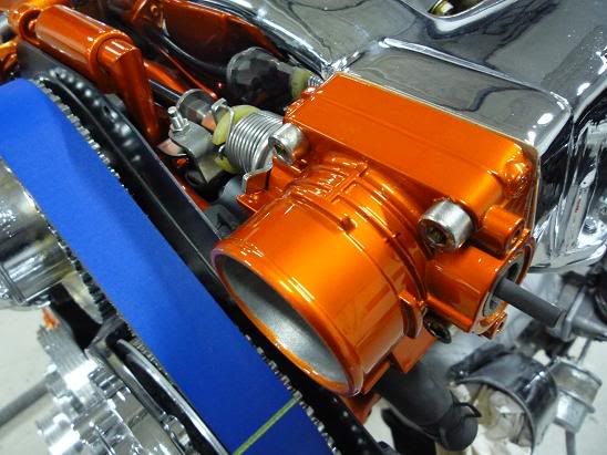

Thought I would put up a few more pics.
The engine is virtually ready to go in, just need to bolt on the flywheel, clutch and gearbox. I'm really liking the candy orange on the engine parts, the cambelts will be covered so you won't see the blue.
The engine bay has been smoothed off and sprayed black.
Also I forgot to say that I relocated the main fusebox about a year ago, trying to simplify the engine bay and declutter it. The battery will be going in the boot and I will be relocating the fuel filter too. I stripped the throttle linkage down and cleaned all the springs etc which I think make a really big difference.
The hardest decesion was whether to keep the aircon:confused1:
I'll be back down working on it Monday and may well be dropping the engine in for a test fit :cool3:
Well I hope you enjoy the pics.
Cheers,
Ant
STUNNING!!:tt1: the bar just keeps getting raised.:bow:
dan.:drool:
That looks fantastic :bow::bow: Can't wait to see it back in the car
This looks great, excellent stuff Ant :)
Is the Plenum & Cam Cover going to be painted too?
- and why did you go for the Greddy timing belt?
I will be fitting a timing belt top cover instead of the normal cam covers, as I don't want to hide the chroming I've had done. That has been painted candy orange too, but not sure what colour to go with on the other top cover, orange or black.
As I had uprated the internals I went with the stronger belt which was probably overkill.

Timing belt top cover is good :) I think you should defo go Orange for the Plenum cover - maybe you could have black accented lettering? whichever you decide though, it's gonna look lush :) .. About the belt, I was just concered as there was a post about timing belts a while back, and I just hope the belt is upto it, as has been said from JeffTT, that people can fall for the aftermarket hype and the teeth not lining up properly e.t.c.. Would be a shame to ruin such a beaut of an engine.
