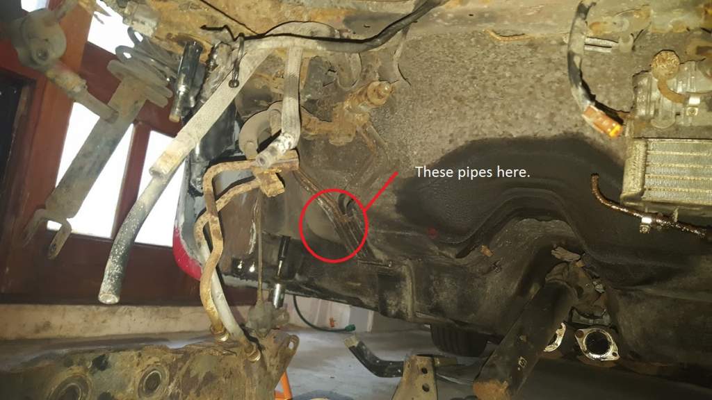

  14. Hope someone can help I'm after the two hicas steel pipes that run under the car body from front to back, also if possible the fuel lines that run with them, they all run together and clip together underneath the passenger side car body

  18. Looking at the pipes the brake line 3/16 is too thin for fuel and return looks like 8mm ish but yes kunifer is also an option
  19. The fuel lines on my zed are corroded and need replacing, ive seen some nylon tubing People have used also stainless pipe There is also one other pipe that goes to the carbon canister i believe behind the front bumper Has anyone replaced theirs im taking about the hard pipesthat run from the fuel tank to the Front of the car
