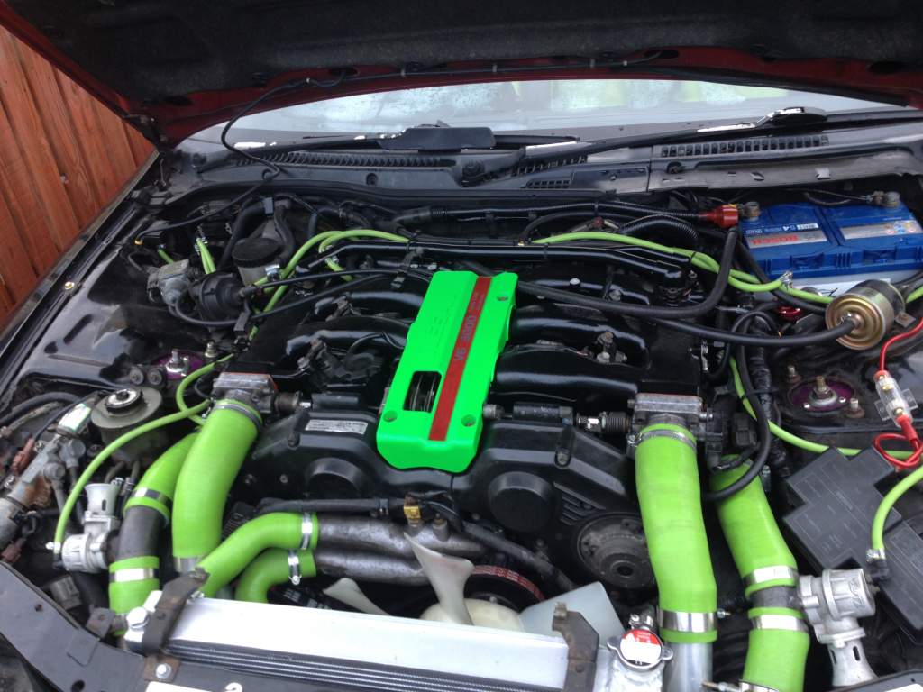

  1. hi guys can you hear your after market dump valve /bov when you just revving the engine I cant hear any thing from my blitz valve just wondered if that's normal also if I rev the engine between 3000-4000 rpm I get pop n bang sound from the driver side exhaust only is that a misfire or sum thing on driver of engine .

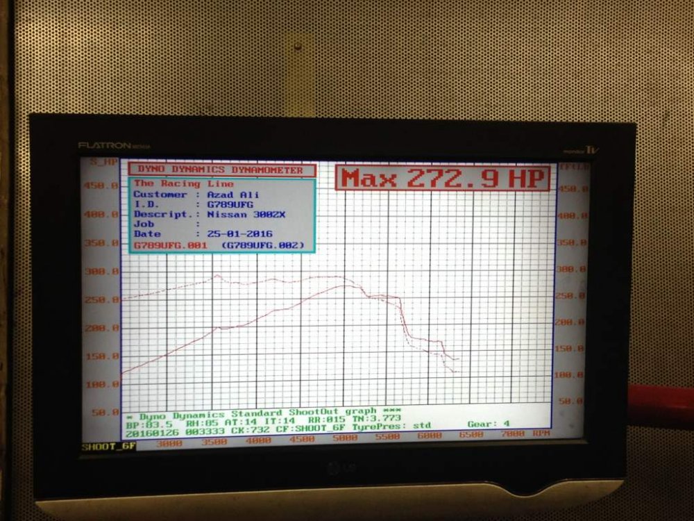

  8. thanks jeff will get the garage to take a look again car went in for fuel pressure regulator n boost control set up after few runs he set the fuel pressure than he did a power run 270bhp with out the boost controller. what do you guys think I should get with my set up zed world chip / 3" straight through exhaust / twin air filter /front mounted intercooler/custom oil cooler/440 injectors/lighter pulley/walbro fuel pump/ hard pipping /vacuum deleted/ uprated paddle clutch/ hks boost control

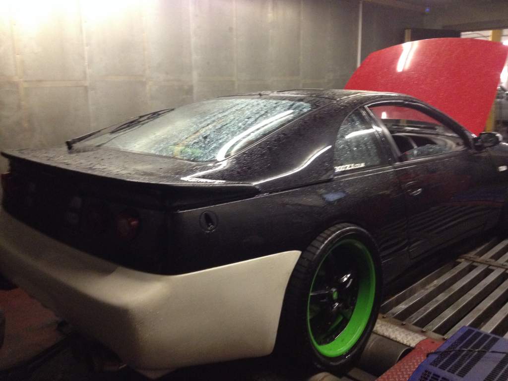

  11. hi does any one now if zed world chip can be read and if so how had my can dyno run today it did do well the tunner said the chip all over the place needs a new remap
