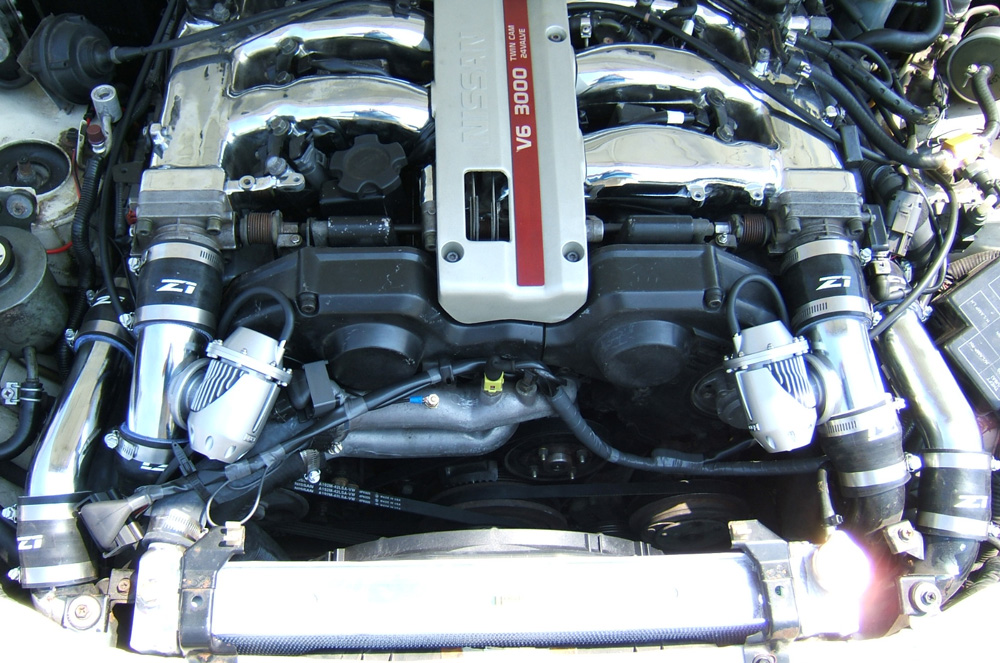

Is it me....... or are they on the wrong pipes?
[ATTACH=CONFIG]94483[/ATTACH]
No, I don't think it's you; your picture is the normal set up. I have seen them in some strange places before though.

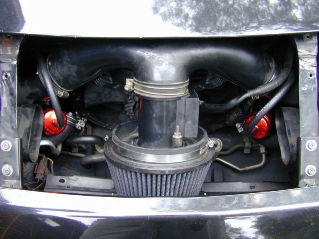

this is phutumsch engine bay pic lets hope he can shed some light on the matter bov 3.jpg
[ATTACH=CONFIG]94485[/ATTACH][ATTACH=CONFIG]94486[/ATTACH]
Hmmmm the plot thickens...... anyone got BOV's fitted and where??
mine are fitted were the stock ones are
My interpretation is that they are just releasing pressure, so as long as you put them between the turbos and the plenum, then you're good.
Yeah it's the same loop, what pipe they are on is immaterial. As long as it's between the turbo outlet and throttle body.

Ideal/ most efficient place is as close to the throttle bodies as possible,
If you think as the throttle closes the pressure is released through the dump valve, if the valve is further down the pipe what direction is the air now flowing? The wrong way lol
If there is one car that should never have BOVs fitted whilst still running the standard MAF and intake pipework setup, it is the 300ZX TT.
