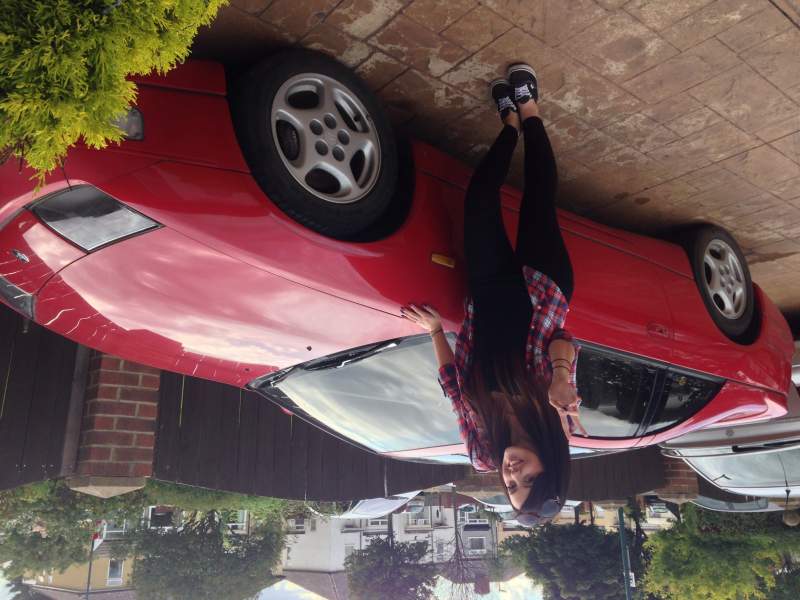

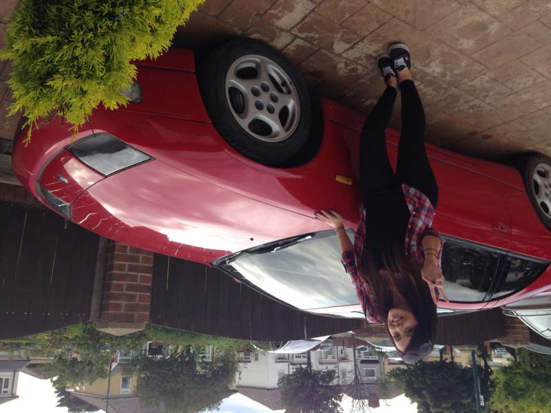

  13. I think so tony could of swore the picture was straight haha still is how do I change it bloody iphone
  14. Well tomomontana I did just that andddddd here is the outcome Lmao so now she owns a 89' twin turbo manual with 64k on the clock and the little salt in the wound it's cleaner than mine hahaha
