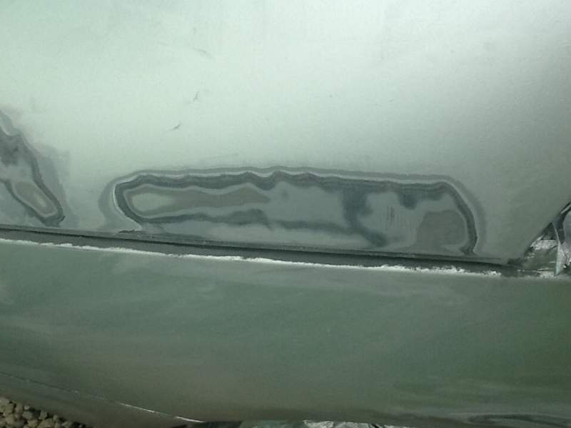

  6. Well so fare the paint takeing well after the problem Iv had using diffrent paint so had too use a isolator this is the 1st and 2nd coat with a 15 min waiting time

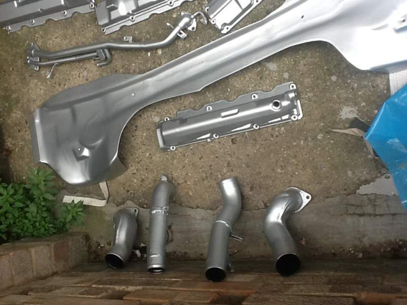

  12. Done the primer and just put the 1st coat of glitter silver on so fare so good no blisters woohoo so let that be and have a coffee then if all good 2nd coat can go on

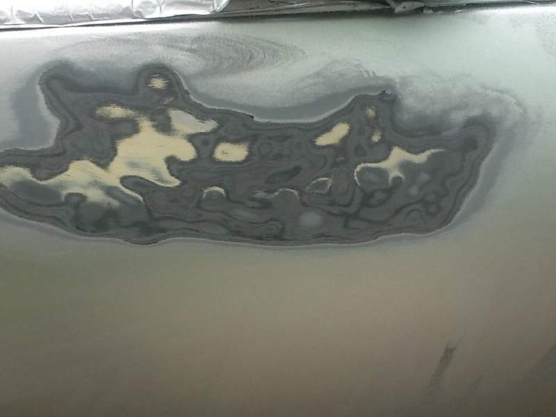

  13. Well all sanded back and isolator on looks good no blisters just got too give it approx 1hr

  19. Had a right pants of a day redid the rockers hard pipes under engine cover in the glitter silver that was fine thought I redo the car in the silver just too refresh it as I'm waiting for the last of my parts and the engine hoist too turn up and fook me this happened not happy so had too order a isolator rerub down use the isolator leave for an hour or so then primer then re silver it then leave it alone
